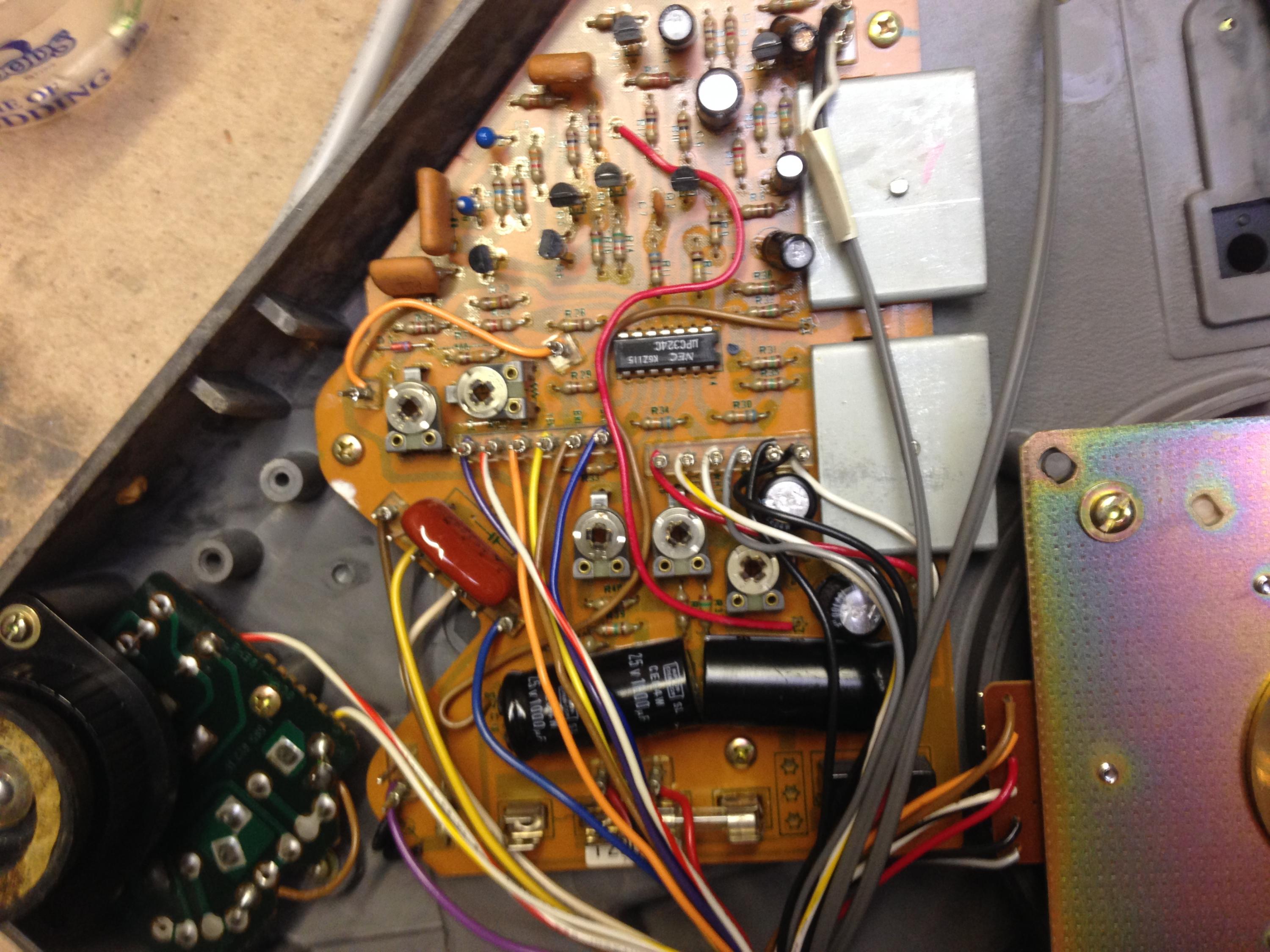

    Hi
    Thanks for letting me join your forum
    I have a Sony PS11 Turntable, the platter would not self start , just give it a nudge and it will run ok , so I thought it might be a Cap problem , so I took out the 3 large Caps n the board, 2x Electrolyte and 1x Polyester !( as in the picture posted) the 2xElectrolyte tested ok, but the 1x Polyester did not !,( tested the same as a Electrolyte Cap ! ).
    I don't seem to be able to find the same type of Cap.
    Is there another type of Cap I can use instead of this one , difficult to get that value and type and pitch ?.
    I have similar one but don't know it value ! .
    Attached pics of pcb and the other Cap I have in stock .
    Cheers
    Spike
    • 31087
    Re: Sony PS11 Turntable Cap id
    33nF 300v polypropylene looks like x2 rated
    1800nf 250v polypropylene
    ^ 1.8uF
