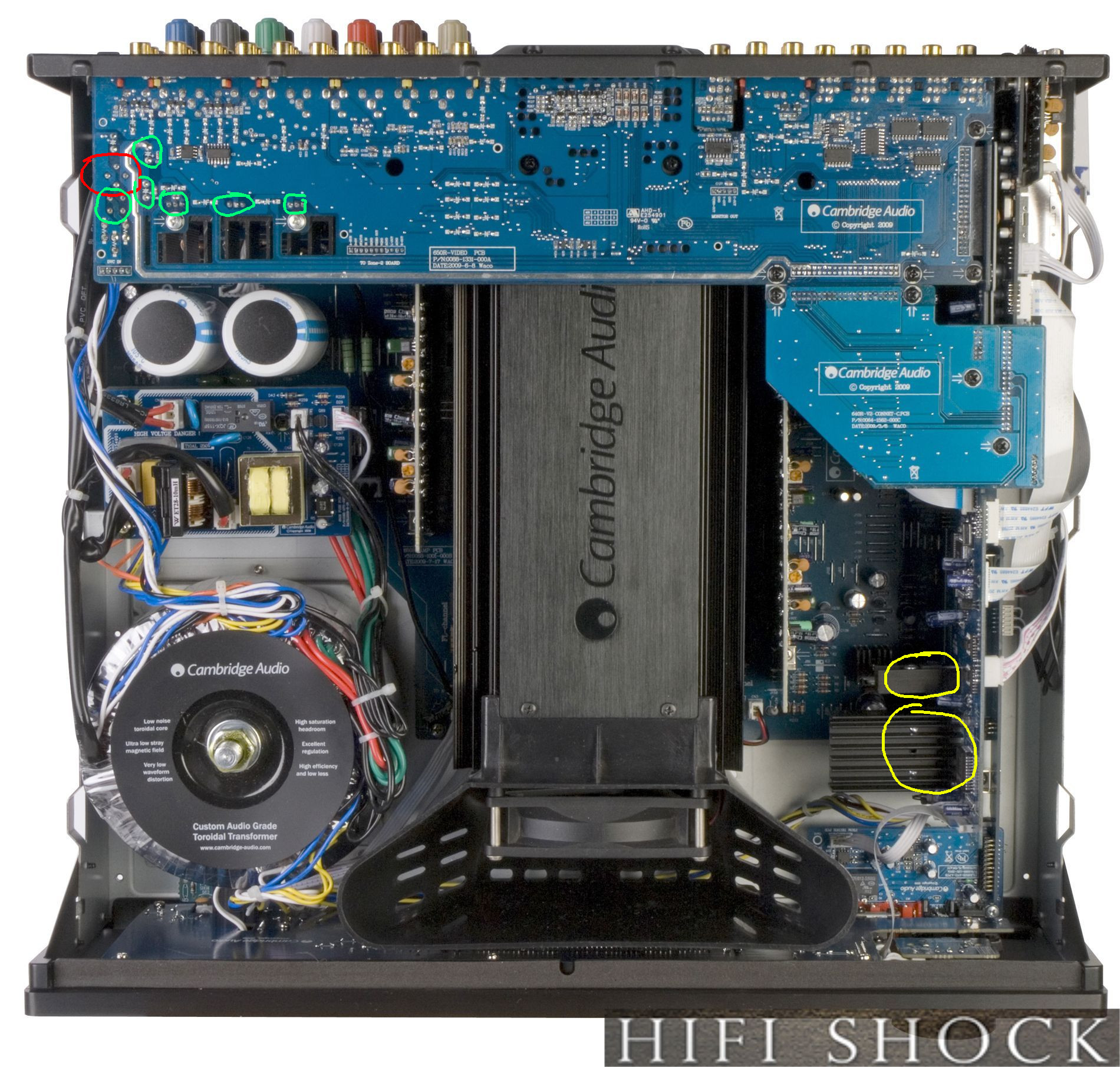

      This model sometimes drops audio completely until power cycled.

        Re: Service manual for CA azure 650r
        Originally posted by Sojke
        Have you managed to fix yours? Mine just looses audio all of a sudden in the first 10 minutes of operation. Some time it first deforms the audio and makes it noisy seconds before loosing it completely.
        When turned off and on again it regains audio.
        Sounds like an preamplify and earlier stage problem but I couldn“t identify it. The only strange thing I saw is that the selector is working at +6.7V and -6.7V instead of 7.5 .
        Hello there, yes, I fixed mine unit.
        The problem was bad solder joints on the bridge rectifier circled in red on the image bellow.
        After I resoldered it, the unit started to work fine.
        I also had bad path which needed some attention ( one of those going to the connector under the "Cambridge Audio" stamp on the video board ).
        The circled in green solder joints on my unit also were not in good shape.
        So, for start I would suggest that you inspect the same things on your unit + the circled in yellow ( those are again voltage regulators which tend to run very hot 70+C* ). Also you might want to check the capacitors of all regulators ( several on the top/video board and few more on the side board/ yellow circles ).
