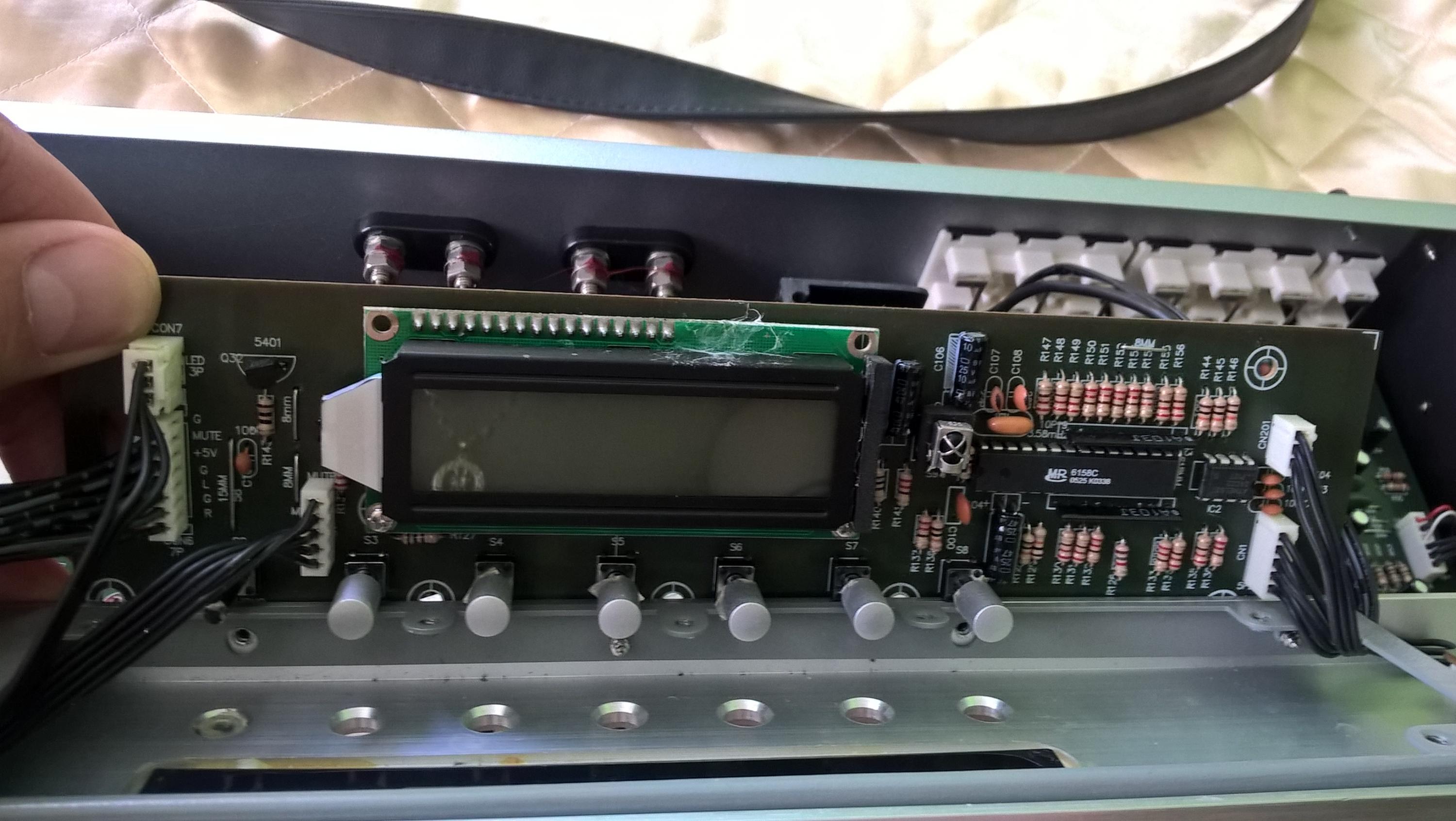

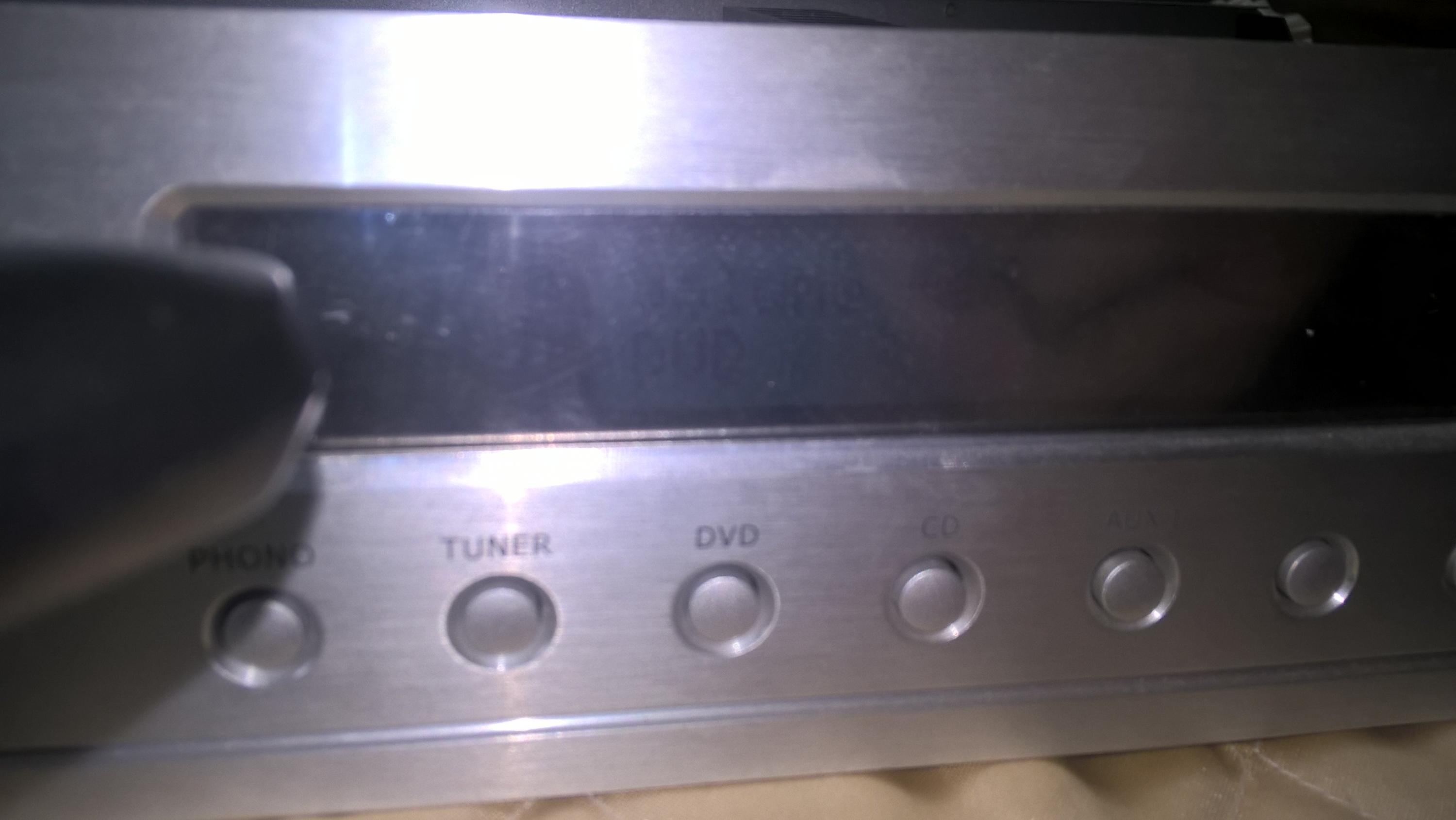

Hi. I have AMP-50 which work perfect put there is no light on display. There is three regulators for voltage 7805, 7808,7908. On 7805 i have 7.1, on 7808 i have 11.71v, on 7908 i have -12.04v . I see on the display everything but not light. Any suggestion?

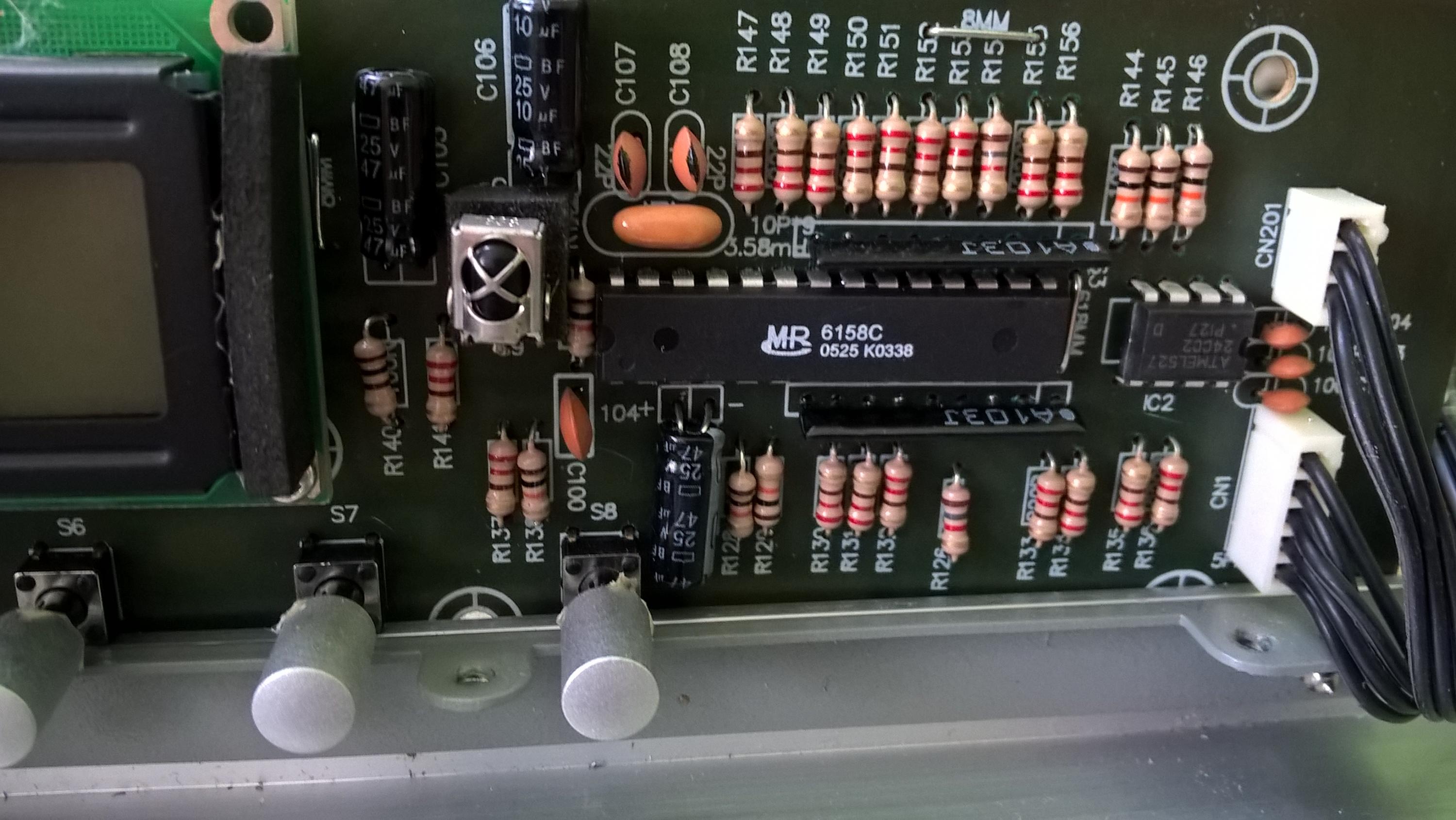

Also, please upload some photos of the amplifier, especially the circuitry around the display section!"Tantalum for the brave, Solid Aluminium for the wise, Wet Electrolytic for the adventurous"

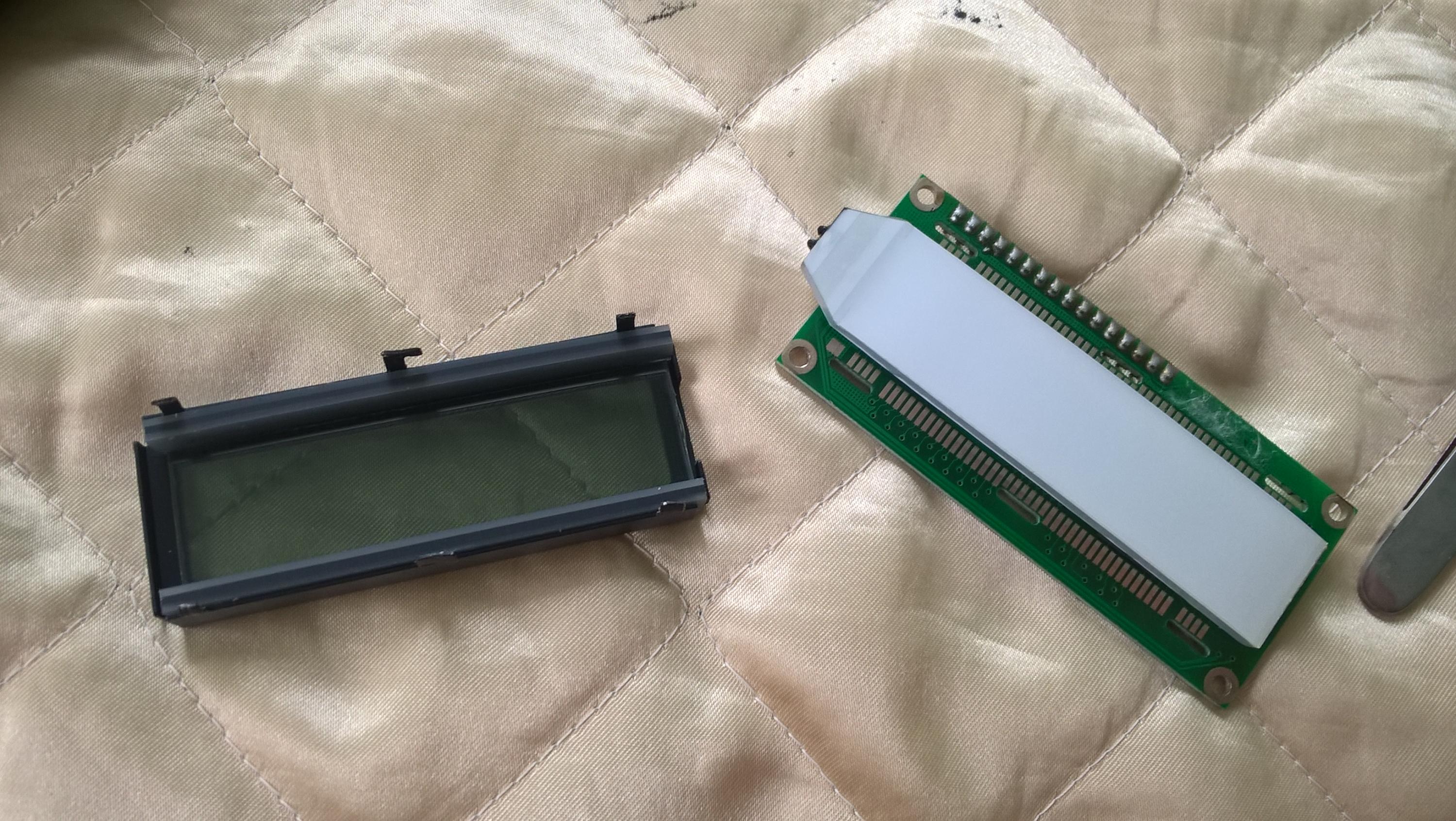

I found this link http://www.ziva-vatra.com/index.php?...d=SGFyZHdhcmU=
It looks like it is an lcd with the light source from the side, I suspect its one of those sheets that light up behind the displayLast edited by R_J; 08-15-2017, 10:15 PM.Comment

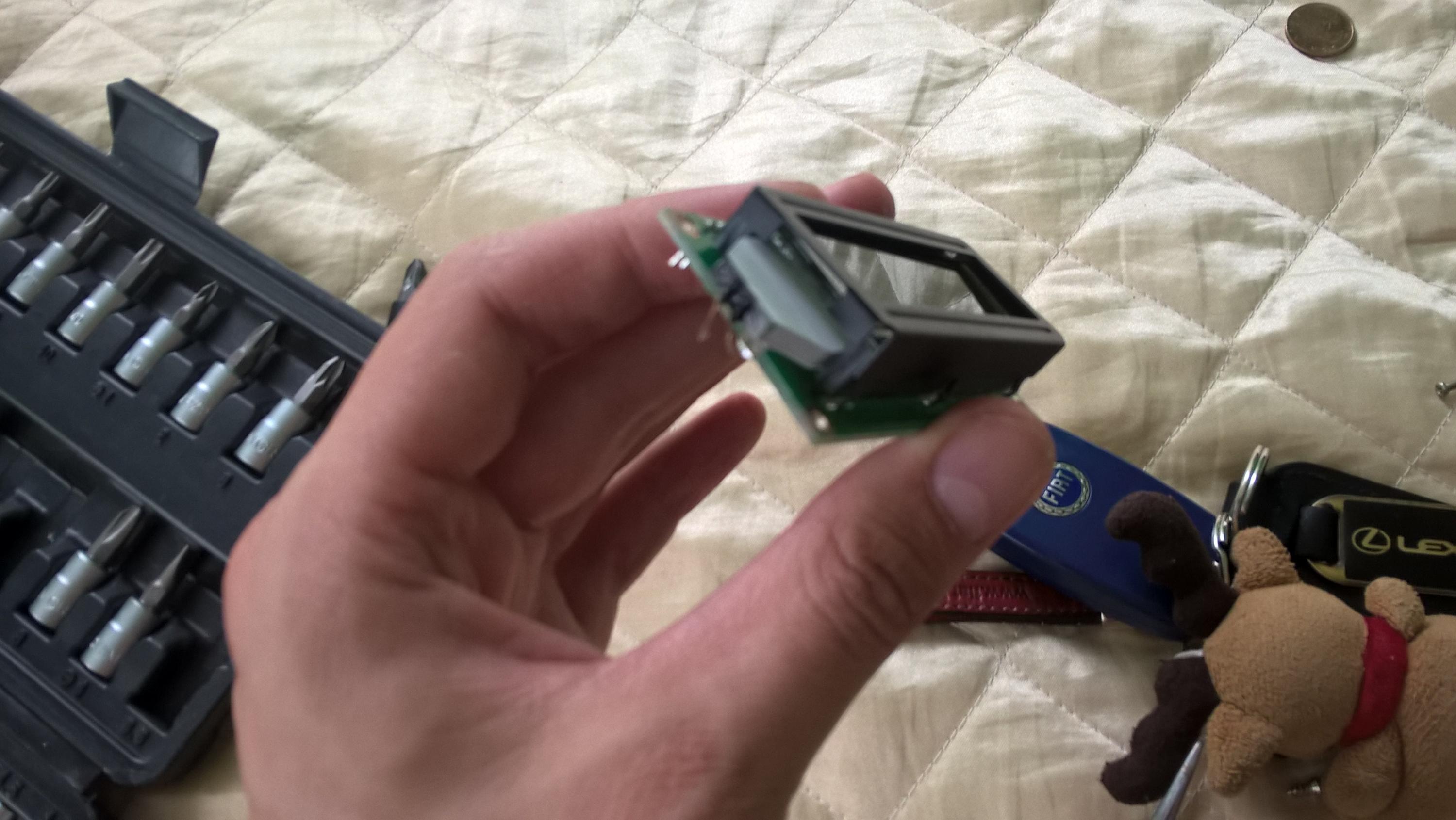

pull the display assembly out and show foto's
i know the pdf says "VFD", but it's clearly not - it's a self-contained display module with it's own driver circuits in it.
infact looking at the schematic i wouldnt be surprised if it's an LCD with a Hitachi parallel interface.Comment

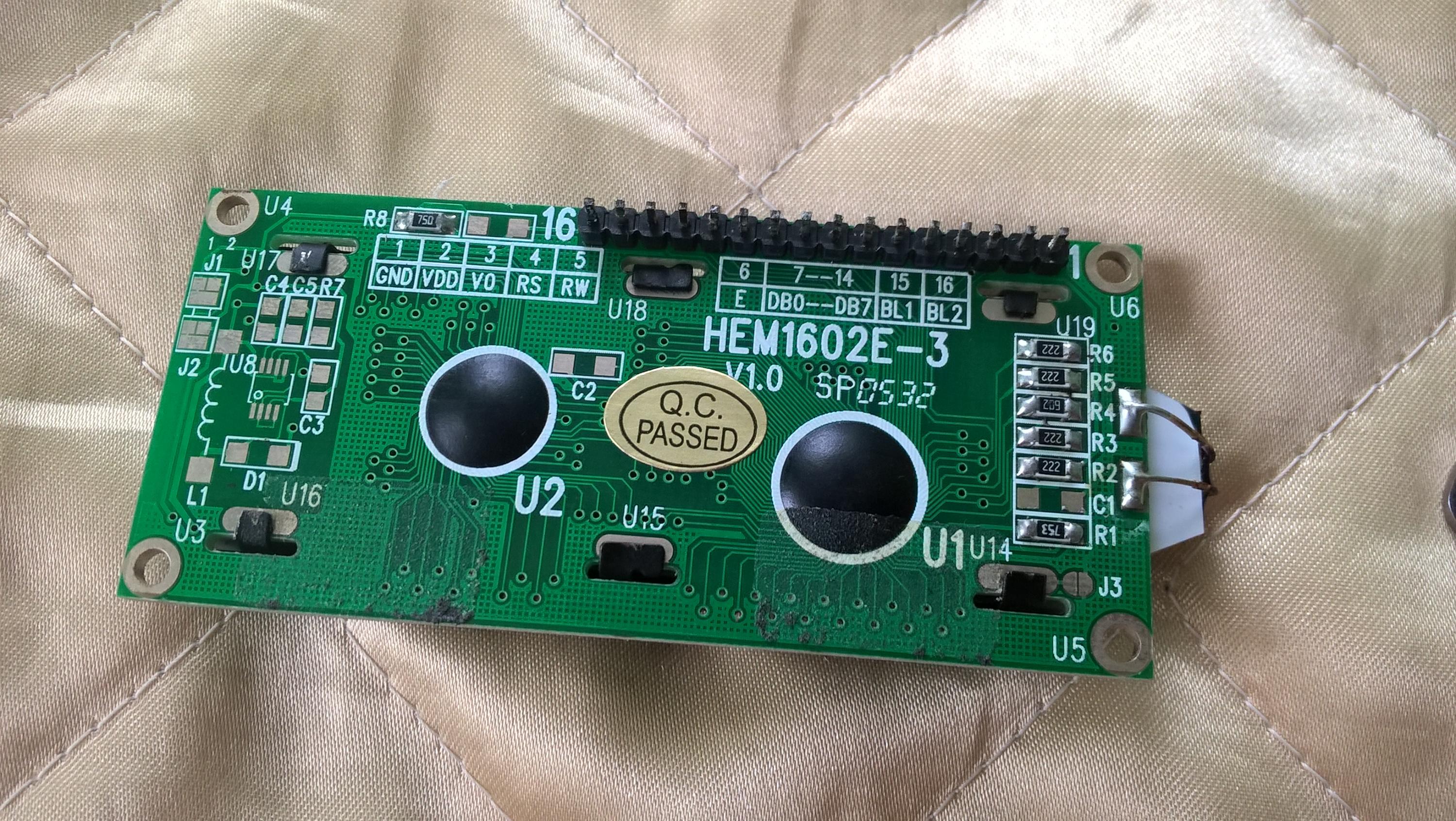

This is my display. I thing this is perfect to replace. But i don't know where is the problem..., on backlight or some circuit https://www.aliexpress.com/item/1602...2-515552f21762Last edited by coojoe_213; 08-16-2017, 06:47 AM.Comment

Did you check to see if there is any voltage to the backlight terminals in the display, thats the 2 leads going to the white piece. I don't know what the source of light is, I suspect it is one or two white led
I know the link I posted had a different problem, I posted the link because it had pictures of the display and showed the white backlight on the side.Last edited by R_J; 08-16-2017, 07:43 AM.Comment
