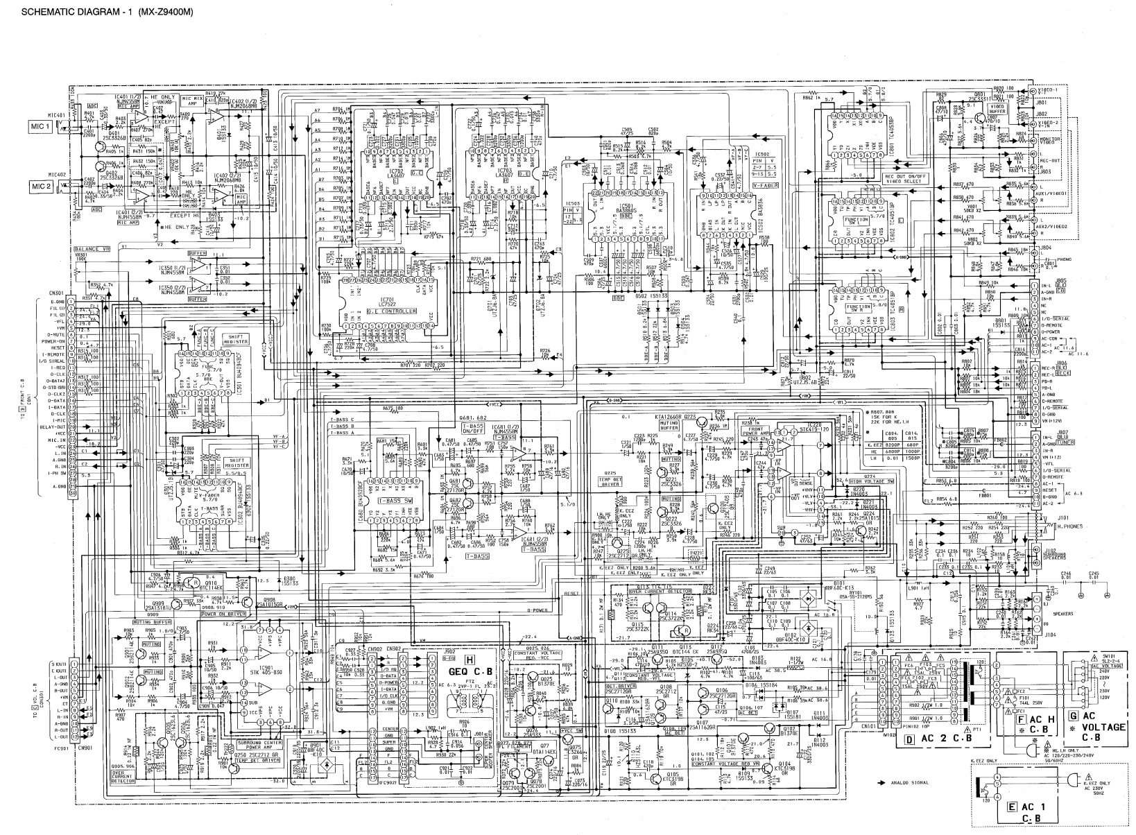

      Both capacitors are 47 mfd. I replaced the C16 capacitor instead of a 33 mfd capacitor,because i didn't have a similar one, with a 44mfd capacitor.

        Well this is an interesting circuit in any case. I've never seen a doubler hooked up like this, so the question is whether the designer just needed a quick and ugly 70 volts, or whether there is another reason for using this weird configuration using 2 electrolytics in series.
        Our typical supply for the VFD isn't regulated either, like the one shown here. It seems like there must be another reason for part failure every few years. One or both diodes in the circuit being faulty might stress the caps...? Another strange thing is that the 2 caps are different values, but not that different. Well, I give the originality award to whomever was behind it. You know how the EE programs say that practical experience can be left to on-the-job training.
        It would be fun to look at some waveforms at various points in this circuit. The latest post also might hold some clues to the real culprit, since replacing the 2 series caps did not solve his problem.

                I just checked a mx-z9300 schematic and the two caps used in that model are: C15, 47uf/25v & C16 100uf/25v. they also changed C17 from 47uf/63v to 47uf/100v

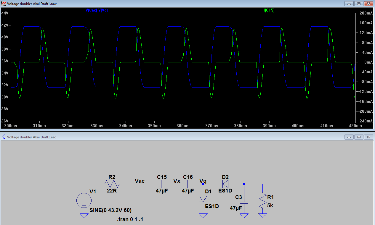

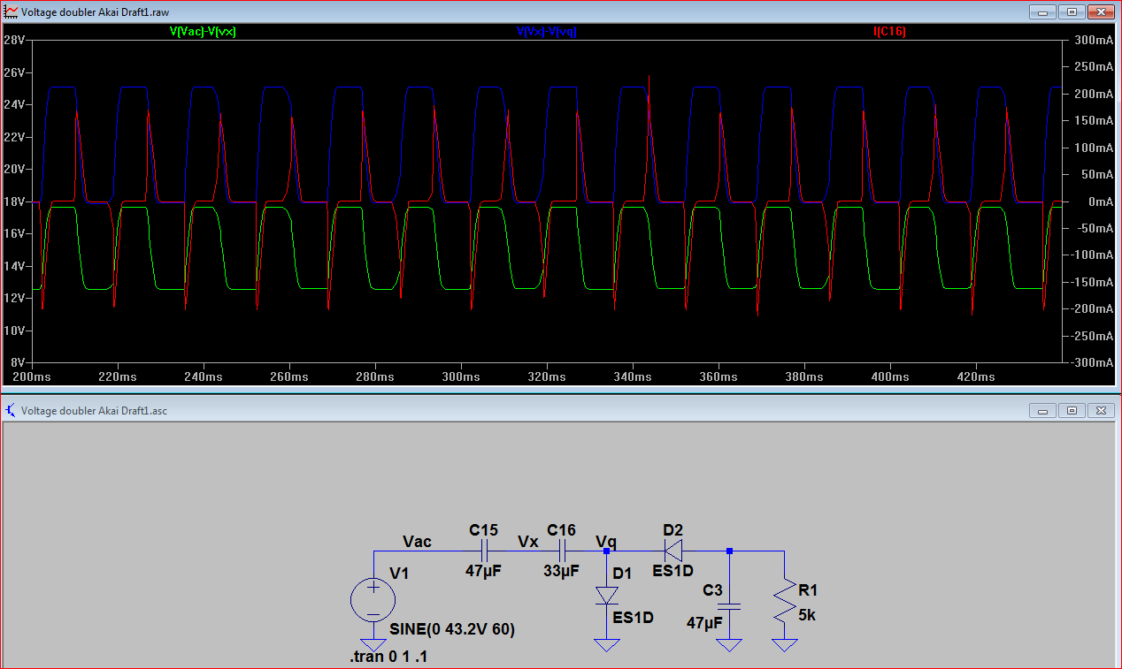

                  I did a LT SPice run, to confirm the voices in my head.
                  It's a lop-sided voltage doubler. No need for a bi-polar part as the capacitors are not supposed to fully discharge between cycles.
                  The problem is the ripple current is very high ~220mA peak which is too much for most vanilla electrolytics this size.
                  Although you need ~20uF part, Akai used the two larger 33uF and 47uF parts in series, as larger value caps can take more ripple current. I could not find a 22uF 50V rated to >220mA 60Hz ripple anywhere.
                  Adding a 22R 1W series resistor lowers ripple to 140mA.
                  I'd use two Panasonic EEU series, 47uF 50V rated 240mA 60Hz ripple and put a 22R 1W resistor in series with C15/C16.
                  I used ESR 0.7 ohms for 47uF and 1.5 ohms for the 33uF in the simulation. Lower ESR makes ripple current worse.

                        It's not their rated voltage, it's not their capacitance value, it's not them being polarized, it's not a PCB size problem.
                        Like I said, the problem is high ripple-current killing the capacitors.
                        I would say that identifies the issue that has people puzzled and guessing as to why the caps don't last. It also explains why 33uF+47uF was used, for those who understand.
