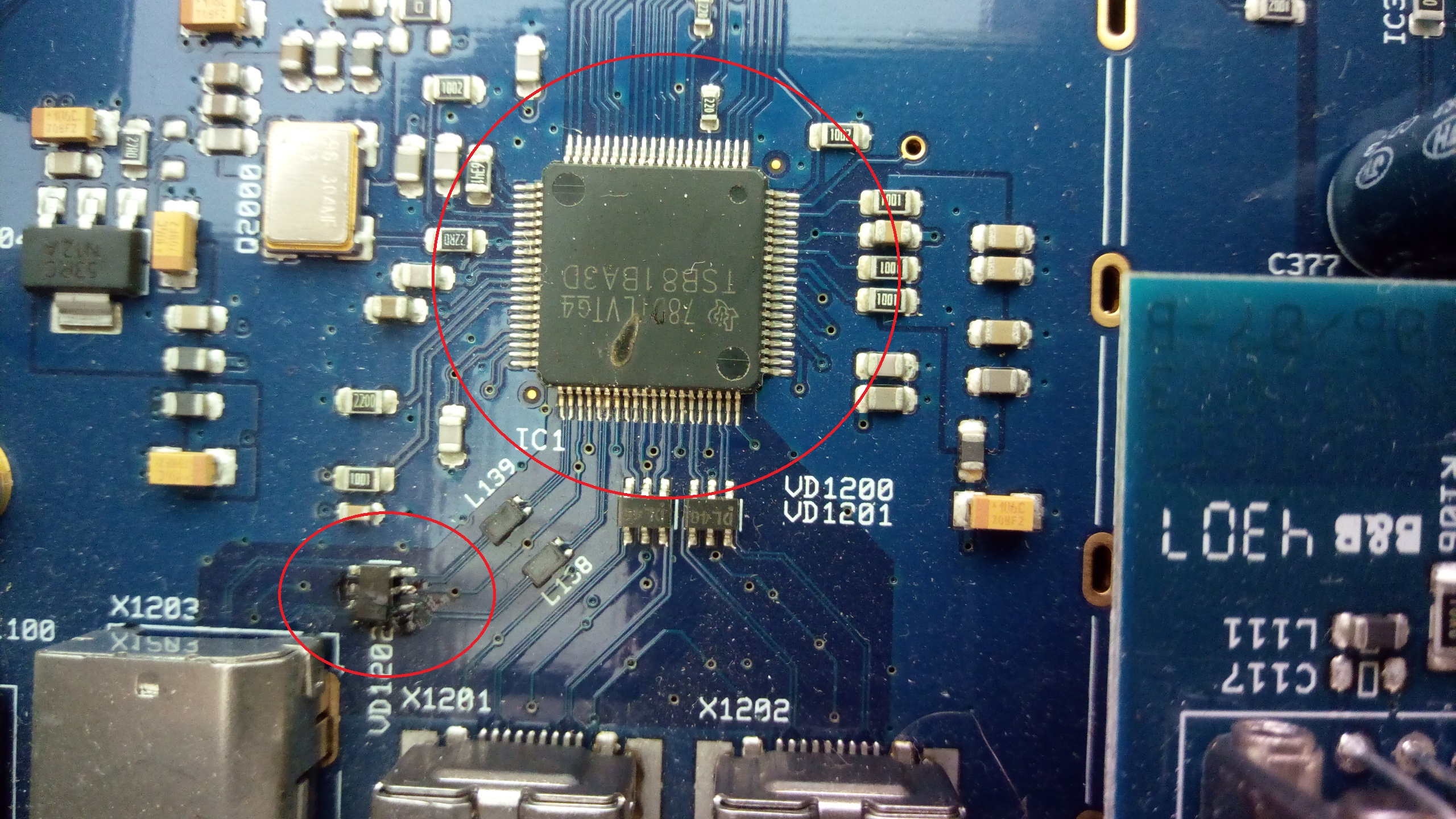

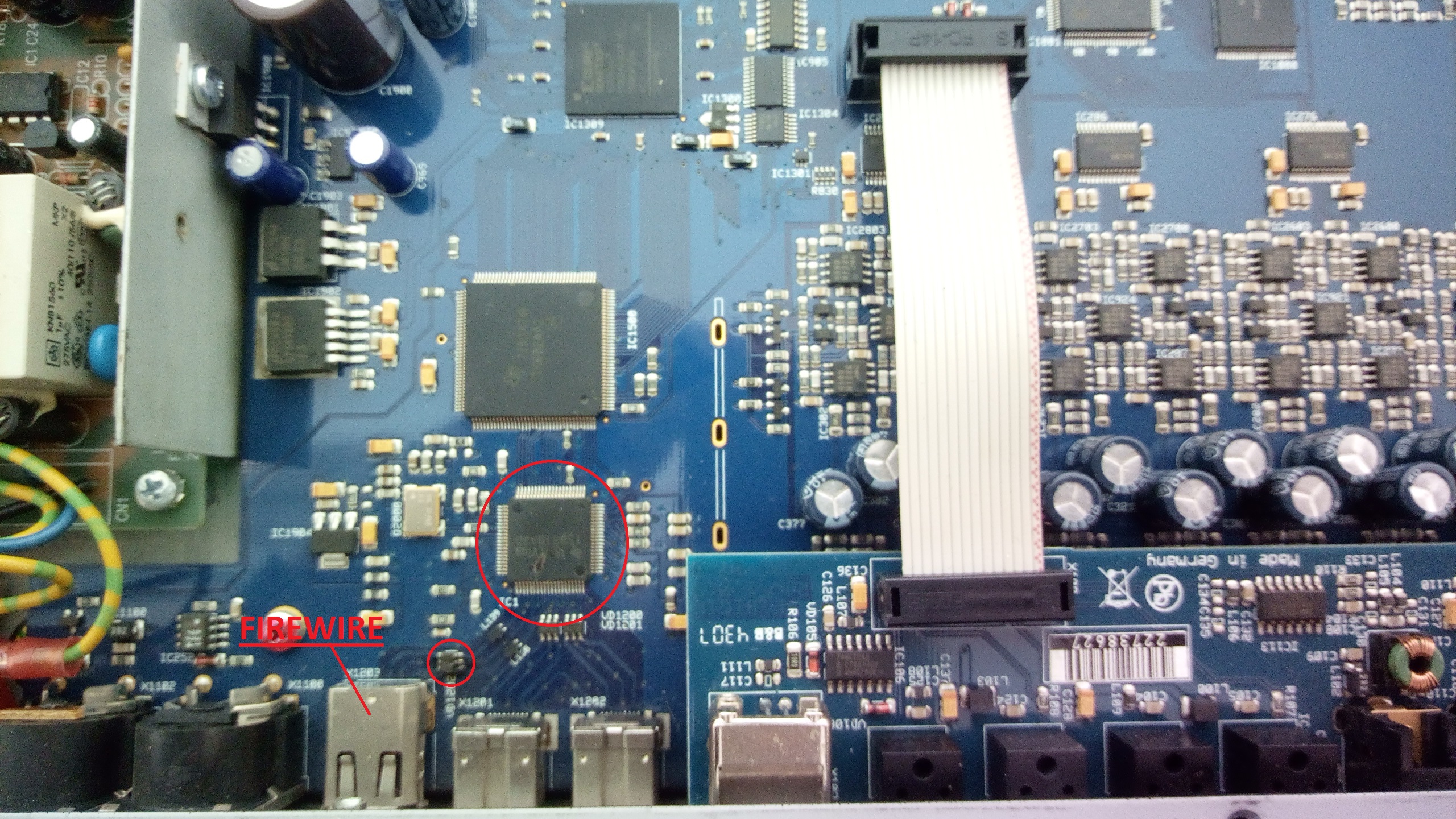

      I have burned IC and smd !
      IC1 and VD1202
        Re: What op amps in side the RME firefaces models?
        Photos of the affected areas (in focus and, if possible, with no or minimal flash glare)?
        Khron's Cave - Electronics - Audio - Teardowns - Mods - Repairs - Projects - Music - Rants - Shenanigans
          I need the VD1202...
          Attached photos.
            Well, the big chip has its type number in big fat markings on the top there - TSB81BA3.
            The smaller chip looks like some TVS array (Transient Voltage Suppressor). The "DL46" markings on the other two are probably the same as the toast one, and indicate it to be either an HDMIULC6-4SC6 or DVIULC6-4SC6, from ST Microelectronics.
