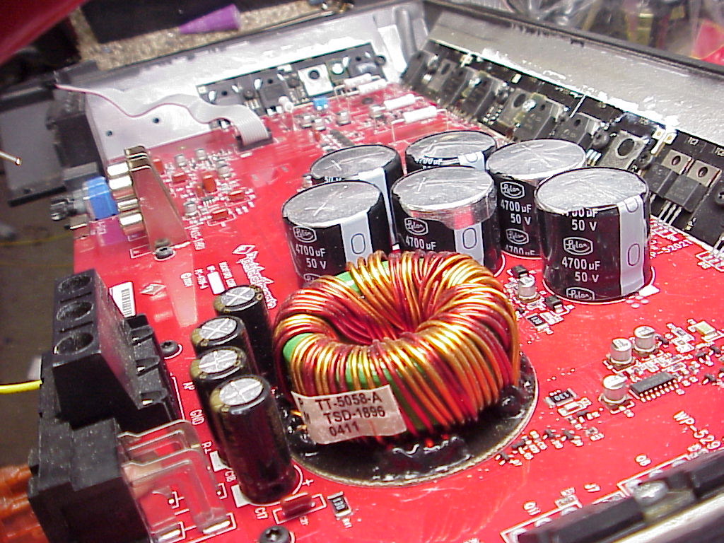

lelon crapcaps in rockford fosgate amp
  • kc8adu
    • Nov 2003
    • 8832
    • U.S.A!

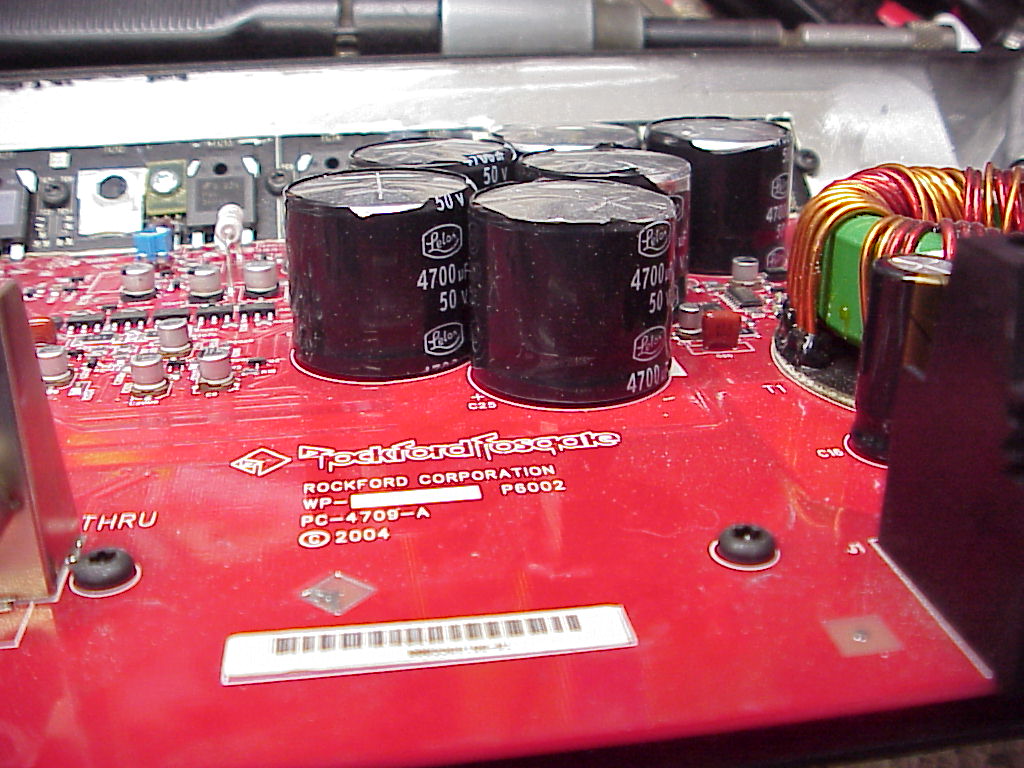

    plastic removed to show bulging
  • japlytic
    • Oct 2005
    • 2086
    Re: lelon crapcaps in rockford fosgate amp
    What is the series of the Lelon 4700uF 50V units?
    If not marked, what is the diameter and height of them?
    Also, what is the brand and series of the four smaller black and gold capacitors near the large coil?
    I may be able to cross-reference them with better quality replacements.
      already replaced with elna audio grade caps i had on hand.
      the input caps got 1800@16 mcz
      no more hissing and whining.
      the inputs were open causing alternator whine.
      the psu filters were reading 4 ohms esr each.might as well have been open.
