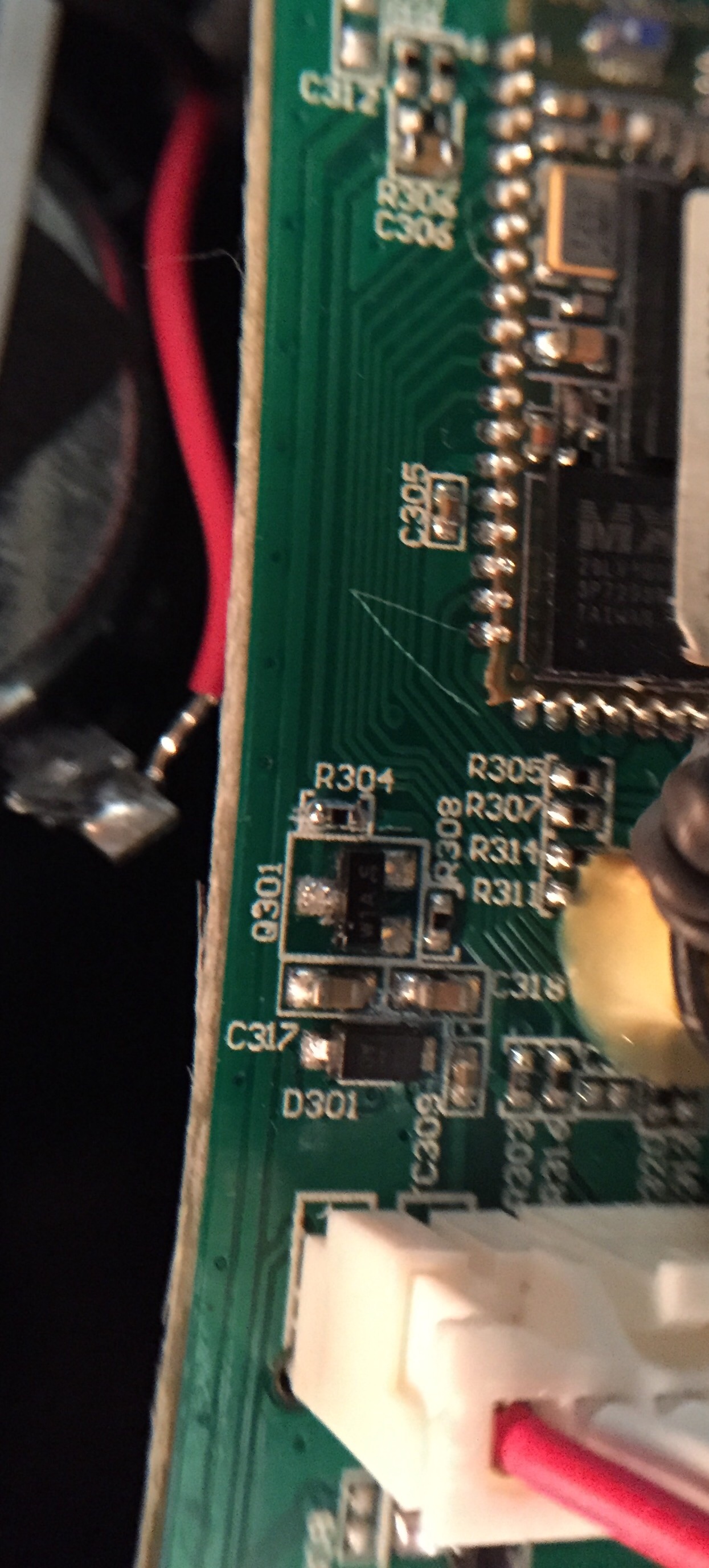

    Update:
    Replaced ic charger and the diode and instant 3.20v on output of the ic charger and at battery. Kept measuring and voltage was slowly increasing
    That ic was the hardest thing I've ever replaced! Used hot air but still wasn't easy had to apply kapton tape around the near by plastic connectors. Took me a bit but finally got it.
    I want to thank you guys tremendously for your help/input. Learned a lot on this one!

                    Ok I measured the battery and it has 4.2v on it. So is there something wrong with whatever tells the power led the battery is full?
                    I wonder if it has anything to do with the original problem and the smd cap I replaced because the "power led" line I traced back to c309 which the other end connects to c318 which connects to c317 which goes to the base of q301
                    Or that could just be for power on led not charge flash. Not sure what to look for next in terms of this
                    I also noticed power buttonA has 4.1v and power buttonB has 0v even when powered on but in original fault the voltage to B would go high after pressing A. Not sure if related or has any meaning to current issue?

                      Scratch that about c309 I was accidentally tracing the grounds to those other components.
