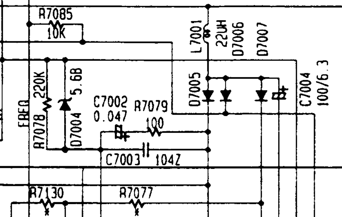

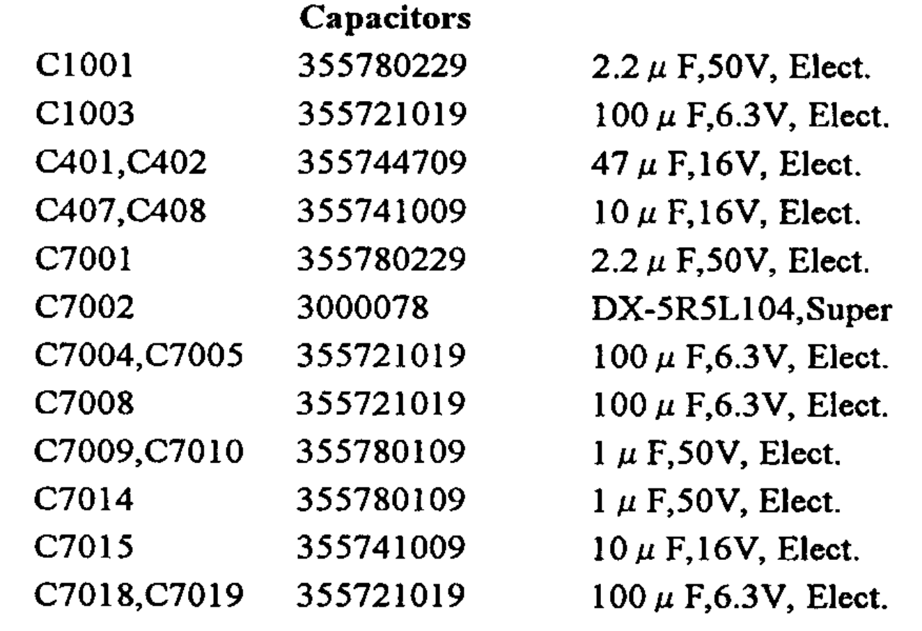

                  In usage, the settings don't last long without being in standby. I was thinking the super capacitor should be replaced. The schematic and parts lists seems to differ in capacity. it seems like the higher the farads the longer the settings will be retained. R7079 should limit the charge current?

                  The C7002 part number is for a 0.1F but the schematic shows 0.047F. I'm inclined to get the 0.1F. Is this the right part to use?
                    #29
                    Yes, C7002 is an Elna super-cap DX-5R5L104 0.1F 5.5V and upsizing it is OK. The schematic shows it as 0.047F so they already did it.
                      #30
                      I put in a new super cap and the settings now save for much longer, lasted overnight.
