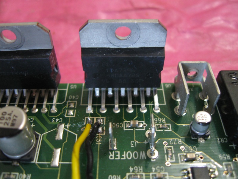

    After much diagnostics, narrowed down the problem (of no bass) down to this TDA7396 I.C. Already tried feeding the audio directly (bypassing the preamps, via single ended config according to datasheet) into this I.C but still to no avail. Also noticed the CD-DIA pin is pulled low which means there is a problem already. Certainly due for replacement.
    Now the weird part is, when I accidentally touched a floating output source to one of the input pins then the woofer started to hum loudly! But that's it, just humming but no music. Noticed the woofer goes into incursions but no excursions. My guess is one of the positive/push side drivers is internally toasted..
    Is anyone here familiar with this I.C? Would like to know the normal/usual voltage at the MUTE pin.

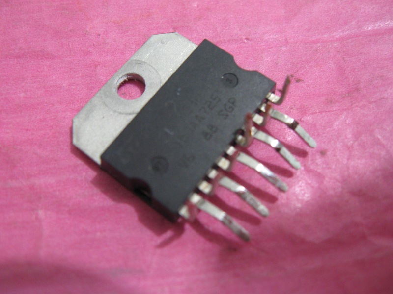

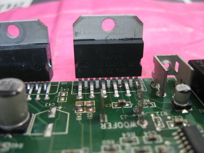

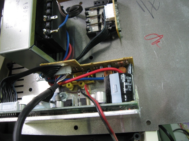

          Roger that. Already suspected when finding quite a voltage on those output pins (when should have been almost nothing). The CD-DIA pin did gave me a quick early answer (before looking into other possibilities). By the way, very much confirm it was that I.C faulty. Replaced with new I.C and now its fully working...
          Here are some pictures. #1. the internals, #2. that faulty I.C (can see the wires I've used for diagnostics as well), #3. faulty I.C pulled out, #4. new I.C in place...
