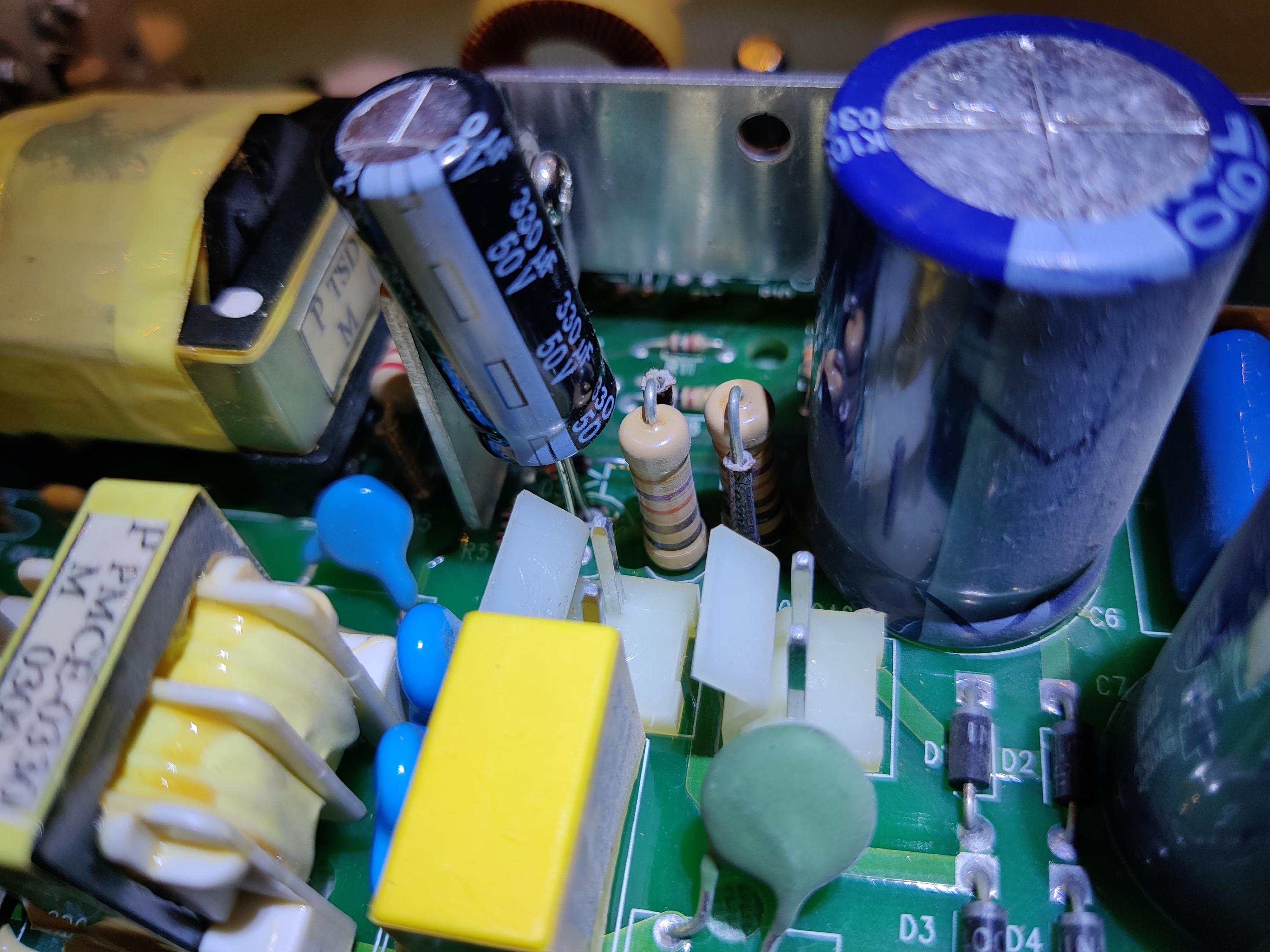

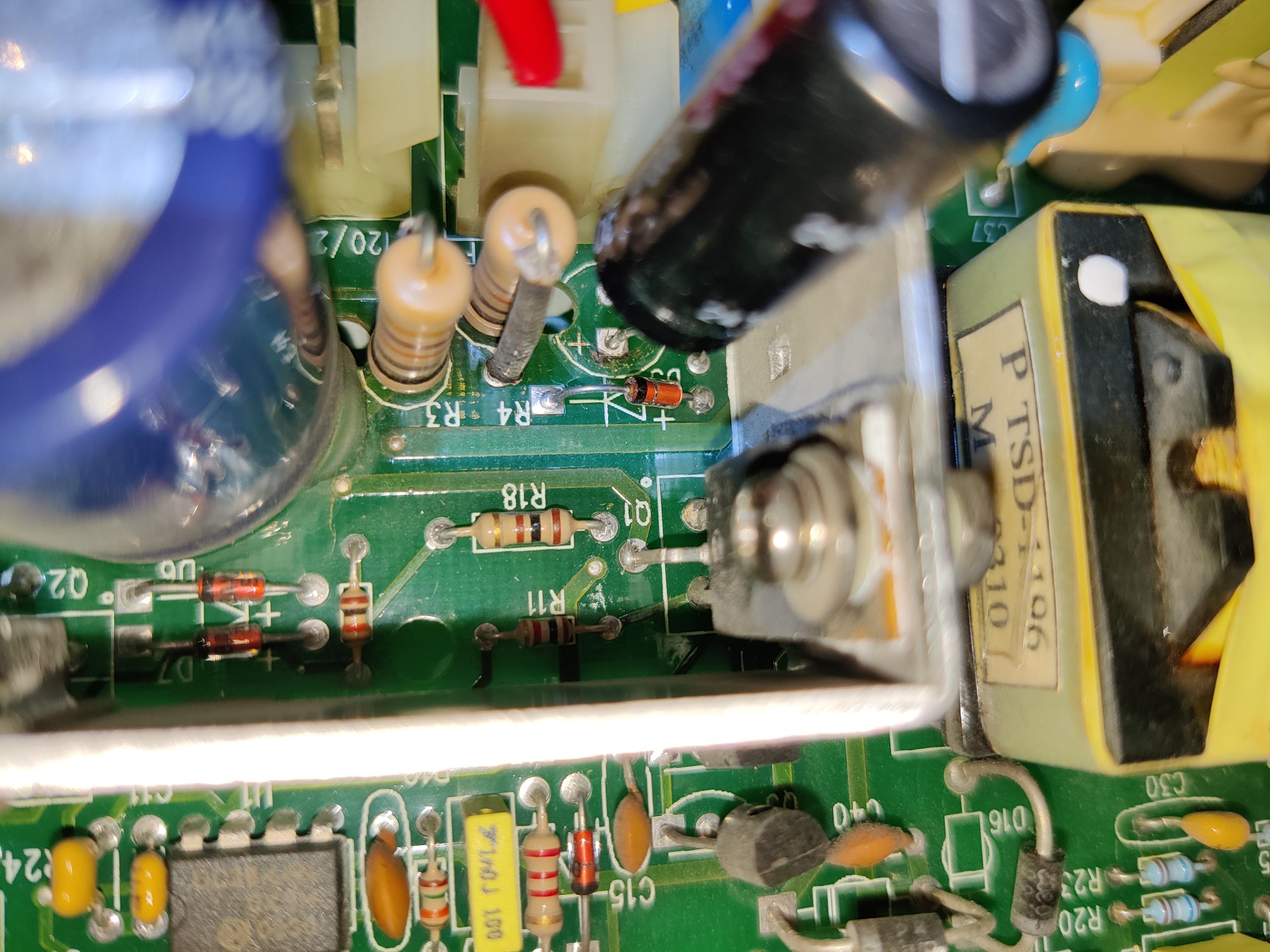

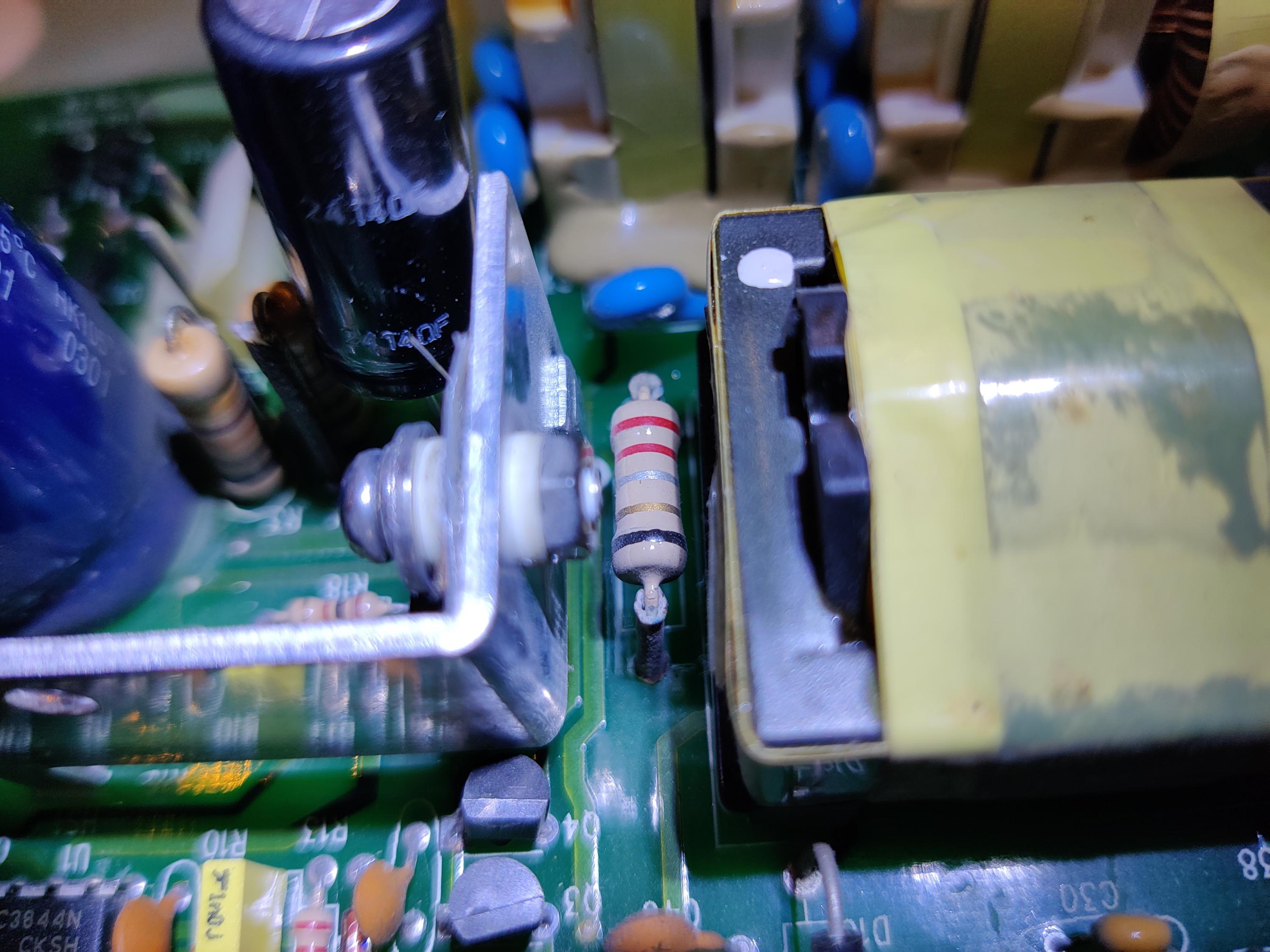

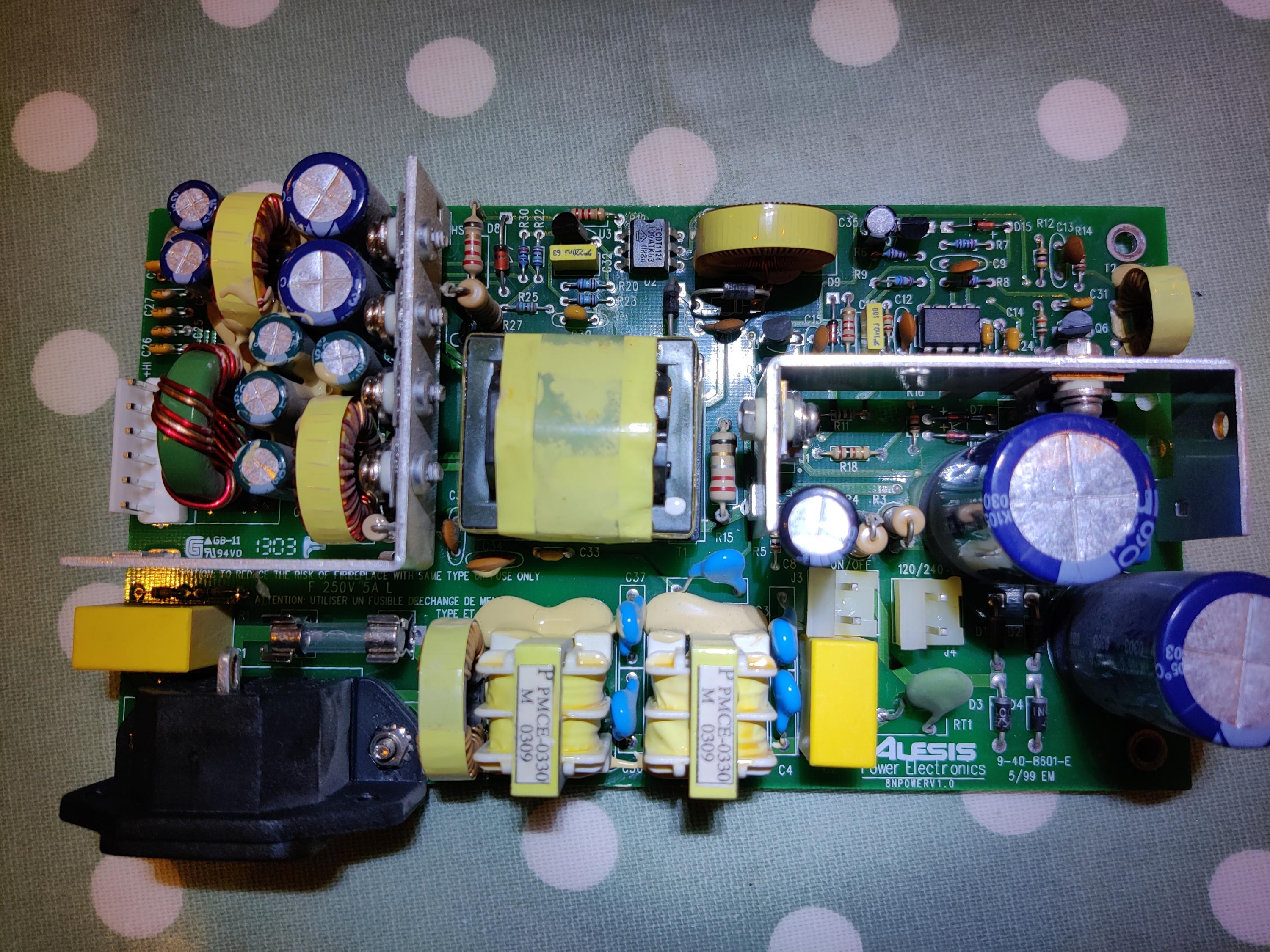

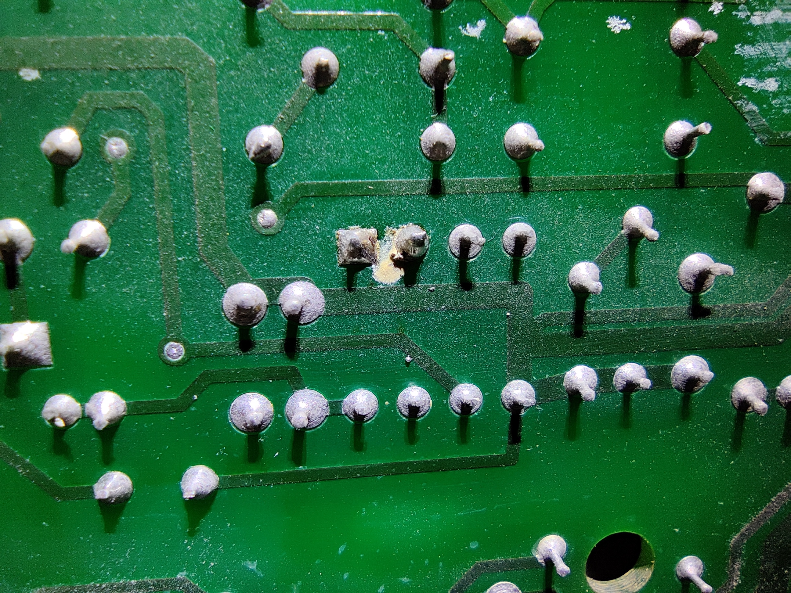

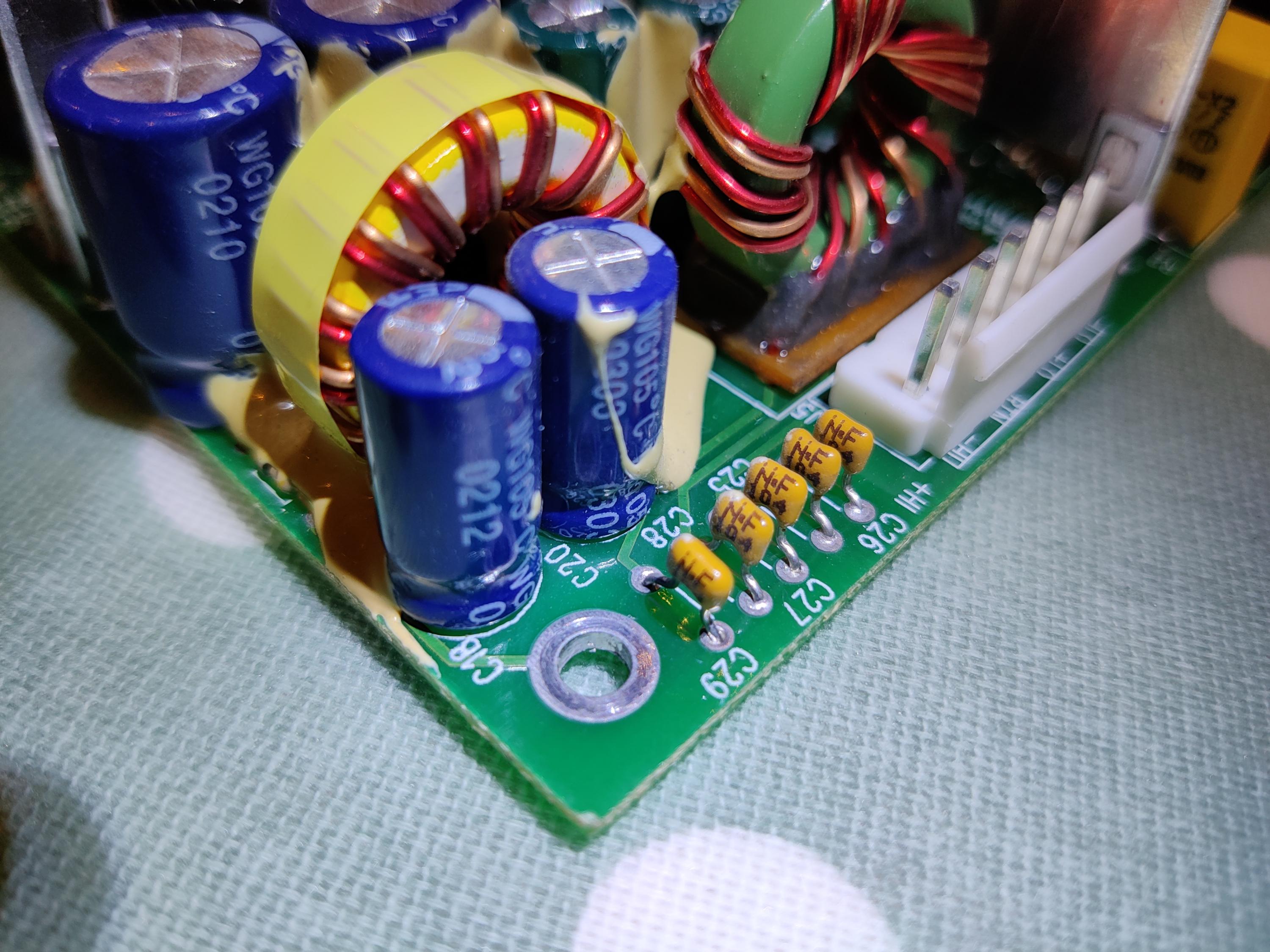

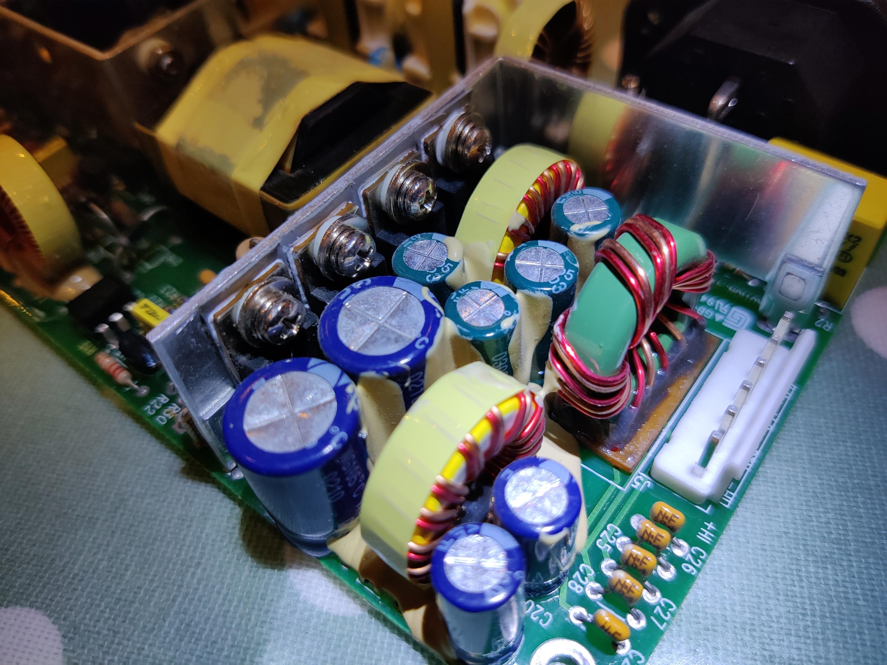

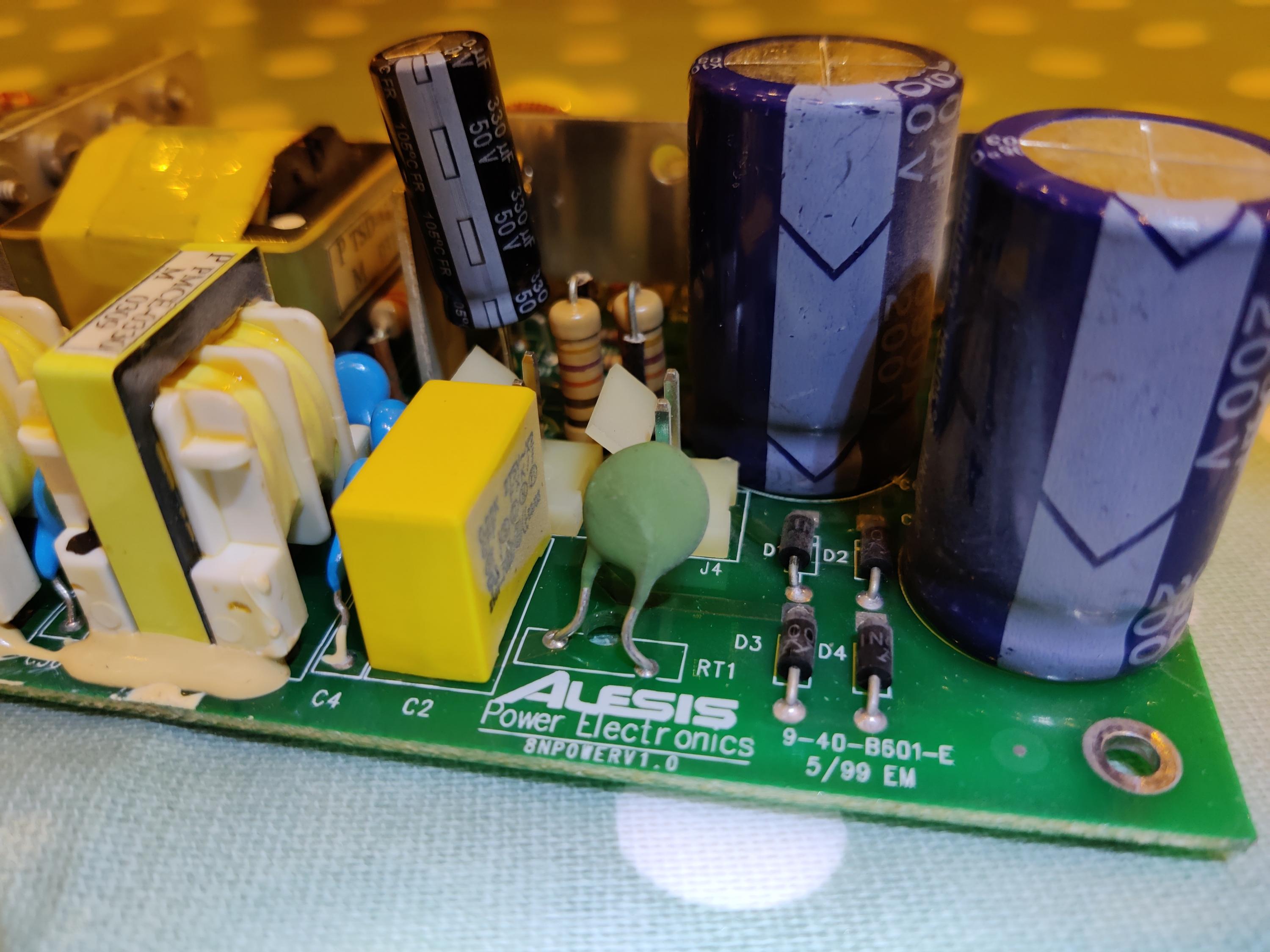

            Re: Repairing Alesis M1 Active mk2 Monitor Speakers
            Sorry for the delay - I didn't have much time today but I've managed to take some photos of the components on the board in the hope that might give you some clues at to what the issue might be. The only thing I've noticed on the rear of the board is a little corrosion (?) between pins 1 & 2 of the UC3844N. That's the close up picture of the rear of the board attached. Might that be causing a short or be an indication of the IC having sustained damage/worn out?
            I'm aiming to test the voltages across those secondary caps and, if needed, the primary ones momaka mentioned tomorrow, but let me know if you spot anything else on the pictures or need any others of specific areas of the board?
            Oh, one other thing I keep forgetting to mention - my "good" speaker was the one I was originally more concerned about as it had been taking longer and longer to come on after I flicked the power switch. It now takes around 90 seconds to power up and for the blue led to come on. As they were bought as a pair I assume any age related degradation of components might be similar across both speakers, but does that sound like a capacitor on it's way out which might need replacing? Or might something else cause that long wait to power up after the switch is thrown? I've not yet touched that one since the other one stopped working but thought I should mention it in case it offers insight into the issue with the other one.
            Thanks, Joe

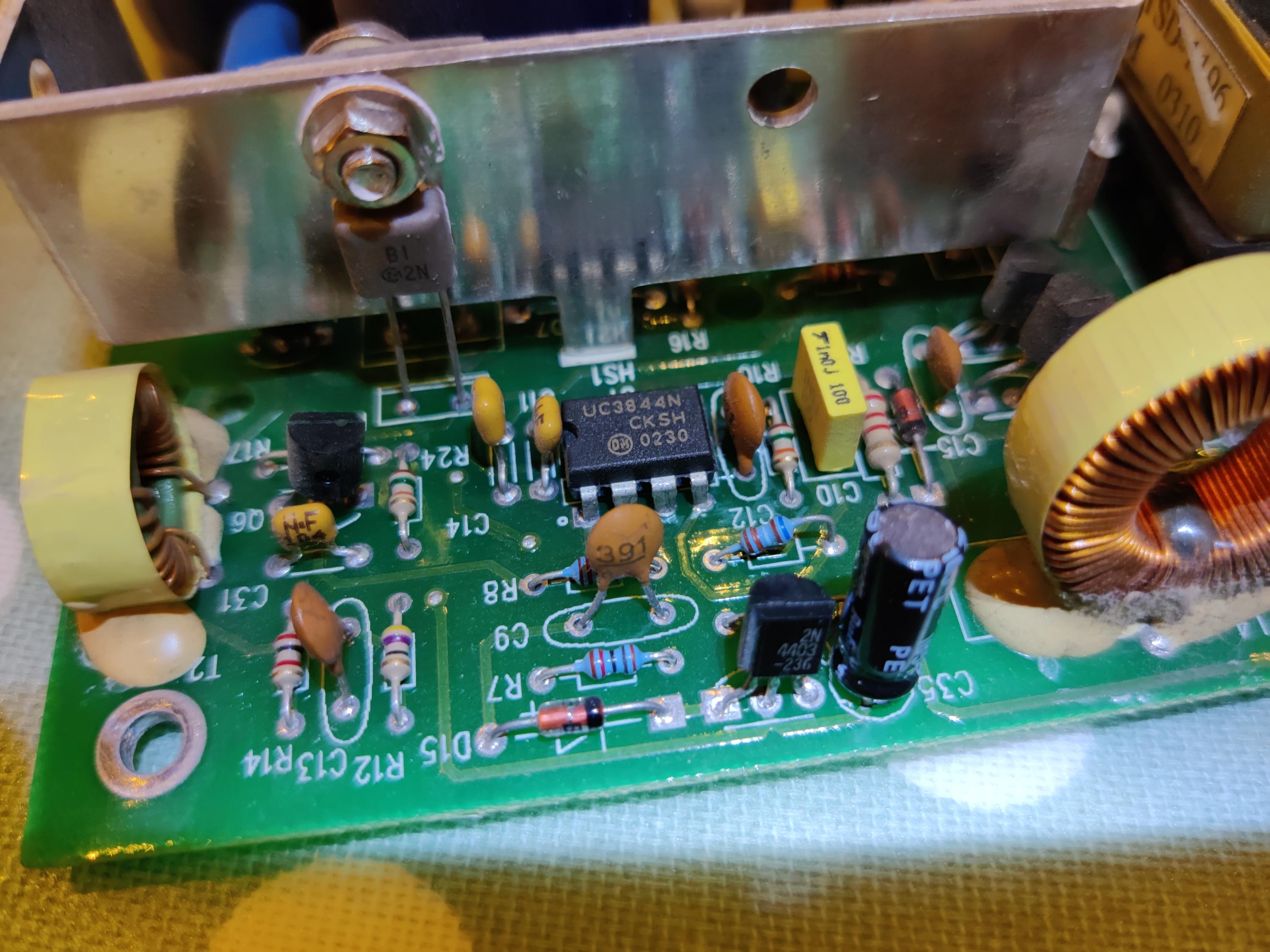

              Looks like leftover flux from the factory soldering... but then it's also odd that this would be the only spot to have it while the rest of the board looks pretty clean.
              Try cleaning it with some IPA and see if that changes anything. Probably not, but you never know.
              R27 (100 Ohms) on the secondary side looks like it ran a bit hot. Probably OK, but check it anyways.
              R3 and R4 (both 47 KOhms) also look like they ran hot before. Worth checking those too. But again, make sure the primary caps are discharged (less than 1-2V) before doing that. Otherwise, you may damage your meter.
              Finally, the new cap you soldered for C8, while not a problem for the time being (for testing), you may want to re-solder it as close to the PCB as possible once you fix the PSU. Vibrations from the speakers can cause joints to crack over time. (Hence why some components are glued down.)
              Speaking of glue, I do see a bit of the problematic tan glue on the primary side of your PSU. But it doesn't seem to have turned dark brown so it's unlikely to be the cause of the issue. Otherwise, this glue is quite often a problem in electronics, particularly in places where things run hot. The heat bakes it into a dark brown color and then it picks up moisture from the air and becomes slightly conductive (in the high-KOhm to low MOhms range, which isn't a lot but could still disrupt some circuits.) So at this point, you can just leave it as-is. But once the PSU is fixed, you may want to remove it from components leads and exposed metal parts.
                  Well, that turned out to be a very good shout - a rub down with some IPA to clean up those points on the rear of the board and it's powered up and working perfectly!
                  I don't know whether to investigate further what might have caused the issue or just count myself lucky it wasn't anything more serious and keep my fingers crossed it doesn't happen again!
                  Now to investigate its slow starting pair to see if the caps there are indeed on their way out.
                  Thanks again for everyone's help, particularly Per Hansson and Momaka!

                    To me it looks exactly like the yellow glue elsewhere on the set that Momaka explains becomes conductive, but why it would be there on the back is puzzling!

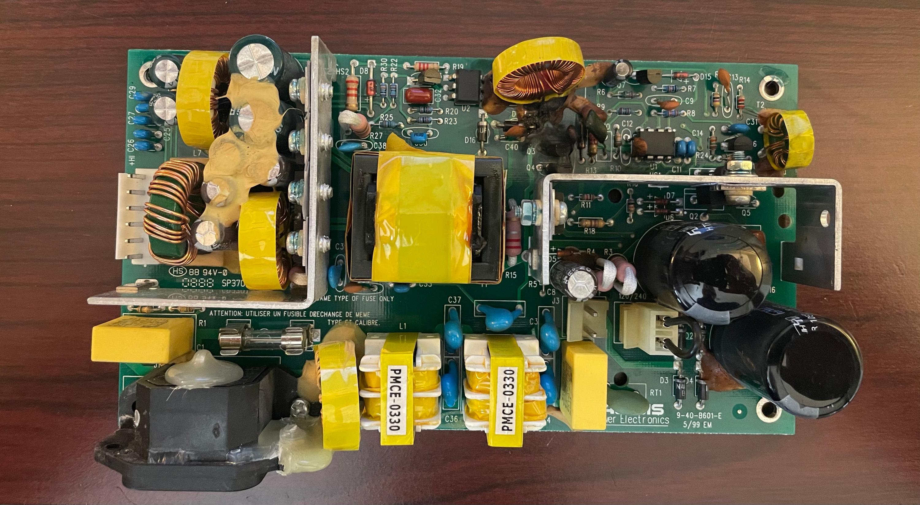

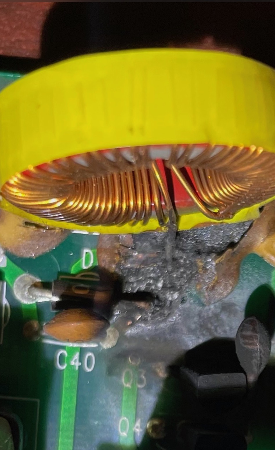

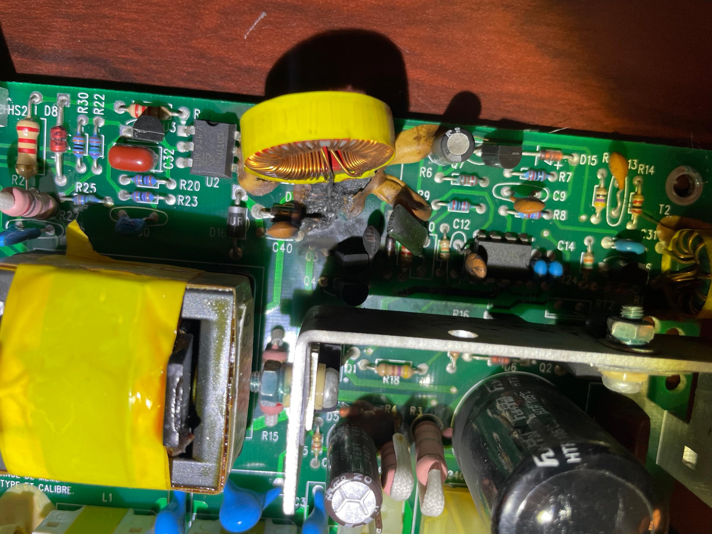

                      Hi Folks,
                      Just joined and have been reading up on how to repair these things. I have an issue that I don't think has been brought up yet. I bought a set of these monitors knowing that one of them had the issue with the blinking light so I've been prepared to do a little bit of work to have a great set of monitors. When I took the board out I noticed on mine that it looks like there was an explosion at L4.
                      Is this fixable??

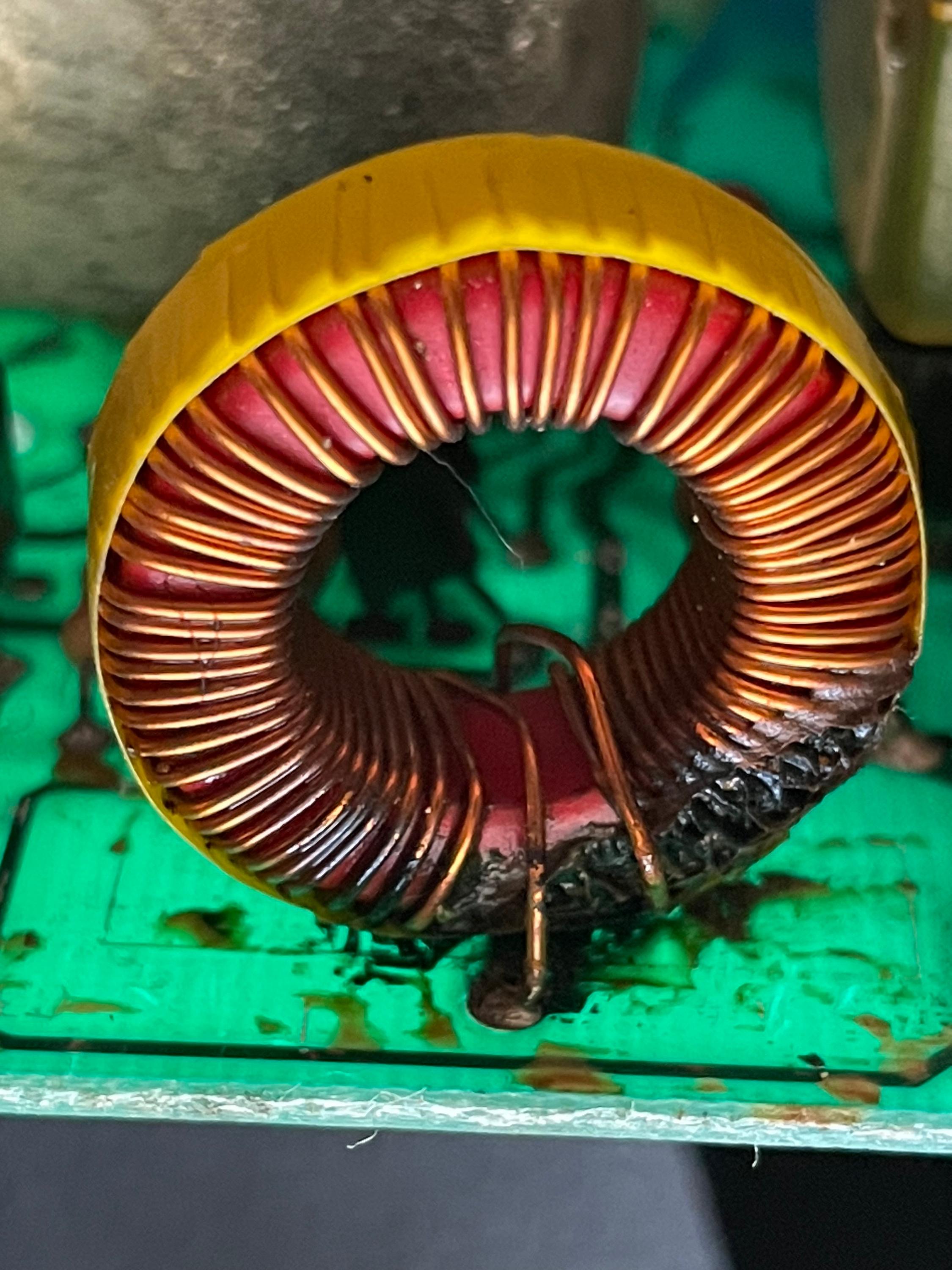

                        Here are the pics that I forgot...

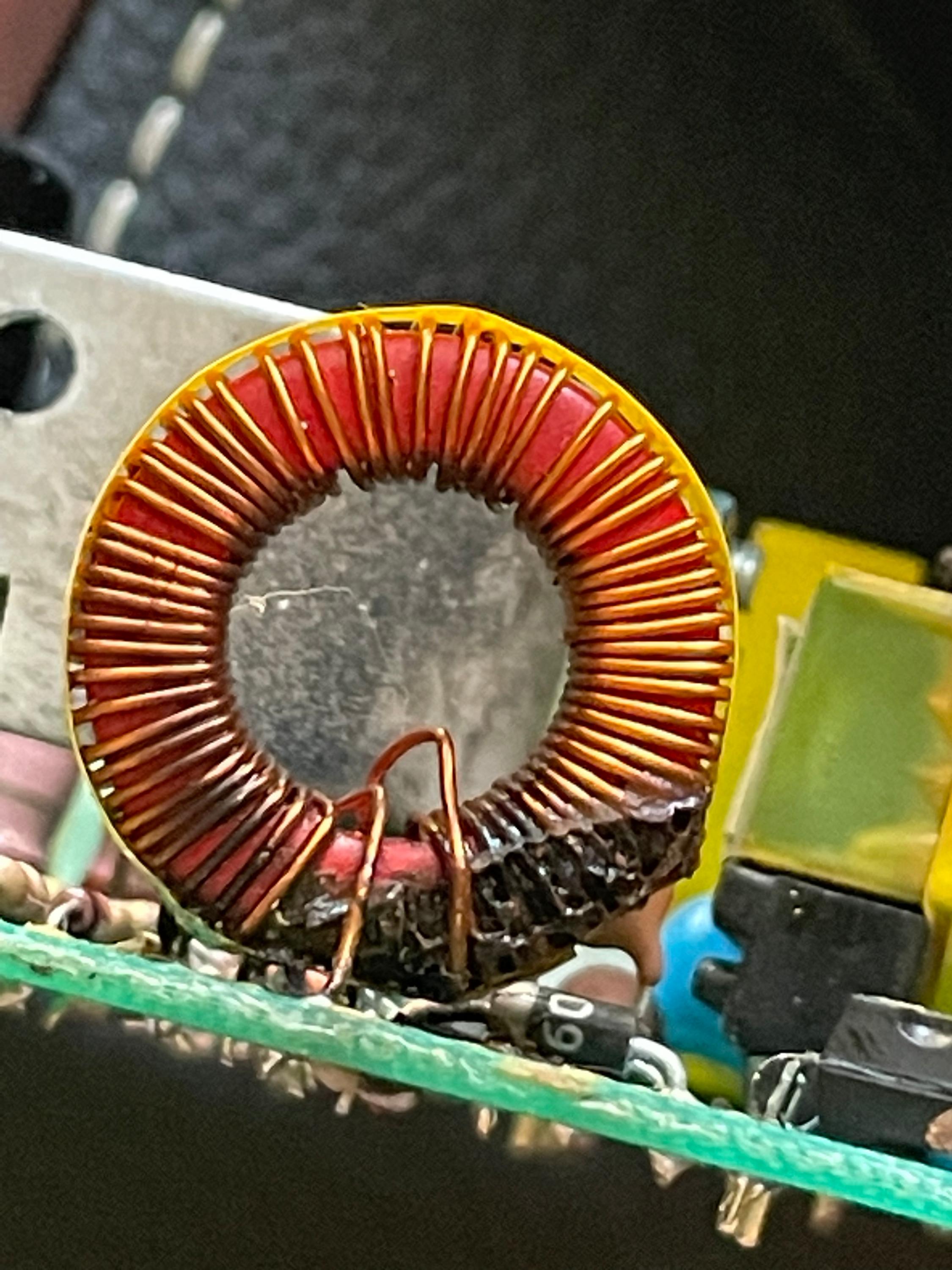

                          Hi jgulyas, welcome to the forum!
                          Oof, that does look pretty crispy. But it should still be fixable. It looks like a case of the tan/yellow glue gone conductive again.
                          Essentially, because the electronics in these speakers may endure vibrations (due to being mounted inside the cabinet of the speaker), manufacturers of such speakers often put glue on some of the bigger components to help stabilize them. And it also helps keep these bigger components in place when being soldered during manufacturing.
                          I'm not sure if some manufacturers are doing these deliberately or not (be it to save on costs or really just planned obsolescence), but many still use some form/variant of this yellow/tan glue, which is not suitable for electronics at all. The problem with this glue is that it goes conductive over time, especially when mixed with heat and/or high humidity (which, you being a fellow Virginian, I'm sure you know about in the summer ). When this glue goes conductive... well, you see the results. They are not always this spectacular... and to some extent, that probably also depends on the glue manufacturer itself (like I said, different variants), but we've seen it wreck a great number of electronics over the years.
                          In fact, if you read just a few posts above where zinger5 started his discussion, you'll see he ran into the same problem, albeit with much less damage. In his case, it was the glue going conductive between two pins on the UC3844 PWM IC (posts #465 and 468.)
                          Not only does this glue go conductive, but some of its variants are also highly corrosive... which again is a big no-no in electronics, as it can eat away at traces and component leads.
                          Thus, it's probably best that you remove as much of it as possible - especially on the primary side or anywhere with high(er) voltages or in contact with component leads. Once you have all of the glue and black sooth cleaned up, consider replacing C8 and C35, as those are usually the first capacitors to go bad. And also a good idea to use a 100-300 Watt halogen bulb in series with the live when testing the PSU to prevent further damage, once the PSU is at a point where we think it's "fixed". But we'll get there. First do the clean up and post some pictures so we can see how bad the damage is and what to possibly check.

                            Agree 100% with what momaka said.
                            I would also already do a diode forward voltage test of D14 and D9 as they look terrible in your pictures and if they are bad more components might be bad...
                            P.S: It is funny to look back at the very early board that member Skeeter posted. (Linked below).
                            There Alesis used the sensible normal hot glue to hold everything and 22 years later it still looks fine.
                            Guess they figured that wont sell any new units so lets switch to the conductive tan/yellow glue!

                              Thanks for the response and input! Over the last couple days I've been scouring the web for replacement parts and am pretty sure I'm going to need to replace that inductor at L4. I found this on mouser.com (https://www.mouser.com/ProductDetail...GrAAAO0g%3D%3D) and am wondering if this will work as a replacement? The Alesis tech manual for these says it's an Inductor Resonant 25uH 3A. The original is just the loop help in place by the exploded goop and the one at mouser has that little base on it.
                              Once I take off L4 and clean it up (using IPA beer?) I'll take some more pictures. I took the board to a pro audio place today and they were like, well, we can look at it but as soon as it hits the guy's desk it'll cost you $75. WTH... $75 just to look at the stupid thing??

                                Looking at your pictures, I don't think you need to replace this inductor... unless once you take it off, you notice that all of the wires on the bottom are burned out and shorted together from the glue. But it looks like the tape protected the wires OK. At most, you might just have to unwind 1 turn of the wire where it burned or just cut the badly charred part and solder in new wire.
                                The other reason I suggest to use the original inductor is because I'm not sure how well the core properties on the inductor you found on Mouser would match to the one that's in the PSU already. After all, it's not just the inductance and the average/max current that matter. Al and frequency characteristics matter too.
                                Looking at the one on Mouser, it appears to be rated/tested for up to 150 KHz and this PSU has a UC3844 IC (which generally runs around 50 KHz... i.e. lower.) This means the Mouser replacement *might* actually work. But going with the original is probably the safer route, since it doesn't appear to be damaged at all, aside from the final turn going into the PCB.
                                Thanks for pointing these out. I dismissed D9 to be a resistor when I originally looked at the photos. But now that you brought it to my attention, it looks like D9 really might have taken a hit... and if it did, Q1, Q3, and Q4 could be toast too, as well as the UC3844 IC. C15 looks pretty bad too, and it too is part of that drive circuit. Depending on how conductive the glue went, even optocoupler U2 might have taken a hit.
                                Man, the glue in these speakers really is one of the more potent variants I've seen. I've had it in a number of PSUs for years where it has turned a crispy dark brown and still not become conductive enough to wreck anything.

                                  Ok, so I took some time with some of the IPA you guys are talking about and cleaned up the board. I had a Pilsner by my side as I prefer that over IPA. but that's beside the point.
                                  Still think it's fixable? The inductor L4 looks like toast to me, but you guys know a ton more than I do!
                                  Oh, and I have no idea what the UC3844 IC even is...

                                    Remove the remaining glue from between the legs of U2 on the very top left of this picture:
                                    https://www.badcaps.net/forum/attach...9&d=1673633160
                                    Incidentally in the same picture to the very right is your control IC UC3844, however yours like many others here use a UC3842, with marking 3842 on the 8-pin chip...
                                    I agree that it looks pretty bad, impossible to tell really without measuring the inductance.
                                      Done.
                                      Can I measure inductance on a multimeter, and what should it read if I can, 25uH I'm guessing?
                                      Should I just take all the burn looking pieces off now or wait?
                                      Thanks for the help!

                                        Yes, take off as much as you can so we see how it looks after thorough cleaning.
                                        Also try to take a picture from the front of transistors Q3 and Q4 so we can see if they are ok after cleaning.
                                          Hmm.. yeah definitely looks a lot worse from this side - at least the wire definitely appears to be toast.
                                          If the core hasn't overheated when the failure happened (and that's the hard-to-tell part), you might be able to rewind it. But at that point, since you probably will be ordering new capacitors and possibly other parts, then you might as well get the inductor you found on Mouser... unless of course you just want to try rewinding the old inductor for fun/experience. But even then, I suggest getting the one from Mouser, just as insurance... or at least so that if you find you need it later, you won't have to pay separate shipping just for this part. Don't discard the old inductor yet either - not until the speakers are fixed and verified working, just in case.
                                          IC = integrated circuit (i.e. chip)
                                          UC3844 / UC3842 = literally the "heart" of this power supply - it drives the main switches (MOSFETs) On and Off to produce power on the secondary side of the PSU.
