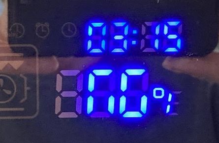

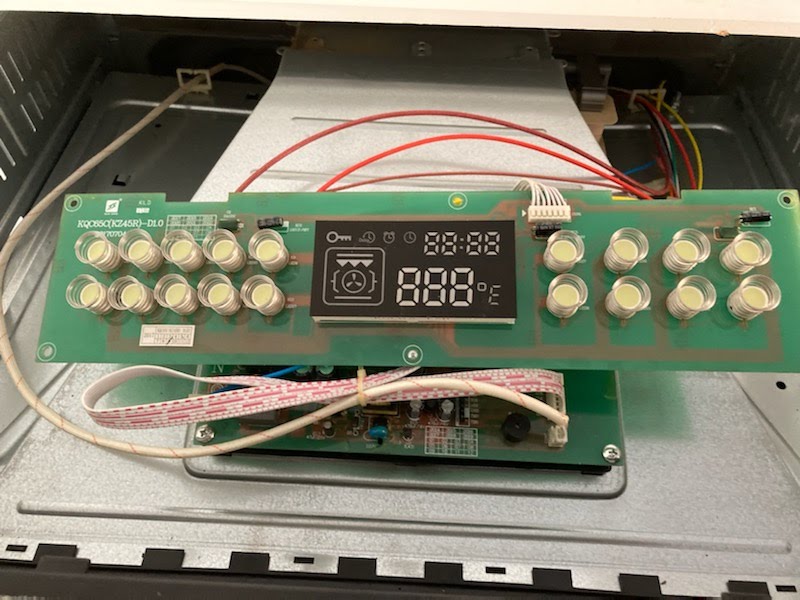

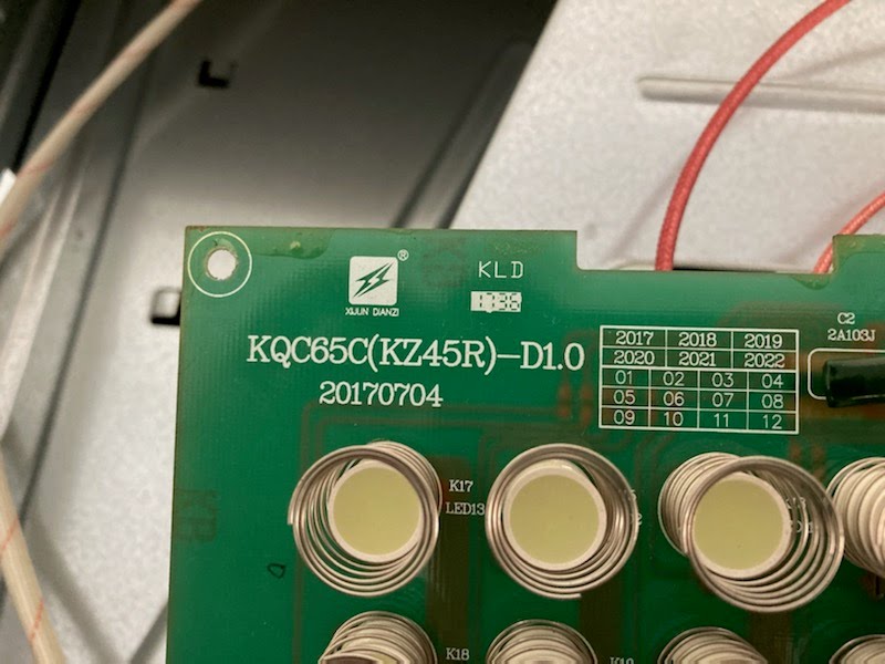

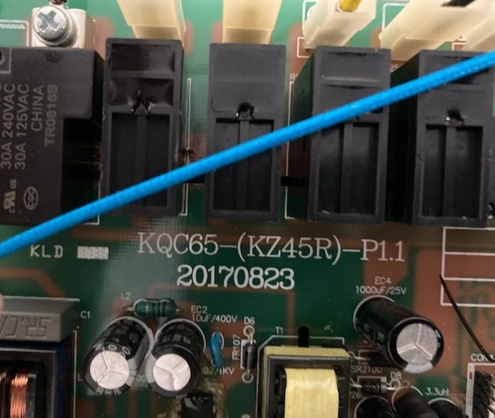

    My friend asked me to check this oven display, its Empava KQC65C-17, and the part is not available even from the manufacturer. On the bottom of the first pic temperature digits have some LEDs off. Im trying to figure out what parts/components could be the culprit so I can test them. Also what connectors I should use to power it on? I only have those two boards in the house, not the entire oven, but looks like it can be powered on from 110 or 220V.
    • 31247
    Re: Built-in Convection Electric Oven - display problem
    get a 3v coincell battery and try to light all the segments.
    there is a good chance the actual leds are bad.
    notice the uneven brightness in the working ones!

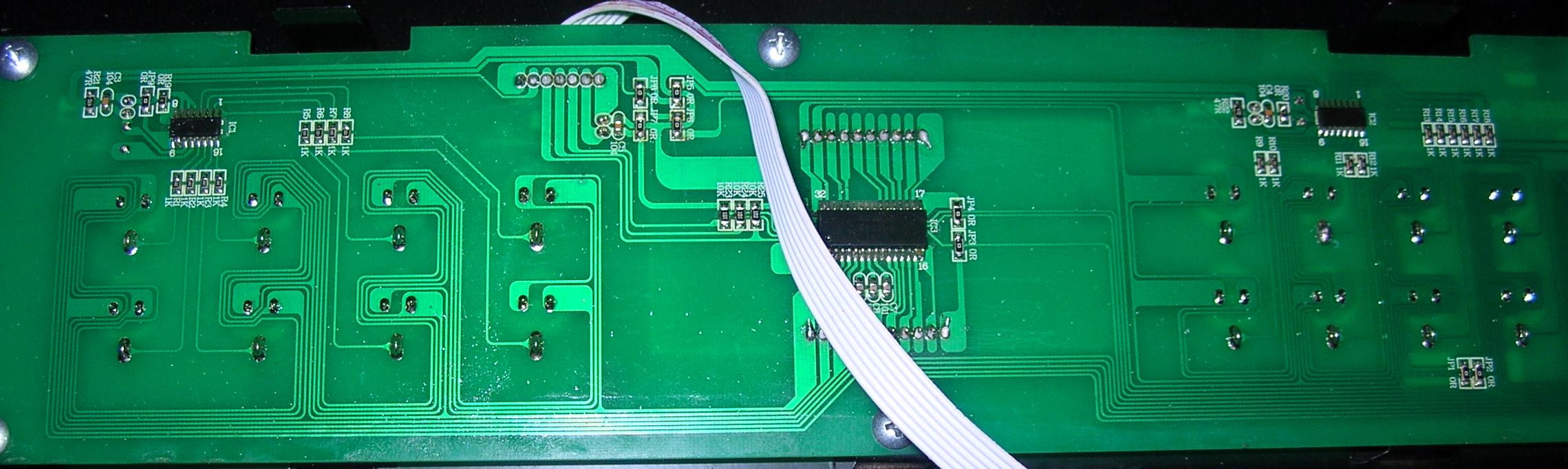

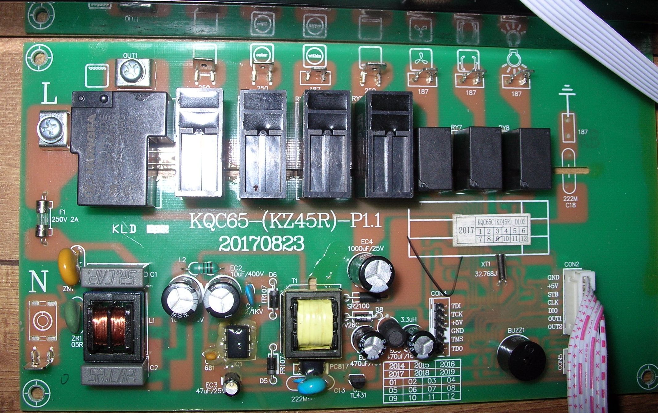

      what points I should use to connect 3V? Should I use 5V/gnd pins on the power board (pic #5)? This connector goes to the display board. I have 5V DC adapters I can use, also lipo batteries 3.7-4.2V.

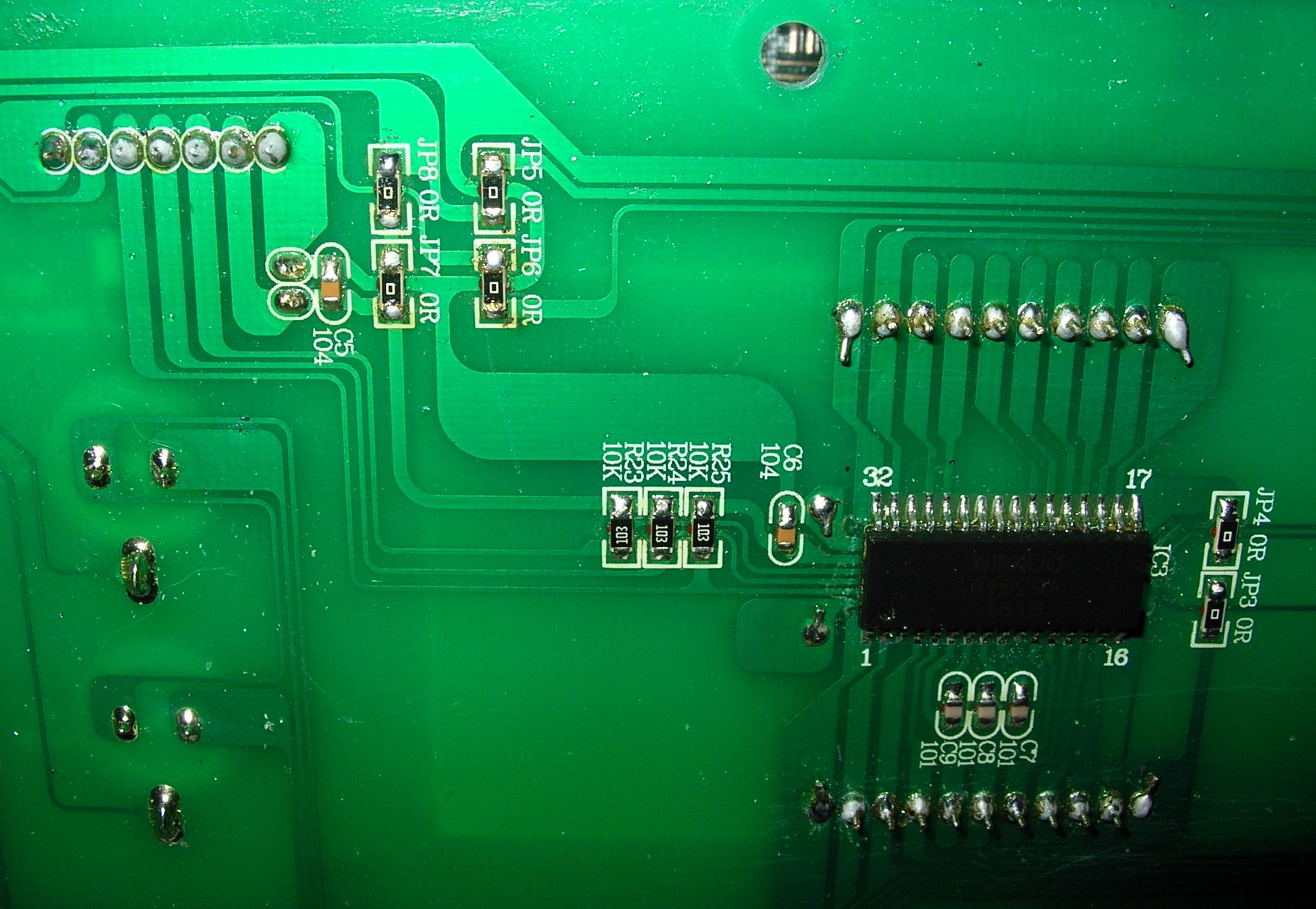

      This is part of the board on the backside of display, top left are connector pins

        Re: Empava KQC65C-17 Built-in Convection Electric Oven - display problem
        Dose this display pins go to an ic chip of some type if dose then might be a chance that that chip could be this issue or if the display has a multiplex common pin that connects all the diodes to a common negative or positive terminal I have seen these displays do this when they fail
            the display is matrix driven and the chip is probably a Holtek clone

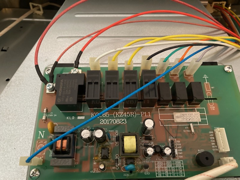

              He sent me pic of how it was wired before disconnection
