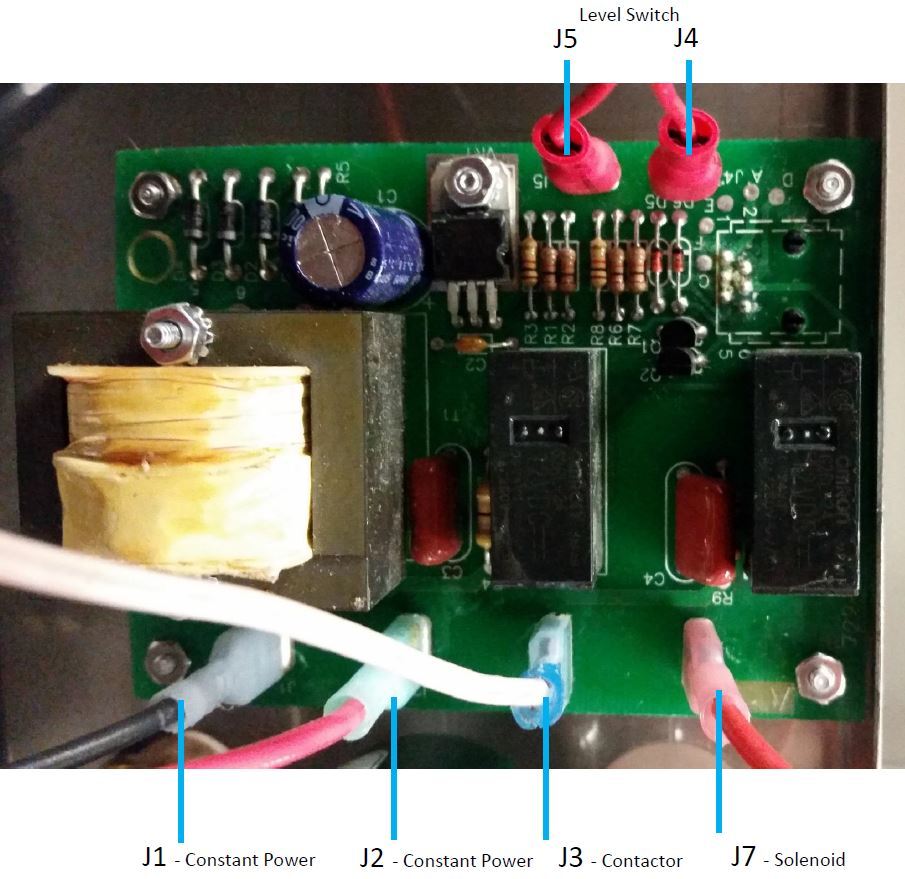

      Ok and understood... Actually, the only thing that I'm not nervous about it running my two 120v wires and a ground from my breaker panel.
      I am nervous about connecting to the Circuit Board. I dont want to destroy or burn the thing.

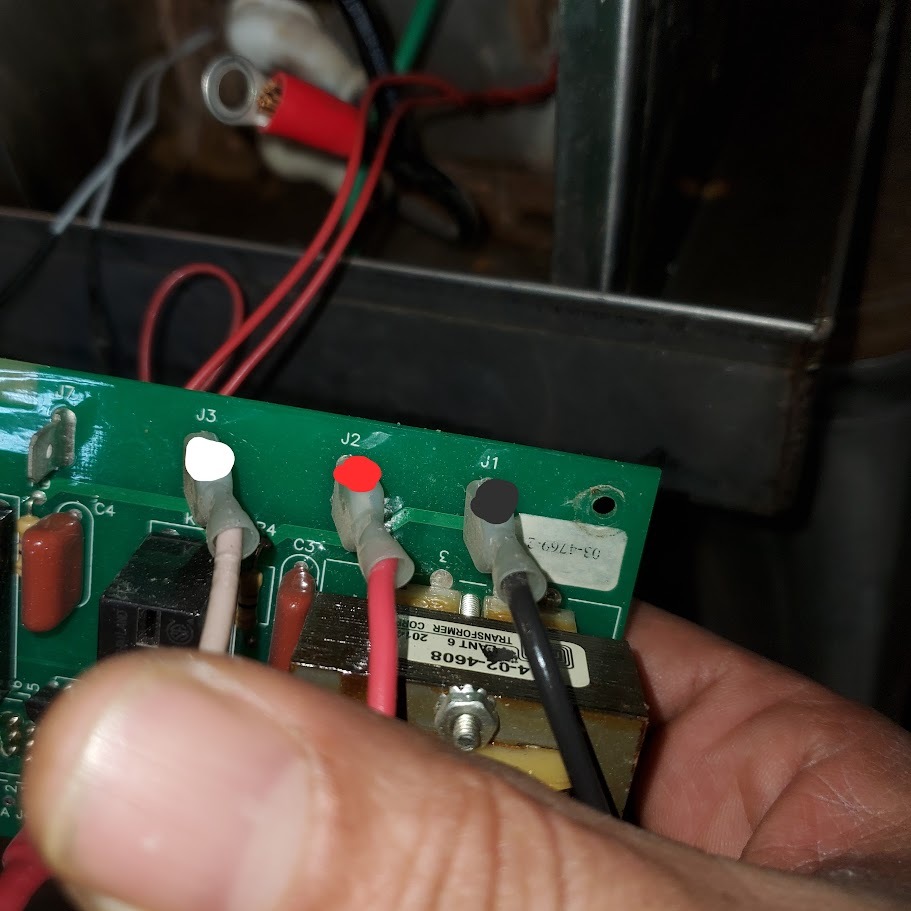

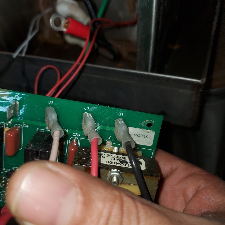

      For the circuit board connections ---- for J1, 2 and 3 on the board,,, where do I connect those?
      Are you willing to use one of my photos and literally paint me a picture, lol. No kidding,,, I have NO faith in myself to get it right OR hoping that I do.
      Do J 1, 2, 3 on the board get wired to the the RED or BLUE spades?

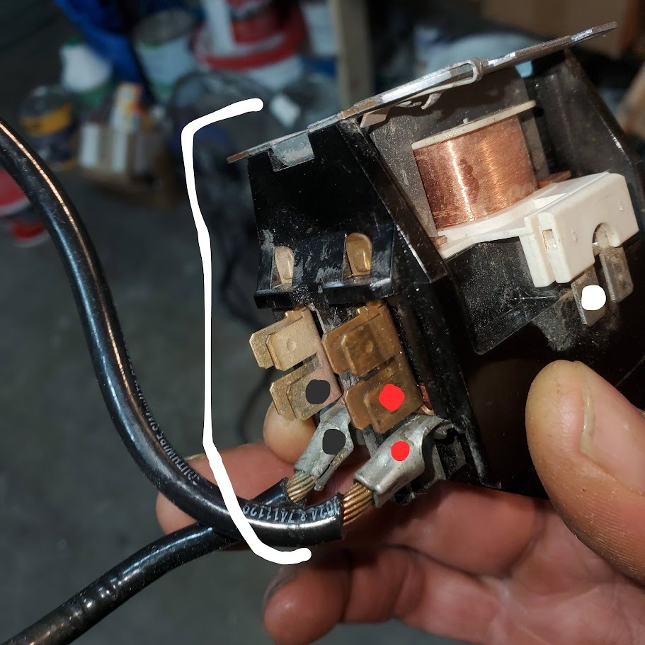

        Wiring the contactor is a little scary

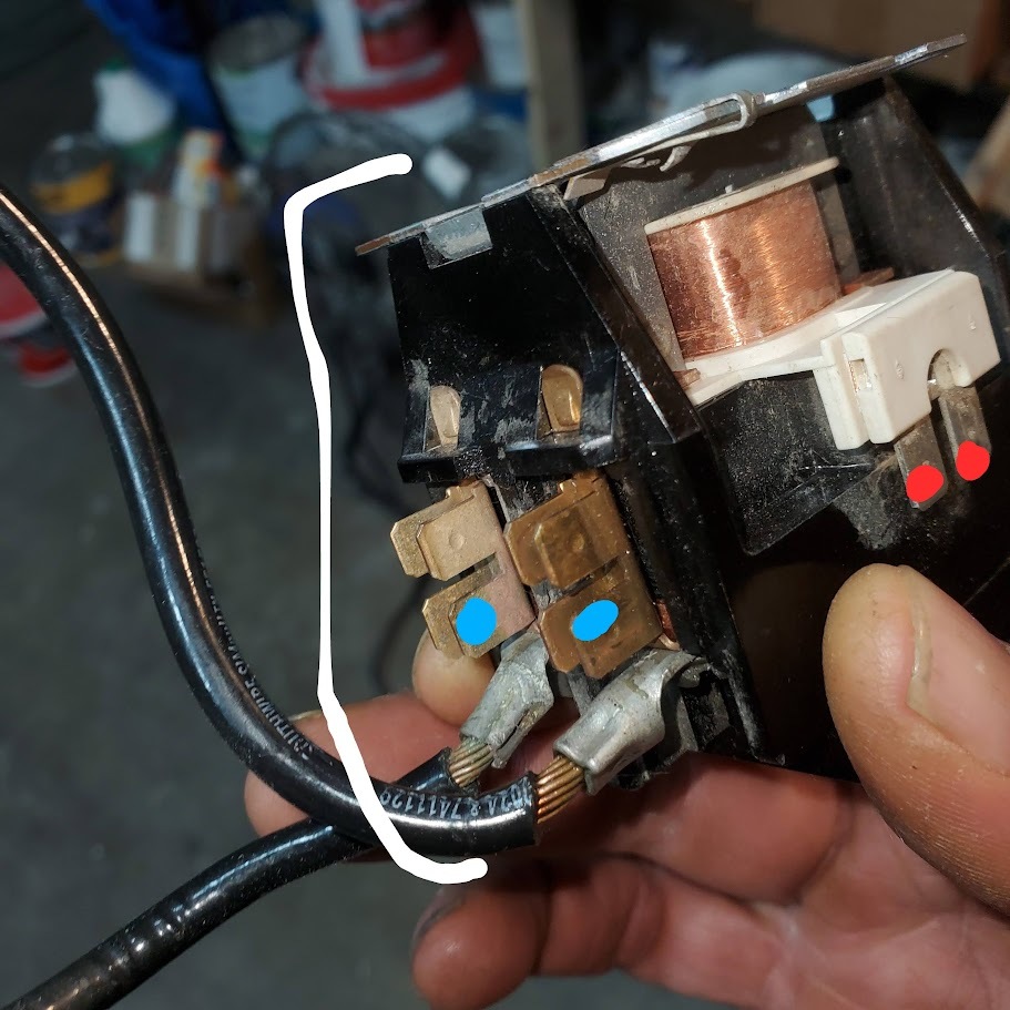

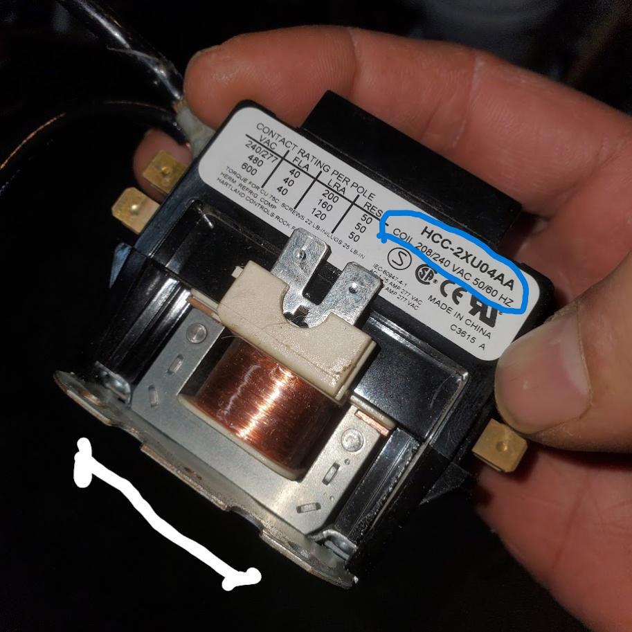

        I see the two spades on the one side for the coil, are tied together! (red dots in pic). This can cause boom!
        Important: OP take an ohmmeter and see if you can find the 1,000 ohm reading on the contactor terminals. The (blue dots) could be the contactor input or output. The coil likely connects to one on the input or line side.
        Contactor datasheet: HCC or Hartland Controls
        Both suck - they don't show what the other leg of the coil connects to. It must go to L1 or L2 etc. which is done on some contactors to save a wire.
        The control board relay just shorts J1 and J3 together to activate the contactor (I think the schematic has the GND dot in the wrong place, it should not be on K1-3 it should be lower on K1-6).

              the plan is simple - test all the bits seperatly - starting with the pcb because it probably powers the expensive controller.
              so we NEED to know thats putting out the right voltage.
              then we can test the relays on it -- they only need 12v,
              then the solenoid(s) contactor etc.

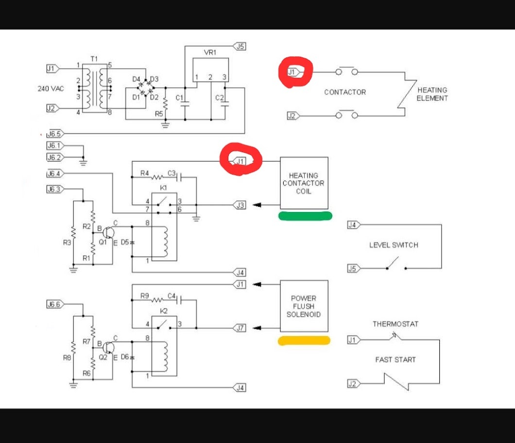

                Ok... Call me craZy and point me out as wrong, BUT I think I may have it...
                Here's the thing. I think that this wiring diagram ISNT so much about following it to wire it up, but its just saying a little something about what is connected to or is getting power from what. THIS is directly from the the instruction manual --- "Connect 240-volt SINGLE PHASE AC electrical lines to wires labeled 1 & 2 in junction box on the generator and an approved ground to the green safety grounding wire". IN THIS, can we call "wires labeled 1&2" J1 and J2?

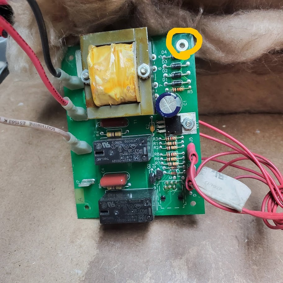

                First, a quick question. See photo YELLOW CIRCLE. Can THIS be used as the ground for the entire board and its components when bolted to the box?
                Second idea, I don't think (am pretty sure) this unit comes with the electrical power-flush solenoid. I think its just a manual system - handle on top - and the instructions to run a manual "power-flush" are in the instructions/manual. The instructions for the controller for this model say nothing about an E control for power-flush at the controller either. I took the box off the tank last night and there is NO solenoid or wiring for a "powerflush solenoid" that I can see.
                So, I think the power-flush solenoid in this instance can be disregarded?
                From the instruction manual in RED above. Basically its just saying attach 2 120v leads and a ground to the wires in the junction box, and BOOM,,,, everything is wired! From there the diagram is just showing what is touching the 120v sources,,, J1 and J2. I think J 1&2 and everything connected to J 1 and J 2 uses the two wires (see photo) RED and BLACK/J1 & 2/red dot black dot,,, in the photo. Then, corresponding colors and J1&2 at the MAIN power feed on the contactor... Then, the white, connects to where the white dot is (the signal or control) for the contactor...? Did that make any sense, lol?
                Then, anything that needs to be powered always LIVE or on the SWITCHED sides gets wired into the spades on either side of the contactor? Grounded to the BODY of the machine ie. thermostat/thermometer/level switch/power-flush solenoid (if there was one...? I'm not sure about the grounding at this point. Or anything for that matter....
                ADDITIONALY - I'm hoping I am making sense here, the "thermostat/fast start" circuit LOOKS like it has a heating element in it and the circuit is completed when the thermostat CLOSES completing the circuit allowing 120v on both legs to heat the resistor/element in the tank??? 120 on both legs to heat the coil/element? Strange thing is they are doing that with like 18 or 20 gauge wire???? Anyways, If this is the case I may just disregard this connection to save energy. We have NO need to have a fast start. We will not be using this as much as that.
                So, the flush solenoid is obsolete as is the fast start. Do you think the unit will run without the thermostat?
                I'm also thinking that using "J1" as a switch control in what they have labeled as "HEATER CONTACTOR COIL" can and should come right off of ONE of the spades of my 120v leads and the other side should plug into "J3" coming off of the board to complete a circuit and energize/control the coil and contactor???

                  I can't figure out the contactor coil - can you look closely and find the "A1" terminal near the coil or is it only "A2"?
                  I will sketch something once I figure out there the two connections for the coil are. It might be that "A1" is internally connected to "L1" or "L2" terminals on it.
                  Main ground should be a stud somewhere in the metal enclosure. Needs to be good for a 40A fault. That PC board ground bolt is not enough, it's only for grounding the controller and its safety.

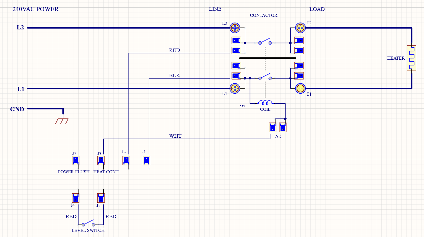

                    OK I figured out most of it and did this drawing for you to look at.
                    The trick is is "J1" is common mains power for a few things so their schematic diagram shows it connecting to a bunch of stuff- but it's only one spade connector lol. It's a lousy drawing then they don't want to offer support. Makes sense.
                    The only unknown is where the contactor A1 terminal is? I can't see it in the pics or Littelfuse/Hartland Controls crap datasheet. Can you figure that one out with an ohmmeter or something.
                    The control board still needs the keypad/display etc. which connects at the RJ jack.

                      Red! That is perfect....
                      I was just speaking with the 3rd person at thermosol. The first two had zero info, the third, did good. She sent the 2nd attached picture.
                      In speaking with her and now THIS, I think I have everything I need to feel fairly confident in wiring the thing up.
                      Friday, probably Saturday morning, I will give it a shot and SEE if there will be steam...
                      Thank you for this. Its exactly right.
                      The A1 lead comes directly off of the J1 120 volt connection. One of the spare spade below the main lugs.
                      The contactor says its a 220v pull down rating BUT I can only hope thermosol knew what they were doing and that 110/120v will close it.
                      So, I guess I will make and wrap a wire around from J1 or 2 and connect it to A1 like is says in the diagram...? What do you think about that?
                      Also,, for those two super skinny white wires that go to the thermostat/fast start (she swears my unit/model doesnt have it) she said that she would say that IF mine does have the equipment that I should just plug each end into the 120v J1 and J2 and its a small resistive heater that preheats the water. Not sure how I feel about that, but. I don't think i need to pre heat the water for a fast start anyways.

                        Yesterday I was feeling pretty good, progress, but as you pointed out A1 still leaves a question.

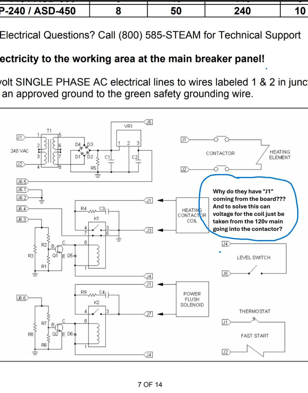

                        I'm confused as to why the drawing seems to show the "J1/A1" connection coming off of the board - and not from somewhere else. There is NO spade for this on the board.
                        Because it is labeled as "J1" I was confident with the idea that I could run a wire from one of the 120v spades under J1 into the contactor powering "A1" with that - then "J3"/"A2" to the board for the control of the contactor, as in your drawing.
                        But today I am not so sure. Also, its a 240v coil.

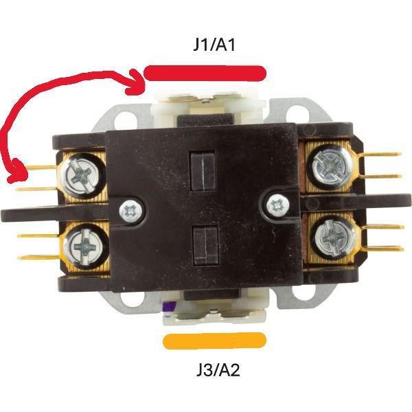

                        Ill post a from above pic (from the internet) of the contactor to see A1. Its there, on the opposite side of the contactor from the A2.
                        Also, another shot of the schematic where it seems to show J1 for the Heating Contactor Coil coming out of the board. It is a terrible drawing and it is confusing me...

                          The factory bonehead schematic is trying to say "connects to J1" but this is only one terminal... yet the contactor terminal has 4+screw so they are using that as a common point for connections. Point is L1 Line all connect to one point. The PC board cannot handle high (heater) currents either so heater J1 could not connect to it there anyway. You might be missing a short jumper wire? It's not a good schematic IMHO.
                          Also note- the Water Level Switch is a master cutoff of 12VDC power to the relays and the display board. So low water everything will appear dead.
                          Before I'd start this up, I would confirm the water level switch works and there is no ground-fault with the heating element. You could power it up with heater disconnected to see if the contactor pulls in and display operate.
                          I thought these steam generators plug up inside with lime and calcium, it might need an acid wash inside?
