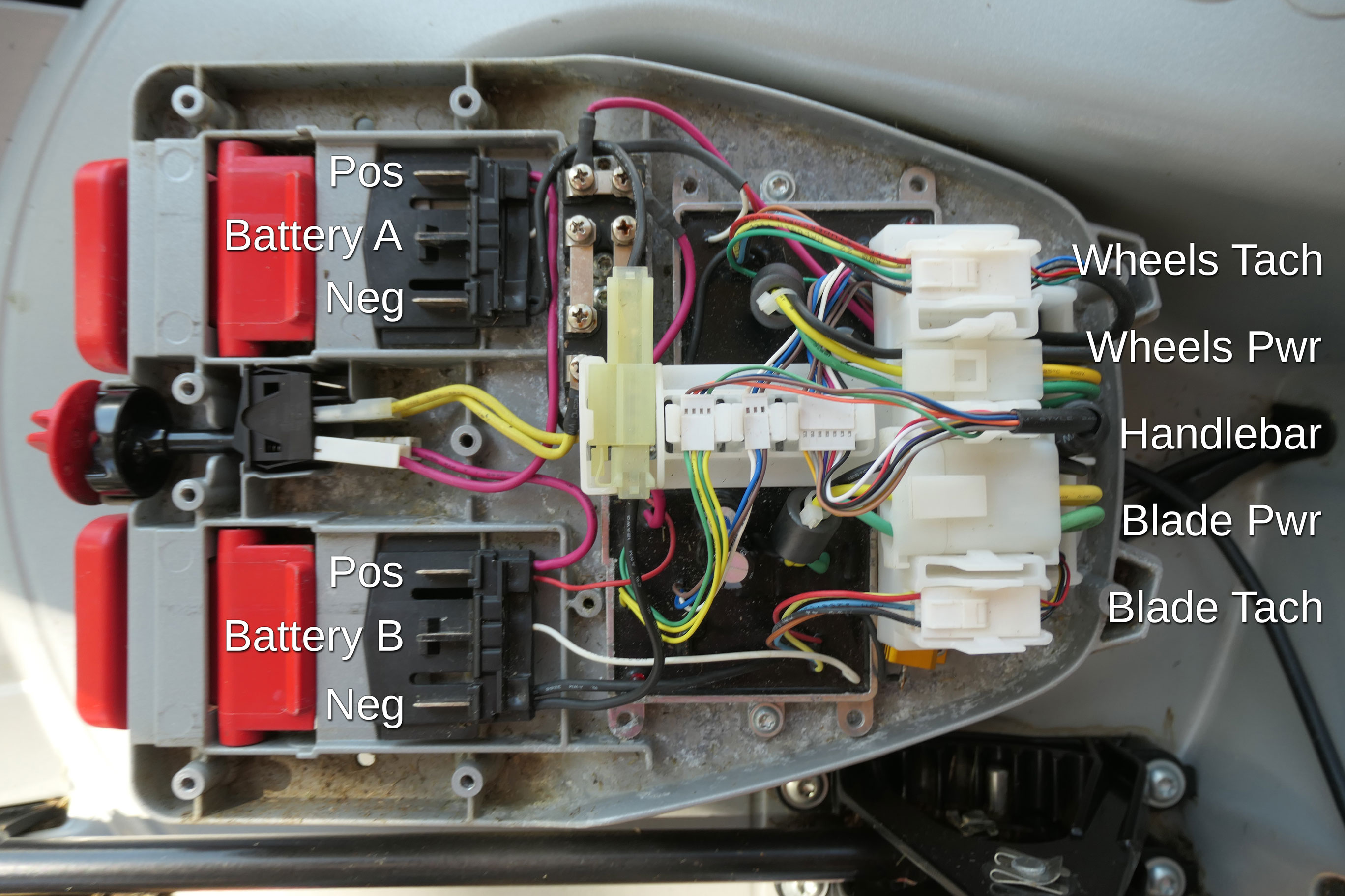

    When holding the "start" button on the handlebars and holding the bar against the handle no power is sent to the motor. There is just a high pitched whine for a couple of seconds, a pair of faint clicks one second apart then nothing. The fault is consistent with either both batteries or just one battery in either slot.

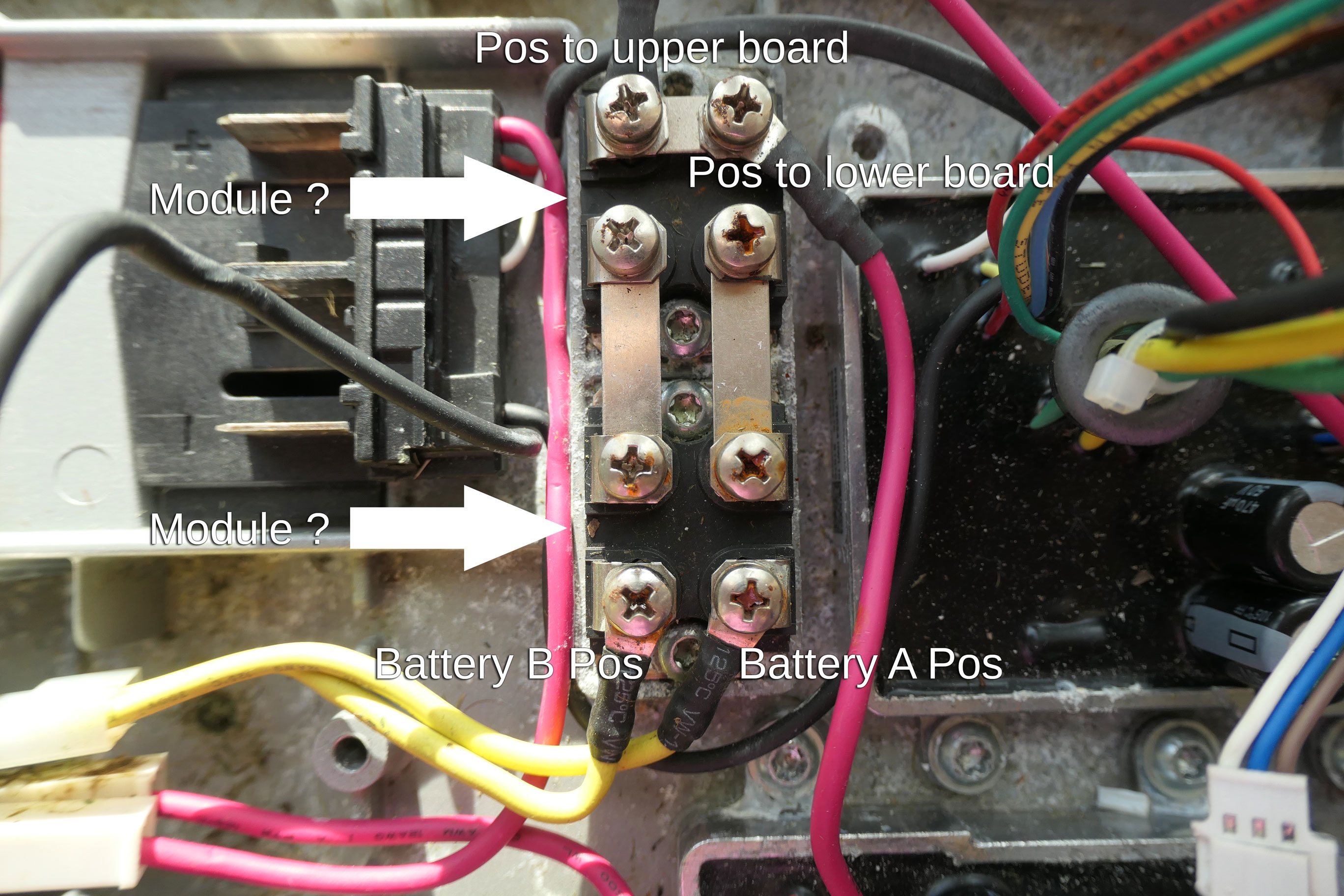

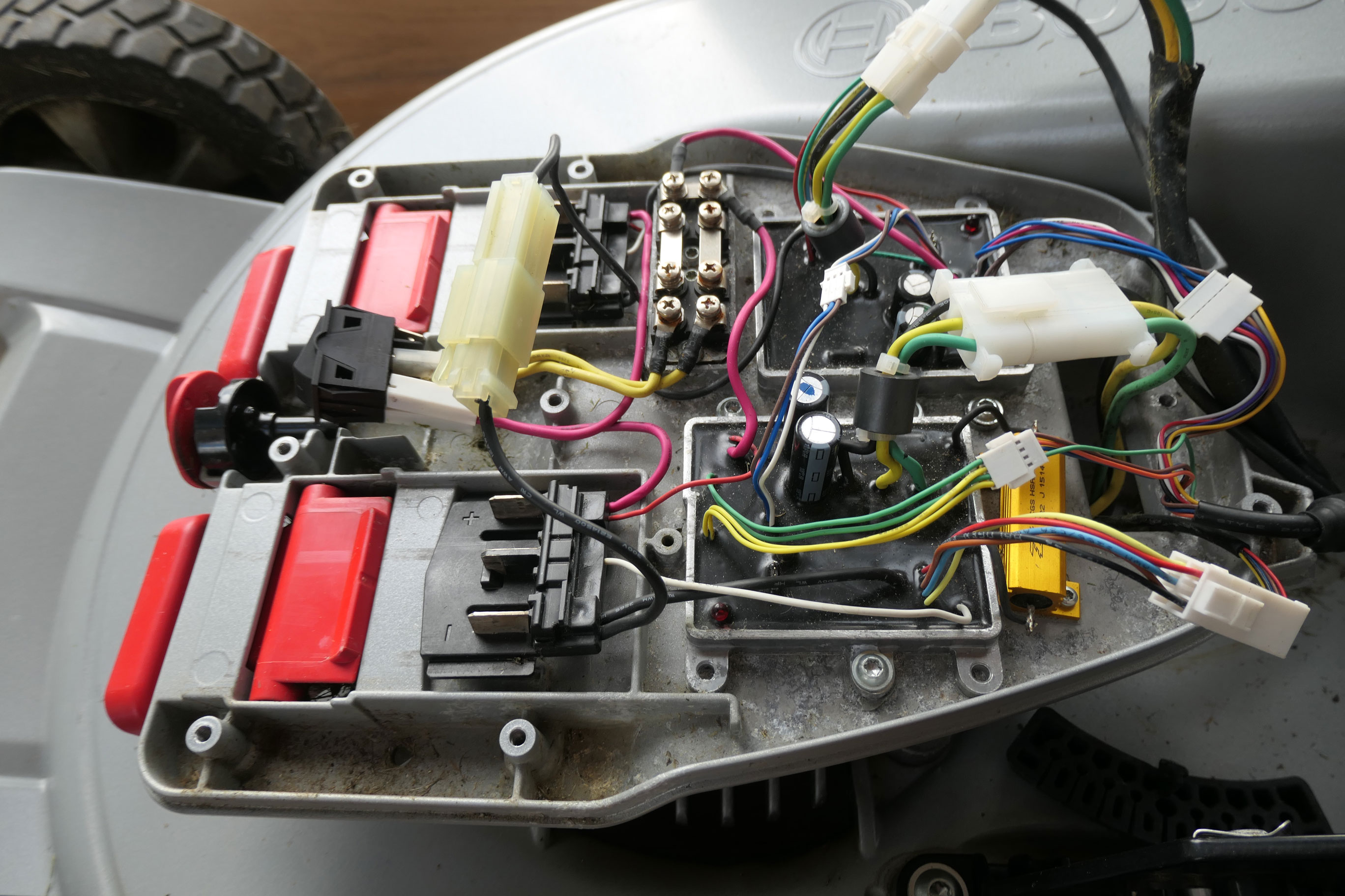

    Having opened the top case of the mower I can see all wiring connectors appear normal. Nothing appears out of place or burned. I can understand what most of the cables are for and have identified a few of the components. While there are red indicator LEDs on the two boards, all components are buried under black potting compound (of course). There are some test or programming pins protruding from the compound.
    I have been following how the mower has been designed and can see the pair of parallel battery positives go to each side of the child-proof switch. Each side then goes to a pair of square components which I do not understand. I have not removed them to see if there are any markings on the other side. If they are fuses then I am confused as to why there are two of them running in series.
    Because there are a pair of wires running from each battery direct to each potted board, the boards sense the batteries and power up, showing a steady red LED as soon as the safeties of child lock, side button and handle bar are set.
    So, first question, does anyone recognise the symptoms and what are the two square modules I have highlighted in the second image please?

      There are two of these potted control boards. The (upper) one deals with drive power and drive feedback as well as accepts the cable from the handebar that requests drive and speed. The (lower) other one only handles power to motor, tach feedback and the power bar from the handle. It also has the 50W 2.2 ohm power resistor across it. There is also a small wire jumping from one control board to the other.
      For the main motor power cable, which of the black, yellow and green leads are positive and negative do you think? I assume it is a DC motor?

            I have not checked the motor supply or behaviour this morning yet but I have managed to identify through Google what the mystery two square modules are for that I asked about in the first post.
            According to the Parts Diagram it is "91 - Diode Module" so presumably I can check if they are working correctly somehow? My multimeter does have a Diode setting. Does it have to be done in circuit or out?
            Oh, and the potted modules are simply listed as either 887 or 888 - Electronics Moldule and come with a big pile of bits for about £200. Of course finding anyone that has one in stock will be... interesting.

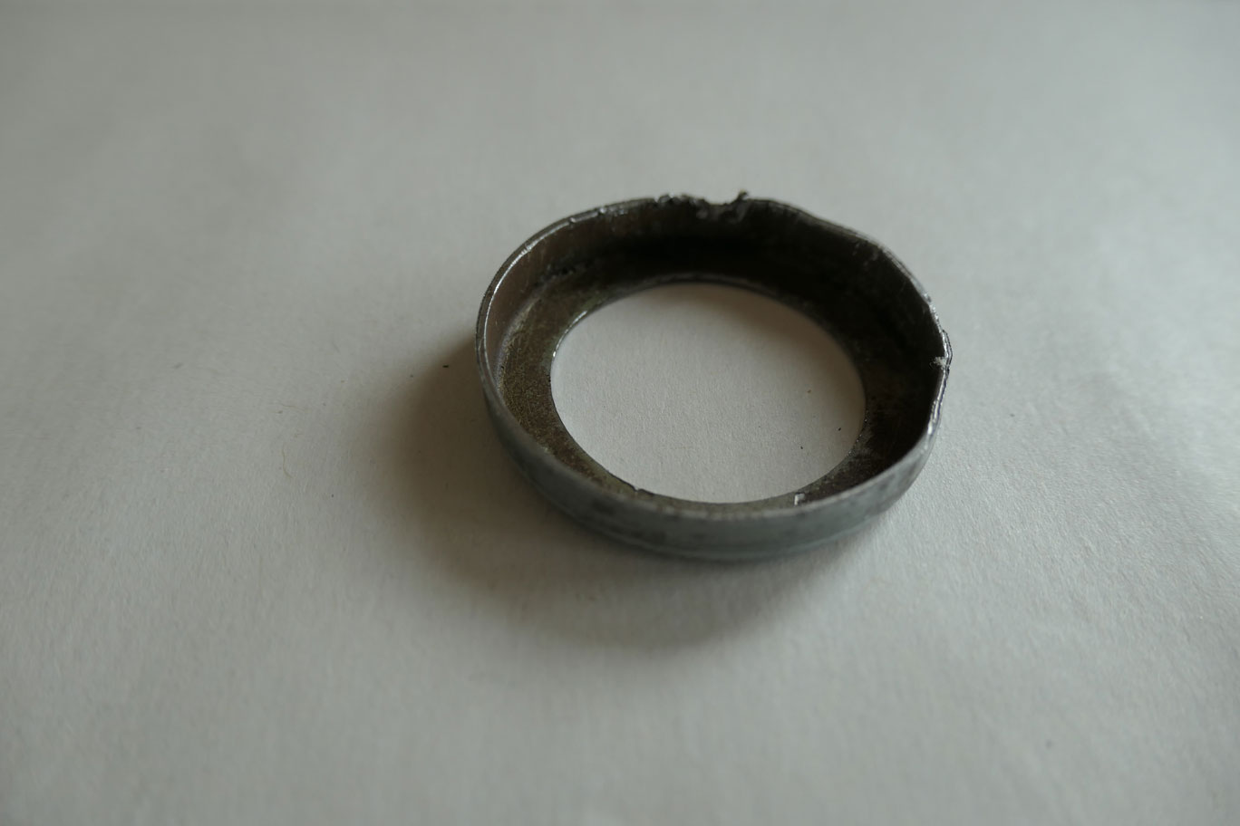

                    This is the Shaft Seal that was covering the most exposed bearing. I was wondering if it was incomplete but I suspect it is just cheap.
                    When the mower was originally about two years old I noticed steam coming out from under the mower when cutting long and damp grass. The blade was turning roughly and this was the exact shaft seal that was in place at the time. There did not appear to be any rubber around the seal and there was about a 1mm gap between the seal and the shaft itself. Dirt and water had got into the original bearings which was causing the heat that was making the wet grass steam.
                    I had to use a screwdriver blade between the motor housing and the sides of the shaft seal to collapse them in so it would release. At the time I replaced the bearings with SKS brand, straightened the sides of the seal and repositioned it.
                    The same failure has happened again so I am going to be measuring the OD, the shaft diameter and seal thickness and upgrading it.
                    Any suggestions for what type and material of seal to get assuming I match the original dimensions?
                    This is a seal for a vehicle which while the incorrect size shows the sort of thing I think I should be measuring and using. I suspect the part will be 35mm OD, 25mm ID but will measure with digital calipers once everything is clean.

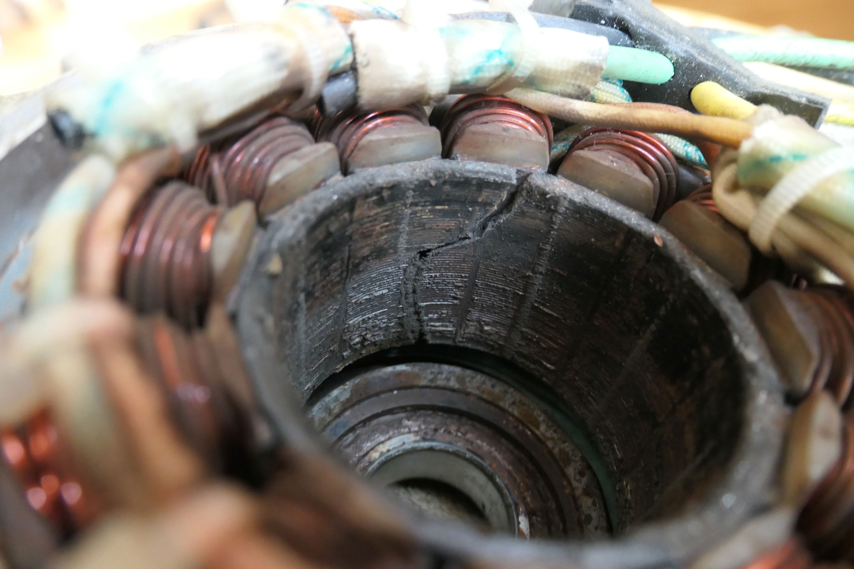

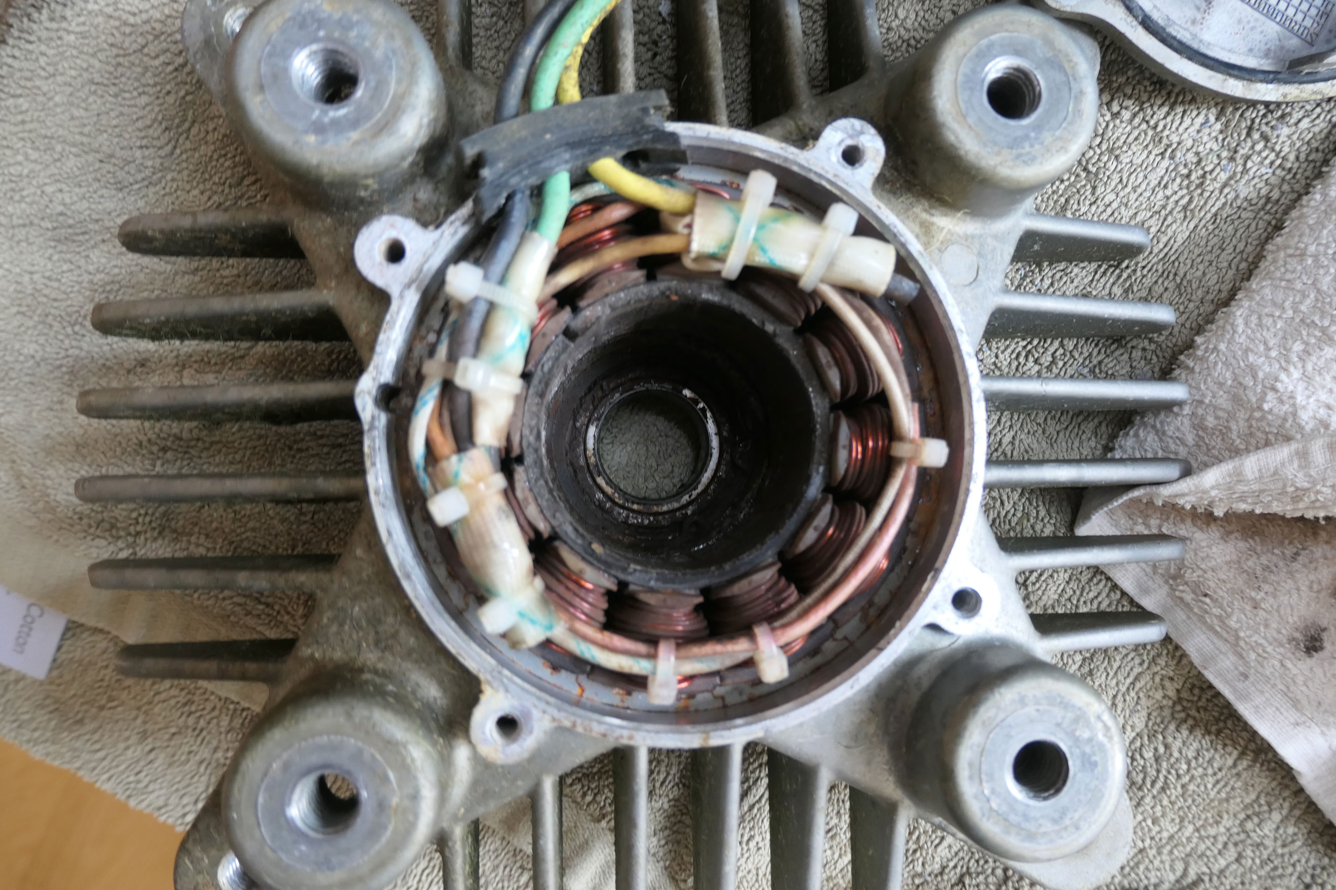

                            Well folks - it is moot... the motor itself has failed due to corrosion and has a crack right across the stator.
                            It looks like there has been considerable water ingress over quite some time through the "shaft seal" (which is really only for impact protection). The lower bearing is rusted almost solid and is reluctant to turn. The top bearing under the end cap is in good condition but wet.
                            The permanent magnet rotor is wet, surface rusted but intact. A scotchbrite pad would have cleaned it up fine.
                            The stator with its 12 windings still has good wiring but the laminated core has a crack running completely through it from top to bottom. It is heavily rusted and shows signs of burning with carbon on the end cap. The failure of the stator is what was binding up the entire assembly.
                            Now it is possible I might be able to find a replacement stator/rotor core for the motor since I suspect it is a nominal size of 100mm but it looks like it would need a press to install it in the proprietory Bosch motor housing and I certainly don't have one.
                            Here are two pics - one of the complete housing and one of the damaged stator.
