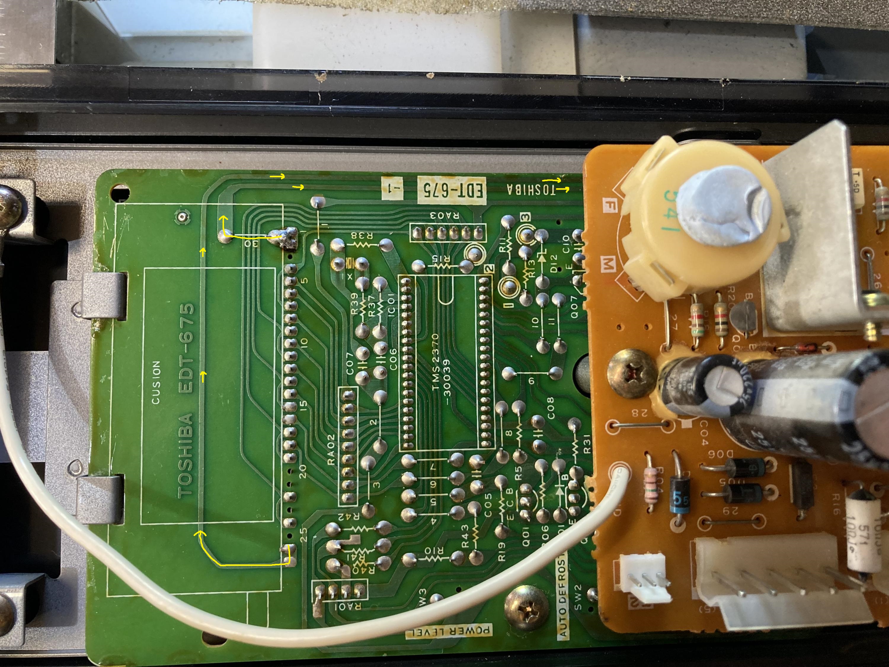

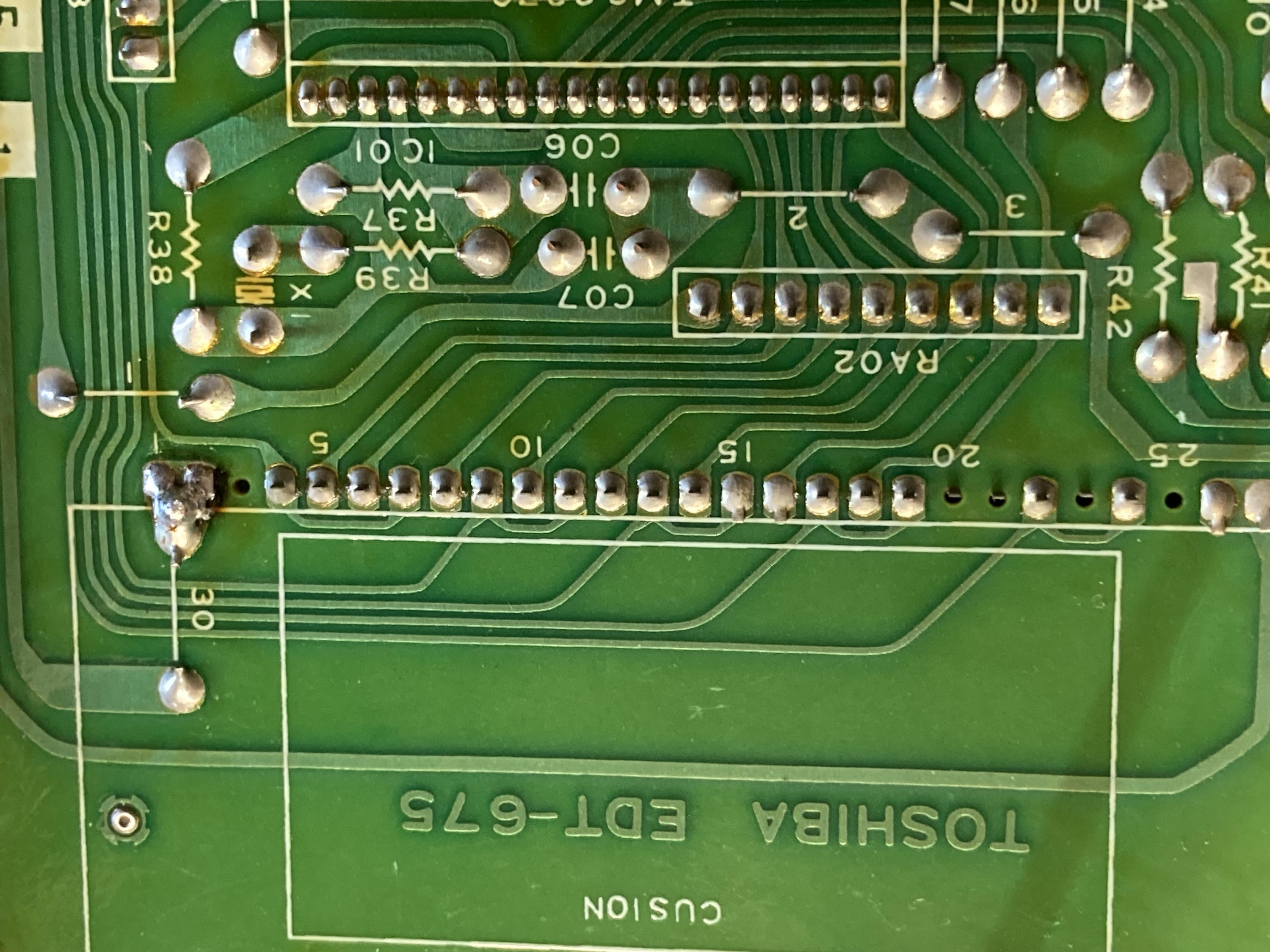

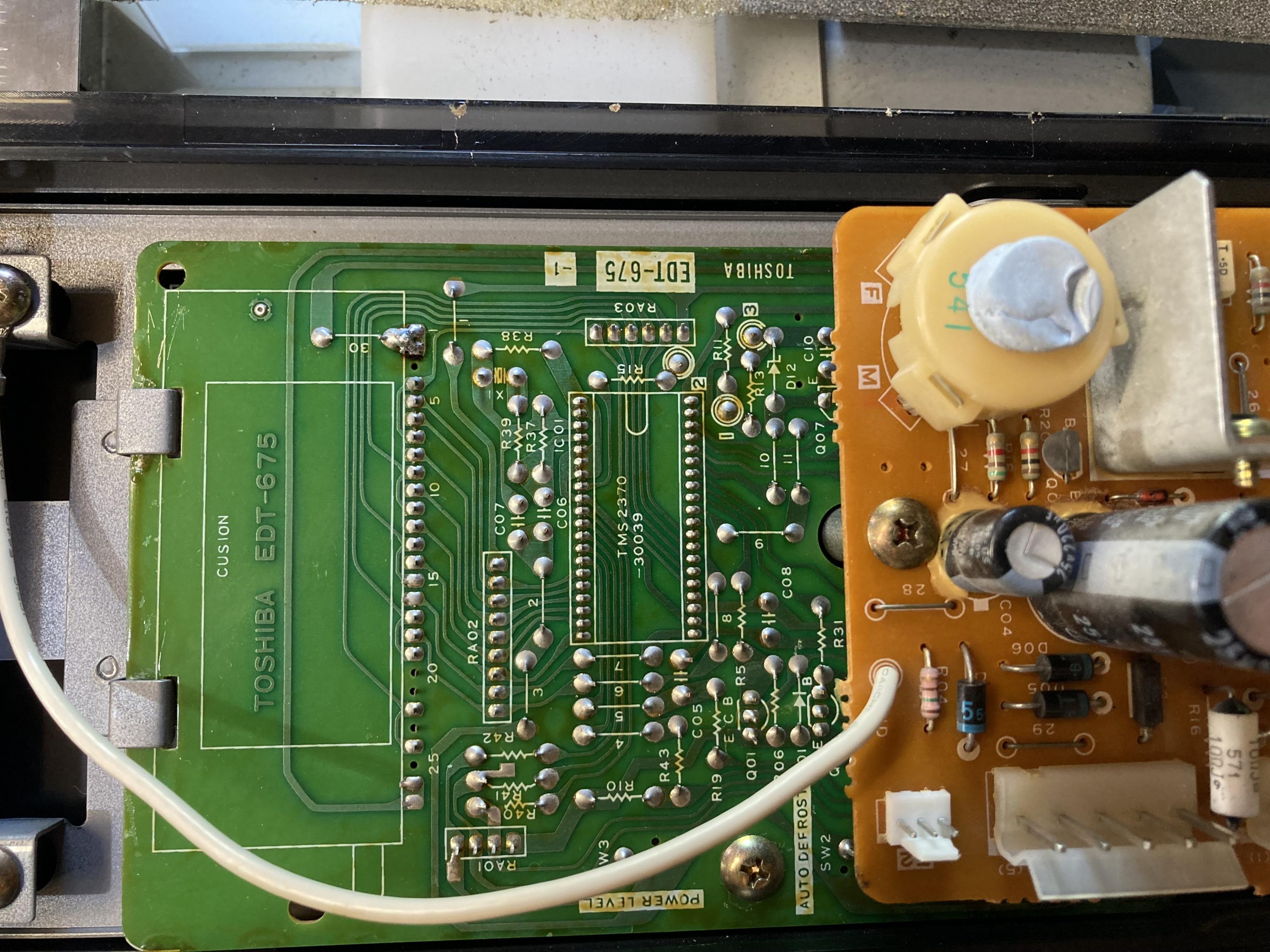

        Thanks for the replies. Re-soldering all the pins seems to have helped in that the display will now stay on for longer (30 - 40 mins ?) but eventually it still goes out. As can be seen in the pic there was some blackening around pin 1 which I didn't notice the last time I took it apart - but this was maybe 4 or 5 months ago and it has been steadily worsening since then, so maybe it wasn't as obvious back then. Anyway, still scratching my head as to where to look next.

          Re: Vacuum Fluorescent Display issue
          The bad connections may be at the source of the filament voltage, follow the two traces from the vfd and you will likely find the problem.

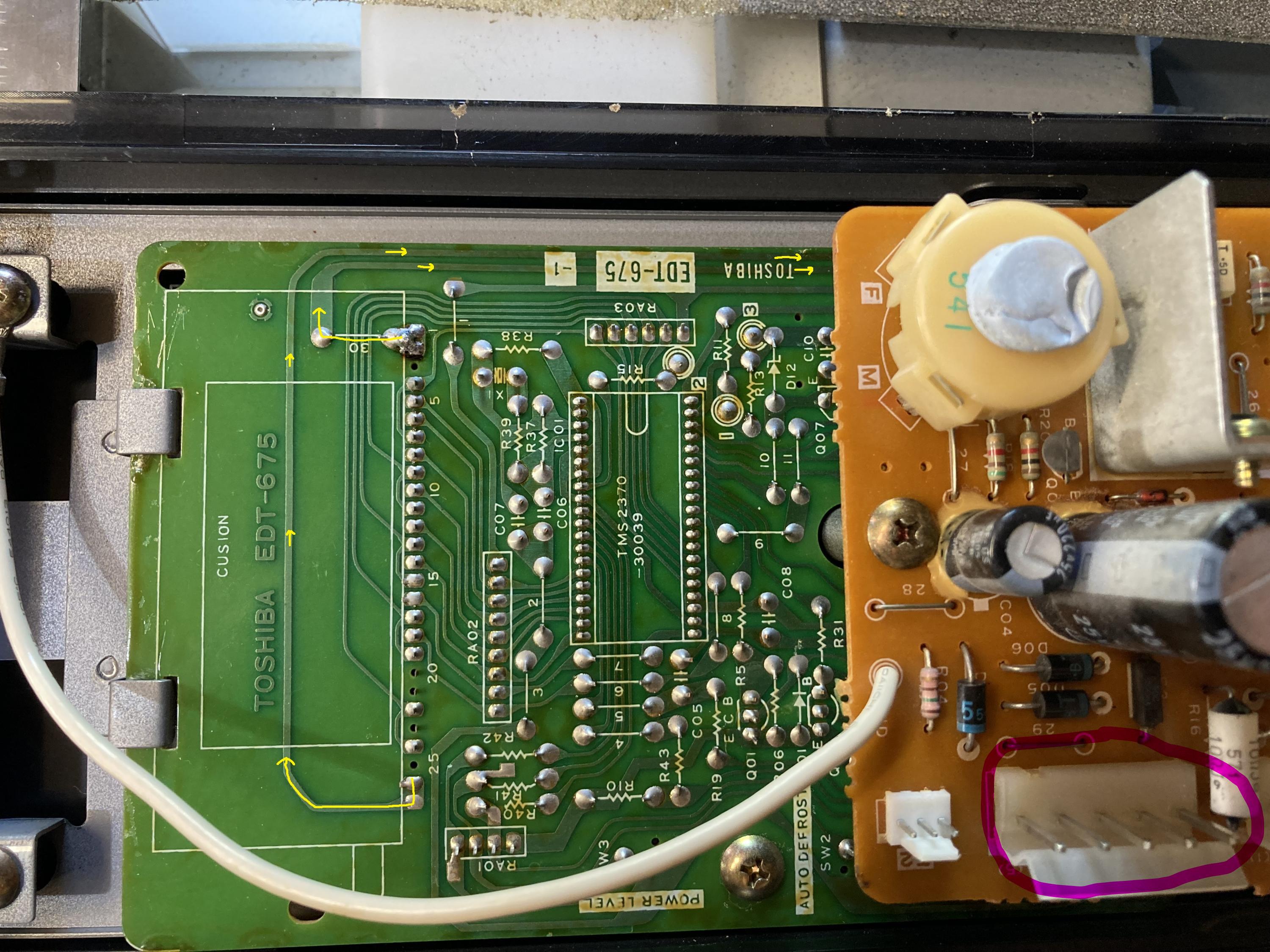

                Well i think i finally found the problem. Re-soldered the main molex connector (circled) that brings power to the boards from the mini-transformer, and fingers crossed the display has been fine for 2 days of normal use now. The solders on the connector looked fine but I guess maybe a hairline crack somewhere? Anyway, thanks again to all for the suggestions and encouragement.
                  Hopefully that's it. I just resolder the entire path for the filaments, end to end because some fractured joints are too hard to see.

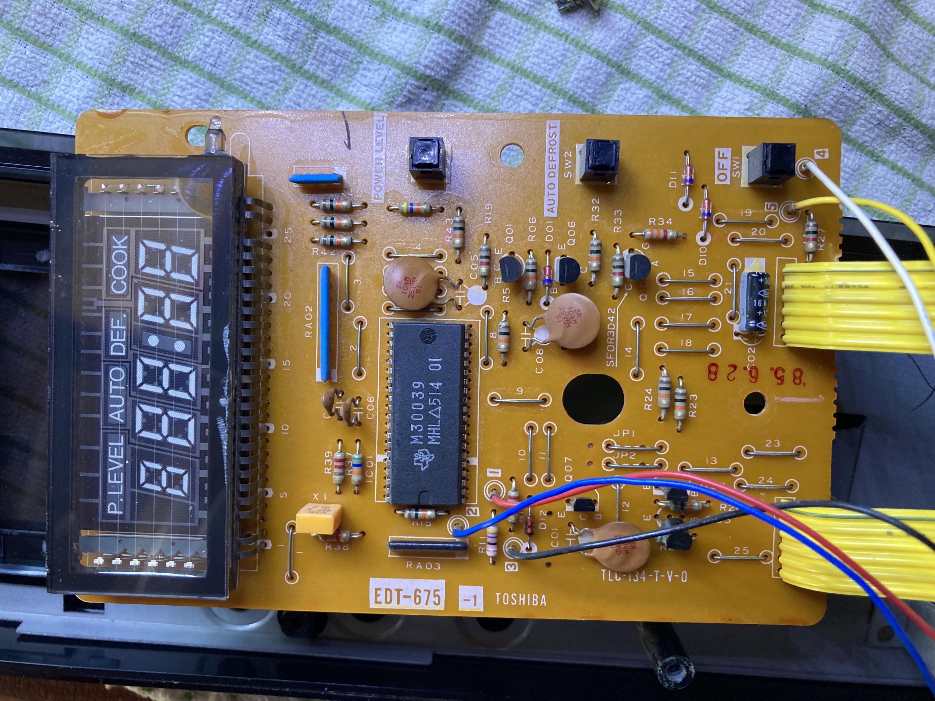

                  How do the two boards connect to one another? That is another place to check.

                    The 2 yellow ribbon cables (pic 1461) are soldered directly to each board. If it plays up again I'll go over these.
