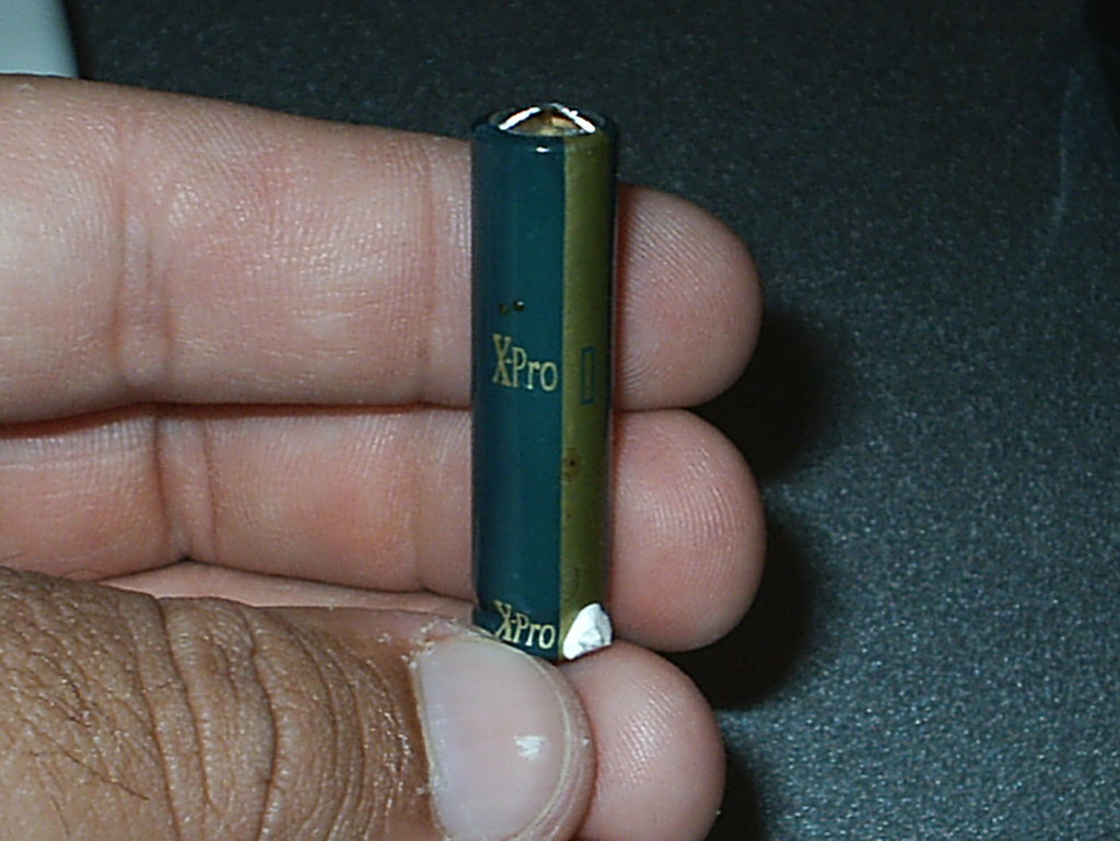

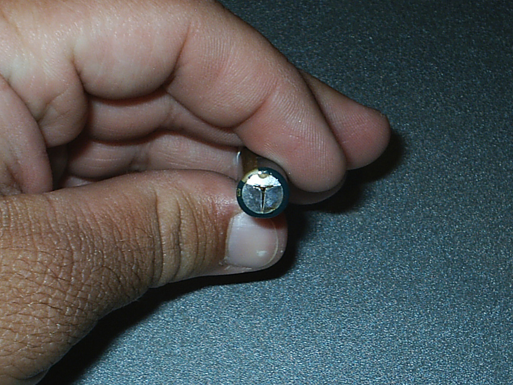

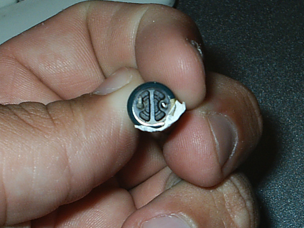

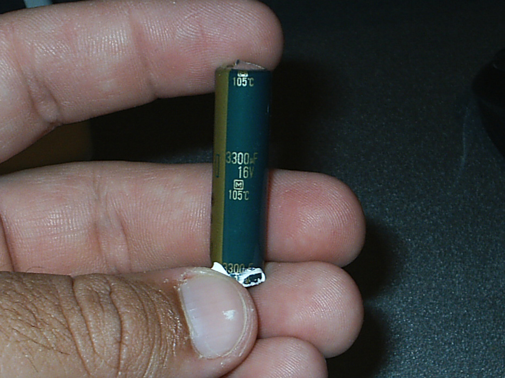

            Re: Physical Dimensions
            Ok here are some pics
            • Scenic
              o.O
              • Sep 2007
              • 2642
              ugh.. those are Panasonic X-Pro "Audio Grade" caps.. (a.k.a. "audiophool caps"..)
              Pureism and X-Pro series Capacitor is made by Panasonic Electronic specially for Audio, with special surface treatment of the alunminium foil , special electrolyte compound and oxygen free copper lead, it give you more clear high end and low end is more firm and more detail, low ESR and high ripple current.
              Due to the high manufacturing cost, the X-pro and Pureism series (Audio Grade capacitor) product by Panasonic (made in Japan) are obsolete for many years.
              no real datasheet available cause Matsushita/Panasonic stopped making them 15+ years ago..
              i'd say Panasonic FC series would be OK to replace those, especially since these are commonly used as sort of "audiophile on a budget" grade caps..
