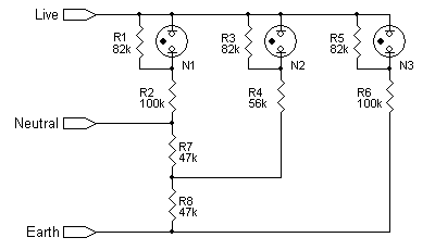

      240VAC Outlet tester using three neon lamps. I'd have to think how to make an LED version, and just leave it plugged in all the time.
      For my workbench I use a RCD, they don't require a ground connection.
        • 31305
        Re: Line filter question
        i think one of those big clive video's has schematics of an led version.
        but whats wrong with neons?

          Neons are fine, I have one tester like that but they need at least 60-75V to light up.
          That's too much for a lamp to earth-ground, you could have 50V and nothin' lit (w/120VAC mains here).
          Modern green LED's are super efficient and could light up with much less voltage I think. I'll check out Big Clive's one and see if it looks ok.

            Not sure why bigclive dissed so much on the transistor current regulator... it will detect those 50V differences where a neon lamp will miss...
            • redwire
              • Dec 2010
              • 3912
              It ran too hot, SOT-23 transistor dissipates 0.25W at 2mA/240VAC and 1/2 wave.
              Almost all of these outlet/socket testers are just lamps in a delta configuration. Although the Fluke has a PIC MCU.
