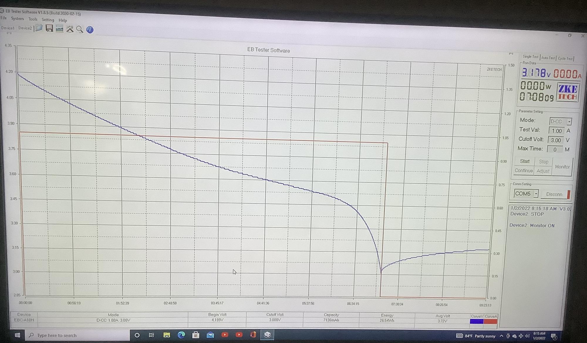

            One note I decided not to test on the new battery tester because of the data code on the battery pack I decided to use the other battery testing machine instead for a more accurate testing results but once I get the batteries matching close to each other then I will put it on the other battery tester and run it at a 8 amp load and see what the results look like
            I have tested a few of these for this pack and they seem to have around 90% life left in them for batteries that have a date code of 2015 on them
            They are suppose to test at 8 amp hours but are testing at around 7.0** to 7.1**something amp hours
            The discharge curve looks good until it reaches the 3.45 volts and drops faster than I would expected it to be it should drop at lower voltage maybe closer to 3.0 would be a lot better
            This discharge curve looks pretty decent for it age still a lot of life in it I tested one for 5 minutes @8 amp load on the testing machine and the results were pretty good at 8 amp load

                Re: SPIM08HP 3.7V 16AH Battery which can handle 200 amp pluses Battery Hookup
                Well I have tested about half of them and the results are as follows
                6800 to 7*** something these batteries are not quite as good as the signal double battery pack cells are but I can still use them but a little disappointed that they are as good and have found that some of the battery cells have a self discharge issue which is going to add to how I group these batteries to make a battery pack
