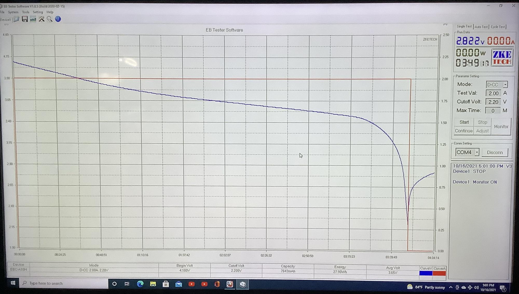

      Re: SPIM08HP 3.7V 16AH Battery which can handle 200 amp pluses Battery Hookup
      Here are the results from the battery testing machine for the battery test that was done on the battery mentioned above
      I would have gotten the same exact results if had charged the battery to 4.2 volts instead 4.1 however I was going out to grocery store shopping so I did not charge it at fast rate up to the 4.2 volts
      I think that these batteries will work very well with the battery operated spot welder that I now have to modify and finish testing the rest of the batteries that I bought for this project
      I am also going to buy four more set of 2 battery cells pre pack and replace the battery in my battery jumper battery pack that the battery when bad it
      What you see on the work table is just one battery cell it comes two battery cells per pack
      Looking at the results from the second battery cell it is looking like it results will be very similar ( to the first one that I tested earlier) that being tested on the SkyRc IMAX b6 battery tester now
      The way I going to set this battery pack is one “P” cell X 3 “S” = 12.6 volt battery pack
