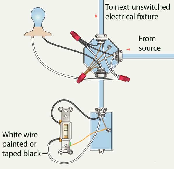

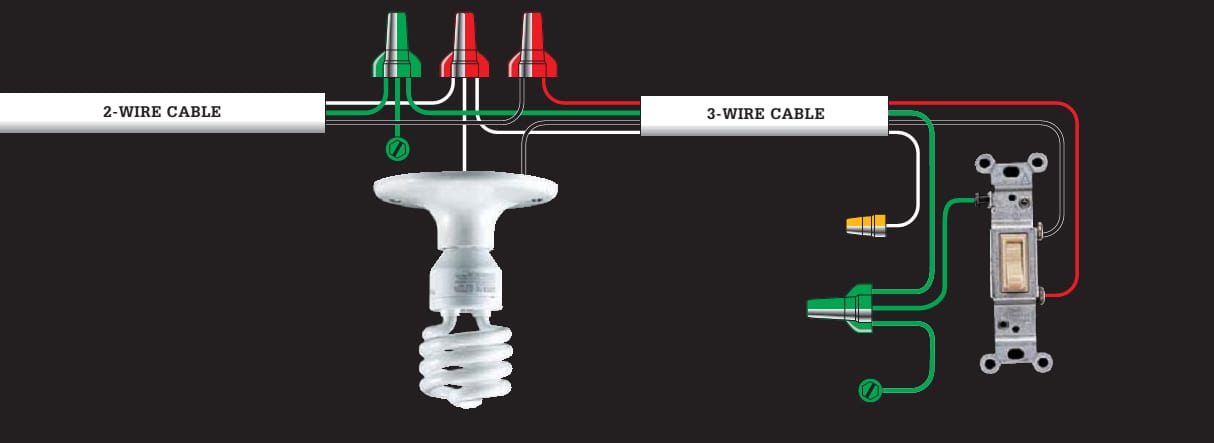

          Originally posted by EasyGoing1
          And apparently in older buildings, it was not normal to bring the neutral wire to each switch in the building.
          Correct, a neutral in a switch box wasn't required until the 2011 revision of the NEC (national electric code), so it is common for "end of circuit" switches (switches where "hot" power runs into the fixture box not the switch box, and then a single wire (with neutral recoded as hot) is run to a switch prior to that to not have a neutral in the switch box. Post 2011 NEC (note: individual states adopt NEC revisions at different rates, so the 2011 code wasn't adopted by every state in 2011, I believe some states are still on the 2008 code even today) an "end of circuit" switch would need to use 3 conductor wire with an incoming and outgoing hot (black/red), neutral (capped with a wire nut if the switch doesn't need it), and ground vs. 2 conductor wire (with neutral recoded as hot) commonly previously used.
          The "old" way of doing an end of circuit switch:
          The post-2011 NEC way of doing an end of circuit switch:
          you cannot use ground .
          Correct, that would be a code violation (which will be a big issue with insurance if anyone is shocked or there is a fire), the correct thing to do would be to bring a neutral to the switch box (generally replacing the existing 2 conductor wire with 3 conductor in the case of an end of circuit switch, though if it is from the original build and not a previous rewire or circuit added after initial construction the wire will be generally stapled to the stud and ceiling joists/trusses, so it may not be as simple as ting a new wire to the old and pulling it through.

                  That is standard if the circuit runs through the switch box (since the neutrals still have to go the the fixture after the switch, I assume by nutted together you mean neutral wire coming into and going out of the box), it is only cases where the power (and neutral) come to the fixture first and then a switch is "tacked on at the end" with a loop of the hot wire going from the fixture, to the switch and back that there is commonly no neutral in the switch box prior to the 2011 code update.
                  My house built in 1988 has a mix of switches where the circuit passes through the switch box (which have a neutral in the box), and "end of circuit" switches where power goes to the fixture first and the switch box only has a single 2 conductor piece of romex (with the white wire recoded as hot) with power coming in and going out on the same romex and thus no neutral (like the diagram in my previous post). In my case it looks like the original electrician just did whatever required less wire based on where the switches and fixtures were in the run (common, since "professional" electricians will often do things the cheapest way possible that meets code).
