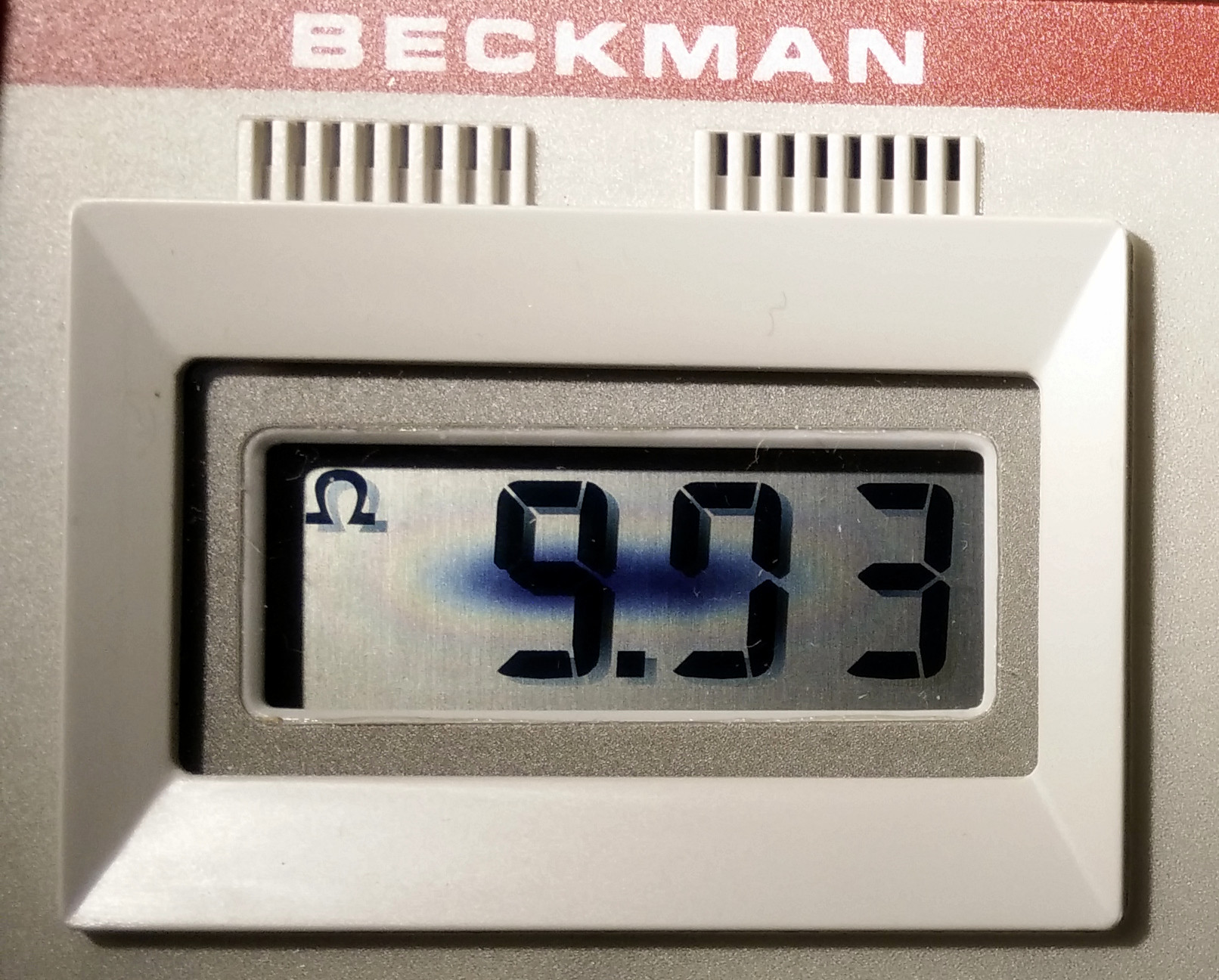

    Anyone know what this strange blob on the multimeter LCD display is? Ideas to repair it?
    Picked up the Beckman TECH 360 bench multimeter from fleabay in new condition. It's just been sitting in storage.
    I thought a polarizing film or heat, but the G segment looks dead on a digit.

    that can be caused by heat - it's in the glass.
    the digit is potentially another issue.
    have you stripped it yet to see how it's built?

      It looks like this display has been subjected to uneven heat or something was up against part of the display
      Try putting the display in the sun and wait for the display to turn black and let cool down evenly and maybe it will be better if not then the display is ruined because of age I have seen this before but normal start on one of the edges and grows to the center of the display
      On the digit that not all the segments are there put a little pressure on the display where it is missing and see if appears if so the display is separating and no hope for it if it does not appear then something is wrong with the ic chip that controls the display
      Or the bounding wires that are incased in the glass have separated and the display is really going bad I have seen this as well or if the display is on a ribbon connector is not make a good connection or if it is in a ic socket holder it not making a good connection either

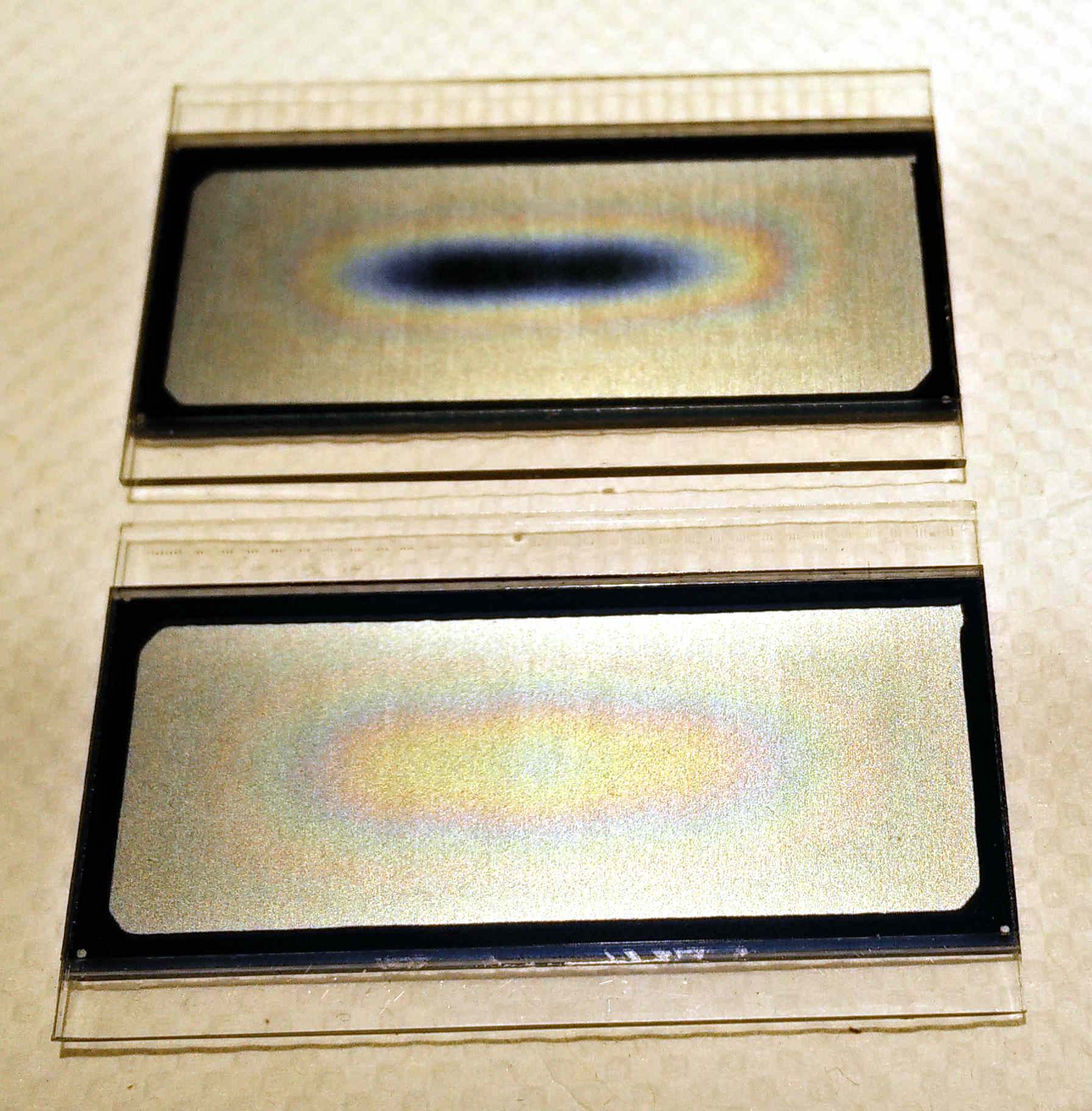

                I grabbed a spare Beckman LCD I have and unfortunately it shows the same LCD rot has started. Both displays are old, the one with a blotch is REVB 09/81, and the other is REVC 02/1982. It's not due to heat in use or storage.
                The problem seems to be the polarizer aging and going bad.
                The LCD display is a sandwich of two glass sheets, with reflective aluminum backing that likely has the polarizer on it? I haven't taken it apart.
                I've ordered a NOS 1991 part and will see how that does.
