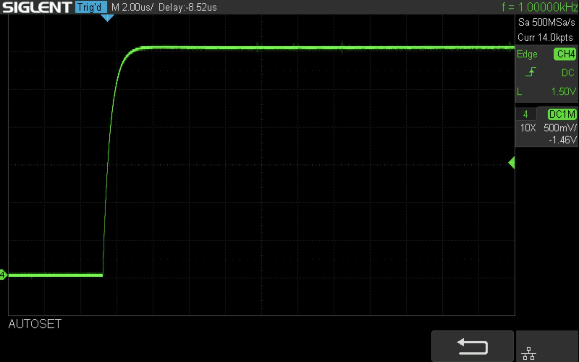

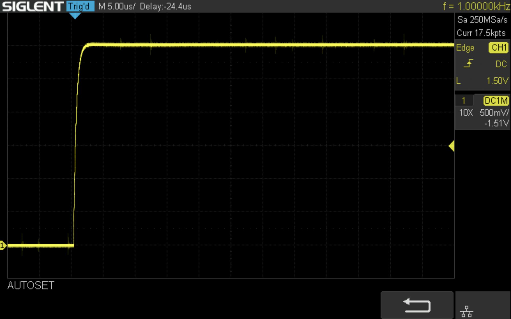

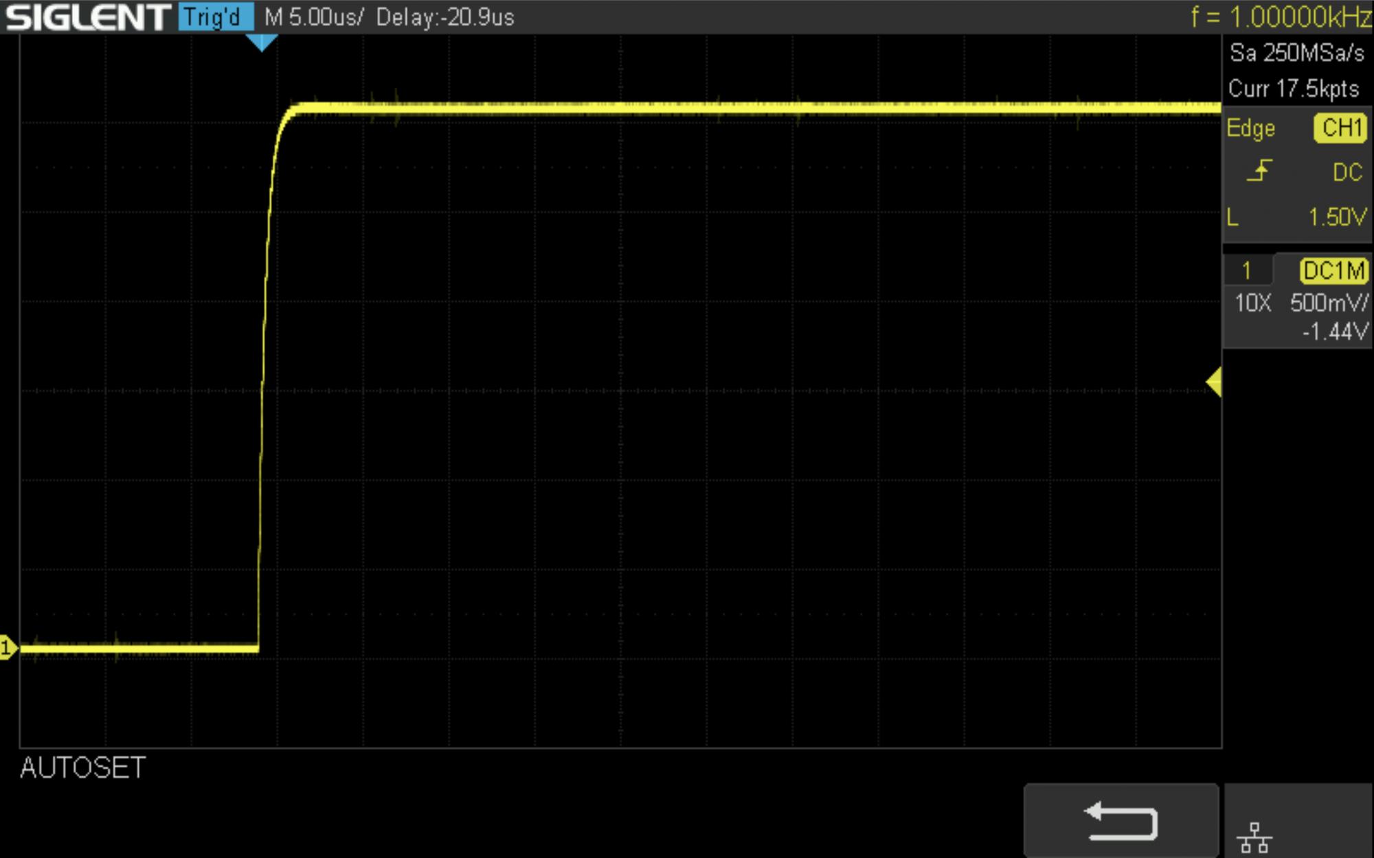

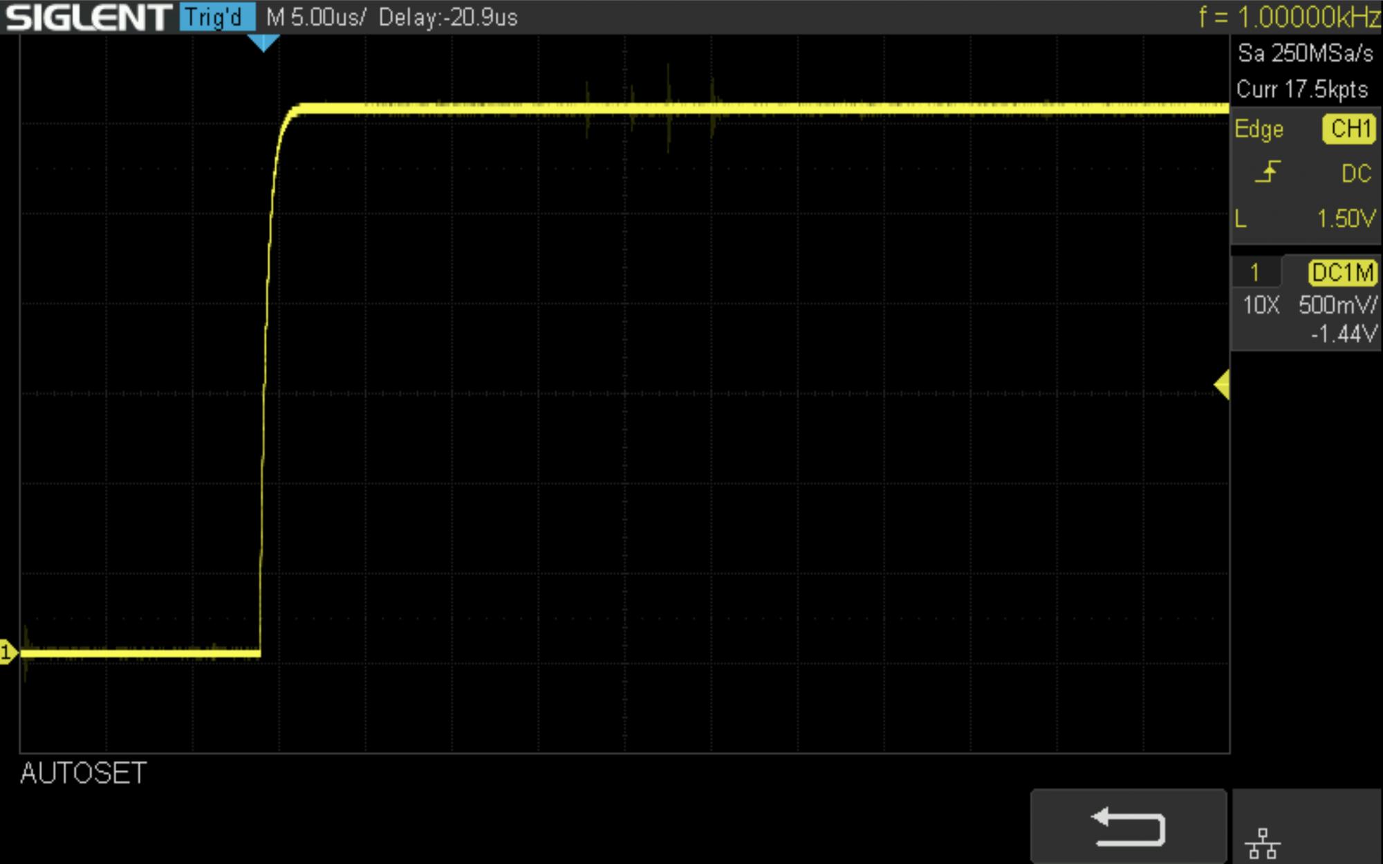

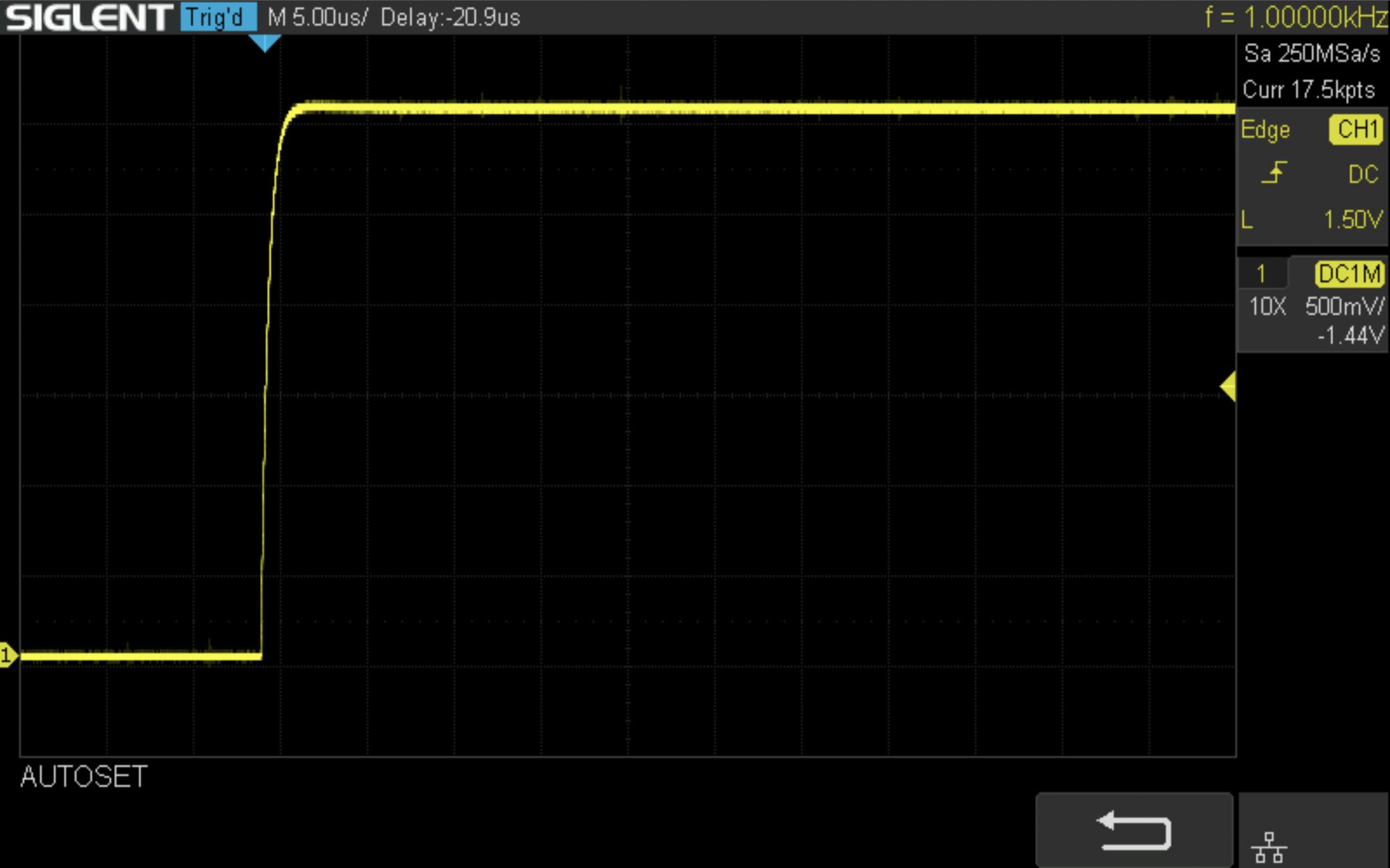

                          If I had any complaints about this unit so far, it would be the test leads. Some seem to be noisier than others...
                          For example, if you look at this graphic, you will have to zoom in and look at the horizontal line, but you can see how the different probes have more noise on them than others. These were taken from each different channel each probe on its own channel.
                          This image was all taken from channel 1, but I just swapped out the probes
                          And if it's too hard to see, I uploaded each original screen shot as well.
                          sigpic
                            • 31199
                            #33
                            Re: Oscilliscopes
                            move the x1-x10 switches a few times incase they have any oxide or grease between the contacts
                            • EasyGoing1
                              Shock Therapist
                              • Sep 2016
                              • 977
                              #34
                              Re: Oscilliscopes
                              You know ... that actually did help... the yellow probe has certainly settled down a lot after doing that to where I can almost not see any noise in the horizontal lines ... there is still some there but it's very faint. I assume maybe over time it might go away completely?

                                how much is it of you zoom?
                                you will always get some level of noise because of the components in the signal path.

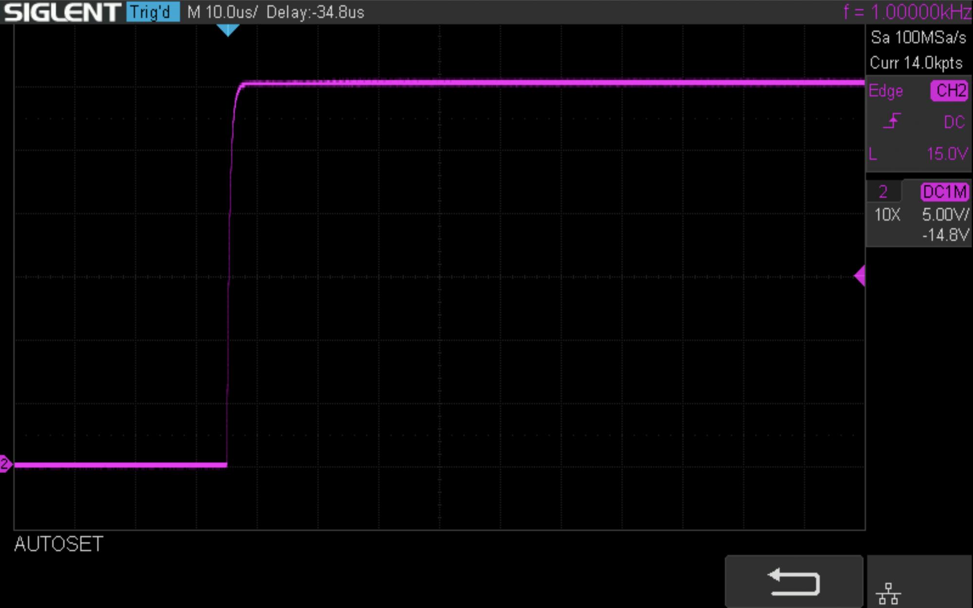

                                  OK, for some contrast, here is a video I took right after unpacking it and setting it up. This is from channel 4 - green probe.
                                  And here is a video I took just now. Same tests signal, same channel, same probe.
                                  I still see noise in the horizontal lines ... is it normal?
                                  sigpic
                                  • EasyGoing1
                                    Shock Therapist
                                    • Sep 2016
                                    • 977
                                    #37
                                    Re: Oscilliscopes
                                    Those videos were taken while connected to the front of the scope using the test signal and pressing the auto setup button, then I only zoomed horizontal two steps.
                                    sigpic
                                      • 31199
                                      #38
                                      Re: Oscilliscopes
                                      oh - if your using the testpoint - dont use the ground clip - you create a groundloop.
                                      the probe is already grounded to the scope at the bnc
                                        • 31199
                                        #39
                                        Re: Oscilliscopes
                                        looked at the vid, not sure the size of those spikes but they are super short - it could be noise from nearby equipment.
                                        • EasyGoing1
                                          Shock Therapist
                                          • Sep 2016
                                          • 977
                                          #40
                                          Re: Oscilliscopes
                                          OK, THATS interesting ... sitting right next to it is my port replicator for my Macbook pro and then of course the MacBook pro is right next to that... ill move the scope and check it out.
