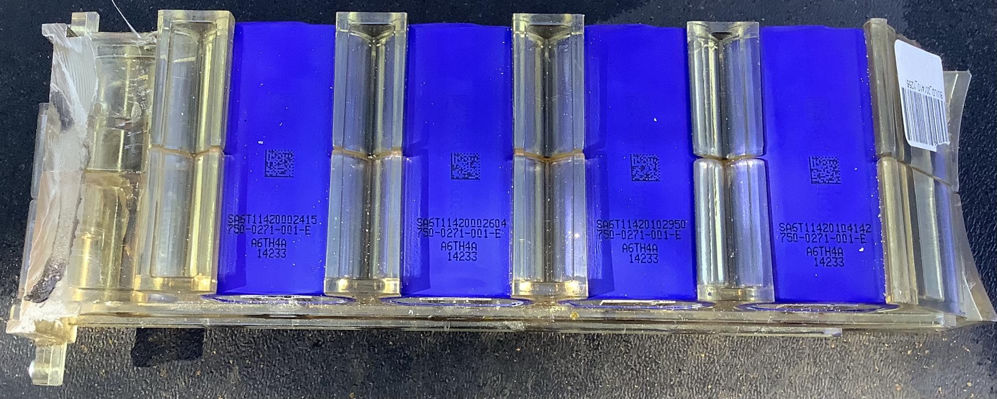

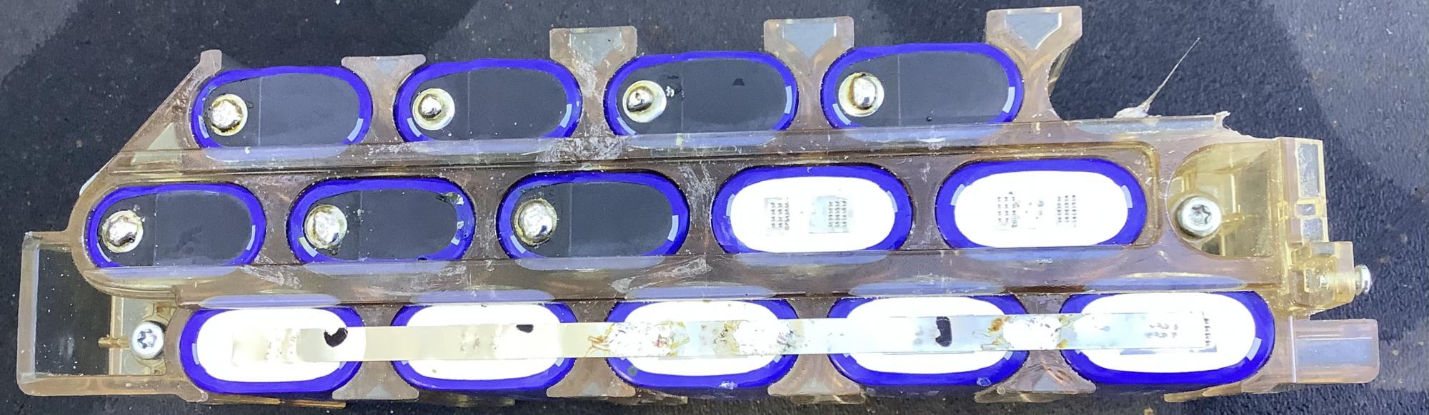

    I have wanted to do this project for over a year now but I had to prove that the concept would work correctly
    The problem with this Black-Web battery pack was the running time on this battery pack sucked but for the fact that it is one of a few battery packs that I have that would deliver 2 amps to my tablet when charging this is only reason for doing this project ( most battery packs would be lucky to put out 1.5 amp )

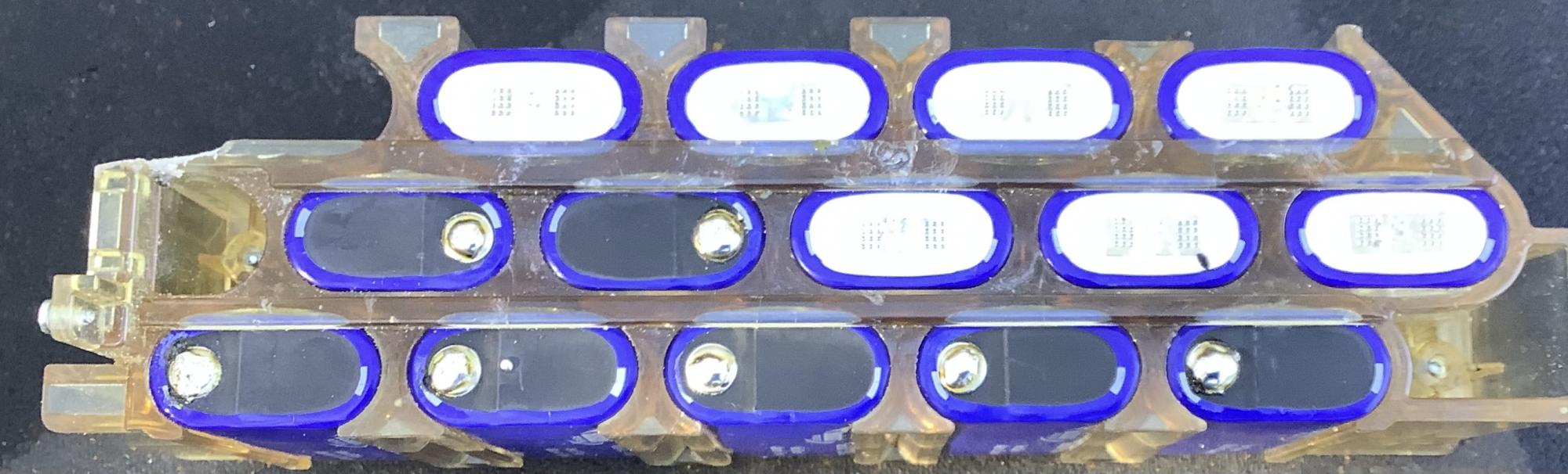

    I am using 7 batteries in parallel in one battery bank with two battery banks in series for a total of 14 batteries
    ( This Black-Web battery power module uses 8.4 volts for the module to work )

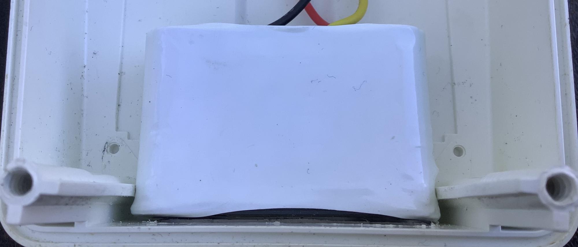

    I took a case that Bosten Power Sonata 5300 battery case that battery came in took out the BMS balancing protection board out of it
    It comes with 15 batteries but because of way my setup is I had to remove one of the batteries so both side would be balanced
    I have calculated that the amp hours of this battery pack is about or a little bit over 35 amp hours

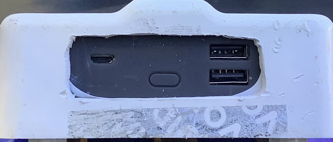

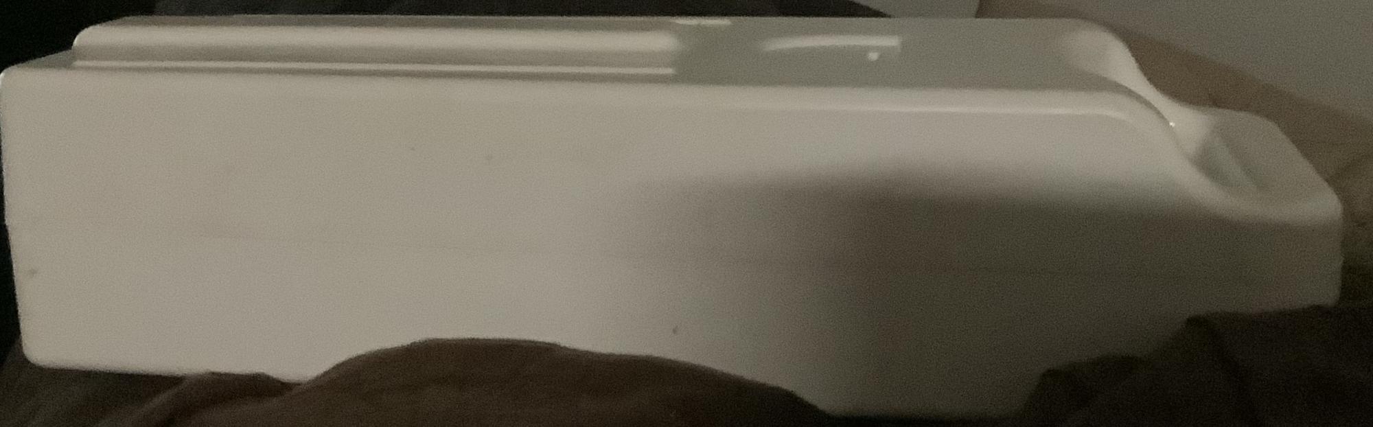

    Cutting the battery case so that the battery power module would fit took so doing but it came out better than I expected it to I am very pleased with the results of how this project came out

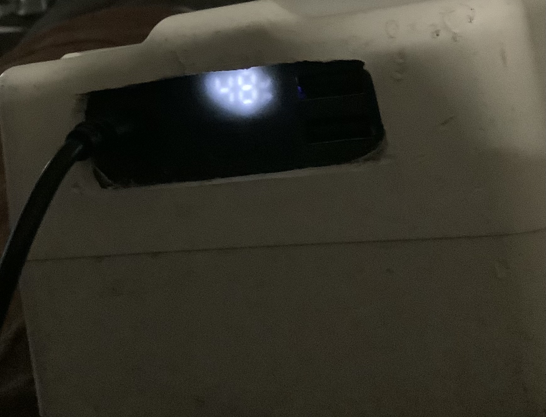

    The only down side of this type of high capacity battery bank is how long it going to take to charge it up
    I have estimated that it might take 2 days to fully charged because it been on charge for about an hour and the percentage of started 48% and it still shows 48% ( the charging current is 1.85 )

    Update
    The battery pack charged over night and now it is at 97% but I have had to reboot the battery pack module several times because it shows 100% but it still charging and it reset the percentage counter to a lower value and the charging current has also fallen quite a bit from 1.85 amps to 800 milliamperes but still charging
    I want to show 100% when it is finished charging and not before

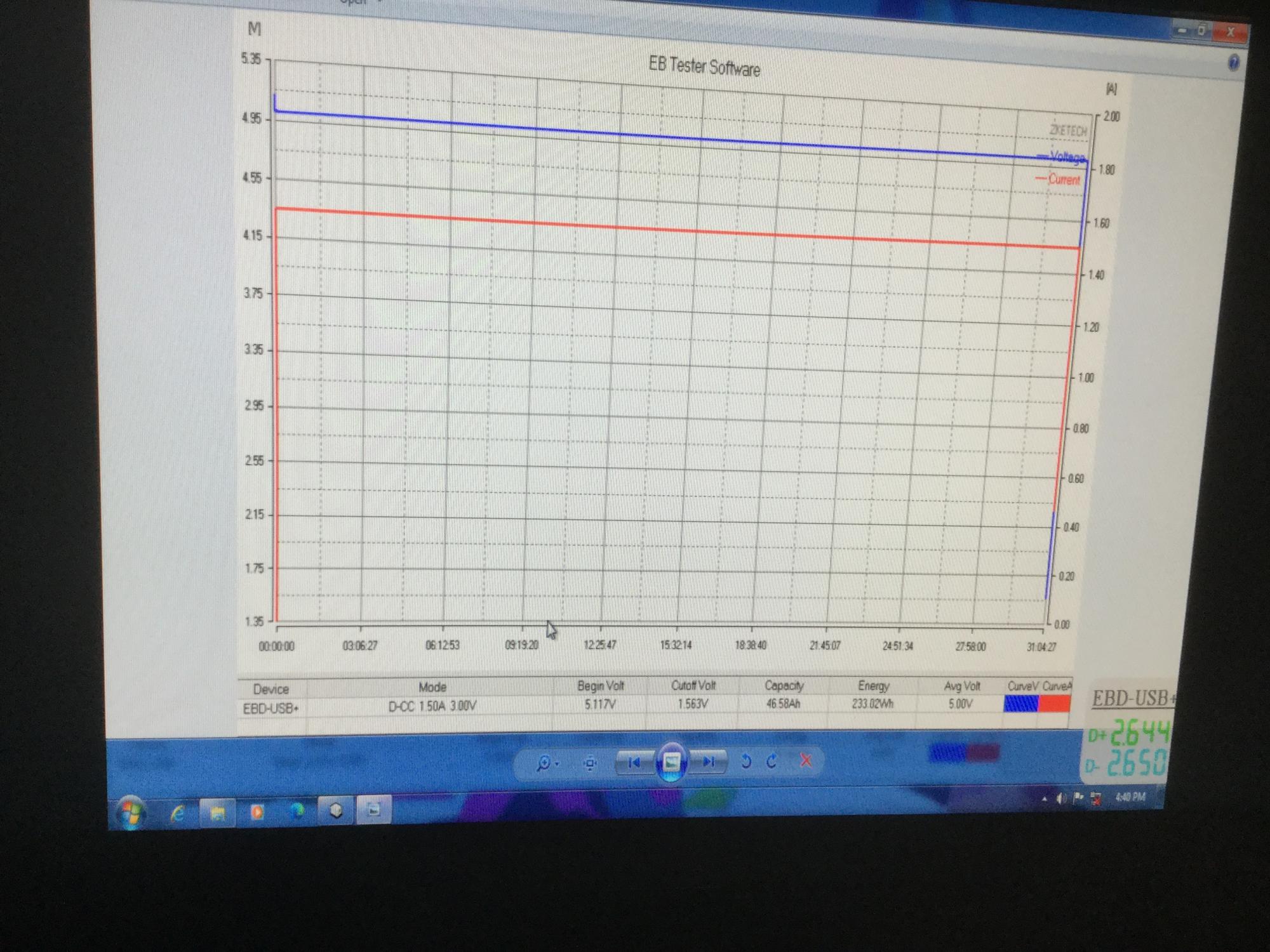

          Well the battery pack ran for 31 hours @ 1.5 amp load ( amp hours 46.58 ) until the battery pack module turned off
          I am very pleased with the results of this test
          As you can see in the photo below the results of the load test on this battery pack
          Please do not pay attention to the meter screen on very bottom right hand side of this picture because I running another test while it is charging
