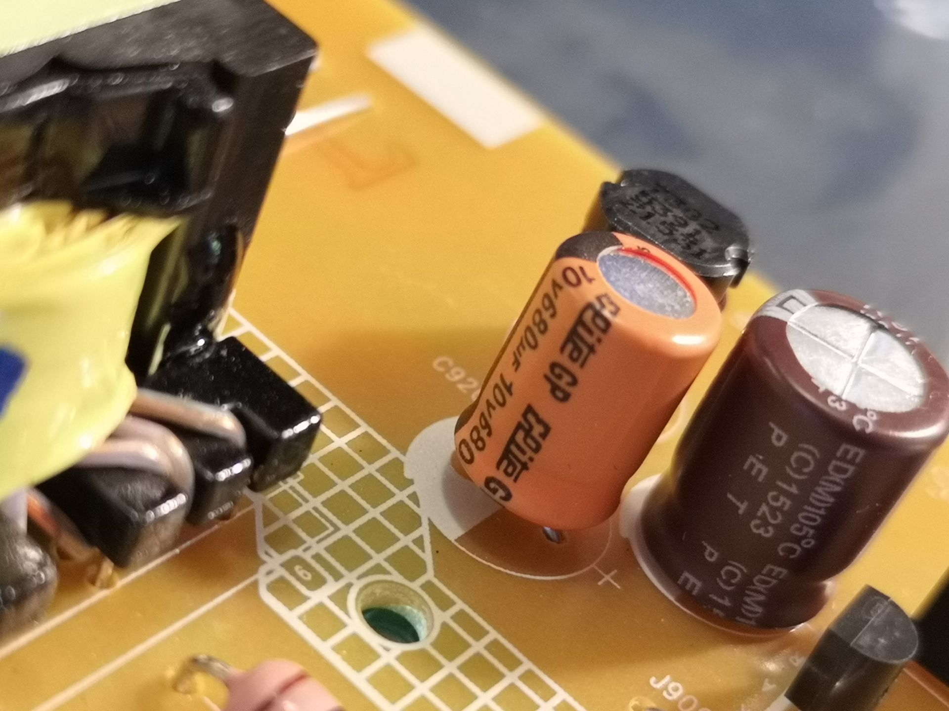

    I'm working on a monitor powersupply and I'm trying to source the Elite GP series datasheet so I can replace the caps with better ones.
    Elite's homepage don't have the GP series listed and I can't find it anywhere else either.
    If it matters the other Elite cap next to it is an ED series with low esr and high ripple current capability.
    Can you help ?

    what is the temperature rating?

      The GP cap is marked as 165 and the the ED cap is 105.

          It might be that one - I took the GP cap off and esr measures 0.02-0.03 , case size is correct but temperature markings is not if it's the actually temperature we see on this cap.
          I think the cap is ok, so I will solder it back in.

            When it comes to caps on SMPS, particularly on LCD monitors, I hardly ever bother to look in datasheets anymore. For SMPS, you generally need just good entry-level to mid-grade low-ESR caps with long life (due to many monitors running very hot inside.)
            Usually, the likes of Panasonic FC, United Chemicon KY & LXZ, Rubycon YXJ, along with Nichicon PW, PS, PM, PJ, & HE tend to be my standard choices. If not, I go a little lower with the ESR.
