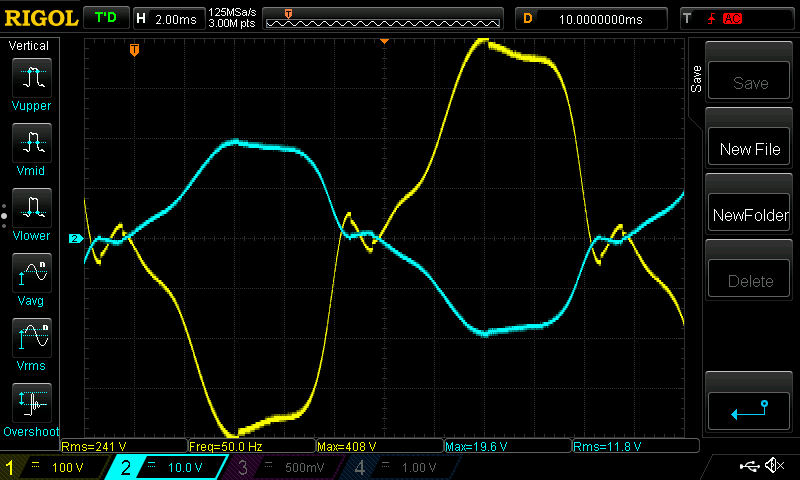

                  Re: Back to Back Transformers
                  I've attached an image from my scope.
                  This was captured with no load.
                  Yellow trace is connected to the output transformer.
                  Blue trace is connected to the 12V side.
                  I don't seem to be getting a great waveform is this to be expected using transformer's back to back.

                    #29
                    yeah that would do it, those little blips would cause you to get 100Hz.
                      The squiggle at zero-cross which is making your multimeter read double-frequency, I think is from the power meter's internal power supply (capacitive-dropper). If you disconnect the meter's power it would prove it. Having a small AC load also gets rid of it.
                      You might not have the transformers quite right.
                      If you overdrive the last transformer, let's say it is a 6VAC winding being fed 12VAC, its core will be saturating on the peaks. If everything runs hot with no load then this is likely the case.
                      You could connect the isolation transformer unit backwards (feed mains into the output, have a fuse) and see what symmetry you get on the waveforms.
                      Connecting transformers back-back usually gives meh results because transformers are overwound to make up for their losses. They are actually made as a 10-20% higher output voltage part which then sags under full load.

                          #32
                          The transformers do get hot after a while with no load especially the input transformer. I think when I was testing before I got more of a voltage drop with them the other way around.
                          Disconnecting the meter does improve the waveform.
                          it might have worked better with matched transformers
                          I agree but finding two the same is not easy when trying to do it on the cheap, as this is only a hobby for myself.
                            That's not a good sign that they're getting hot with no load... oh well, depends on how long you keep it connected and idling, I guess?
                            I have a bona fide 300W iso transformer, it gets a little warm, but not hot.
