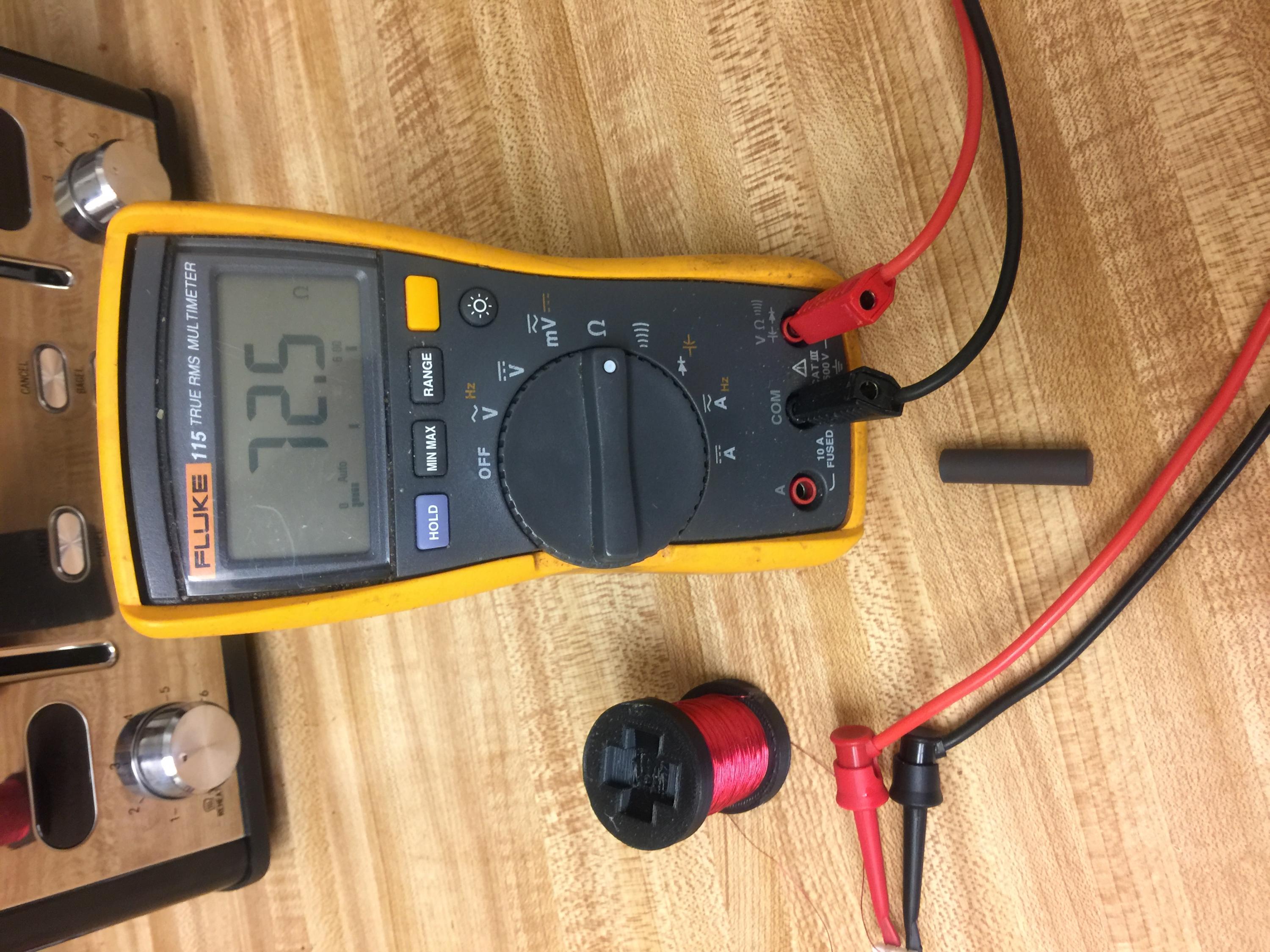

                            Well, I'm trying to determine how to choose the coils ... since I'm going to go with a 4 coil design, flux density matters, does it not? I'm thinking that I'm going to be magnetizing two coils at a time, one for each end of the magnetic pill inside the liquid. Current in one coil will flow one direction while the opposite coil will flow the opposite direction (one for the North end of the pill and one for the South end of the pill). Then those coils will be turned off and the second set will be turned on with the same current flow. Then, simply repeat that pattern only with reverse currents in each coil. This would create four steps for the Arduino that would simply be repeated by some kind of timing.
                            If the flux density is strong enough, then it should spin the pill.

                            I spent some time on Mouser, looking for coils that are arranged in a spool like that (similar in look to a sewing thread spool) but I can't seem to find them, nor do I know what they are called ... any idea on that?

                              You may find that you turn 2 on, then 4 on, then 2 on, etc.
                              Code:
                              1 ++.---.++
                              2 .+++.---.
                              3 --.+++.--
                              4 .---.+++.
                              I.e., the equivalent of half-stepping a stepper motor. This allows you to keep "control" over the armature, better (not requiring it to "jump" as far between steps).

                                  Now I'm wondering ... if all four coils shared a common ground, then I connected the remaining leads to a stepper motor driver like a DRV8825 ... I wonder if I could simply use it to control the spin. The DRV8825 is a wonderful stepper motor driver, Ive used it in a few different projects. It allows you to connect anywhere from 12 to 36 volts as the source voltage for the stepper control pins ... and it has a trim pot for current control.
                                  That would depend on the design of the driver. (you can drive a stepper motor many different ways).
                                  I *think* you want to be able to drive each coil in either polarity (some stepper drivers only offer a choice of "on" and "off" for each coil).
                                  And, you also want to be able to "half-step" (the example I've given).
                                  I prefer to drive motor coils individually with an MCU. This gives you greater control (think: acceleration, braking, back-emf sensing) over the motor -- instead of a "textbook" approach (that ignores the Real World).
                                  But, if you have one handy, just TRY it! You don't need to introduce a liquid (and container); just suspend your "stirrer" over the magnets with a fine thread, for starters.

                                        So I decided, since I couldn't figure out with any kind of certainty - what kind of coil to purchase, I figured I would just make one and experiment with it and if I can generate the kind of magnetic field that I believe I'll need, then I'll make three more and keep going on this project.
                                        I bought a pound of inductor wire on Amazon, then I bought some Ferrite cores on eBay ... then I printed what I needed to construct a spool and I modified a device I built that that I use to make vape coils so I could wind the wire onto the spool. I figured since I need four coils, I'd make each one ΒΌ pound... Anyway, this is what I ended up with as my first prototype:
                                        Now, I figured that I would probably need at least an amp or more to go through this coil to generate any kind of useful magnetic field for this application. But as you can see, the coil ohms out at 72.5 ohms which means that to get a full amp, I'll need 72.5 volts. BUT, the strongest DC power supply that I have is only 38 volts and when I put 38 volts on the coil, the magnetic field doesn't seem very strong to me.
                                        I've seen voltage step up converters on Amazon ... kinda like ... reverse Buck converters I guess ... and they have some that will go up to 90 volts from like 30 ...
                                        But something doesn't quite "feel" right ... I can't put my finger on it... so I'm back in here seeking input.
                                        Should I be looking to feed as much voltage as I can into this coil, or is there some other way to drive it so that I can get a good field out of it?
                                        The ferrite core is 32mm long by 8mm in diameter. The wire that I bought is 30 AWG Magnet Wire - Enameled Copper Wire - Enameled Magnet Winding Wire.
