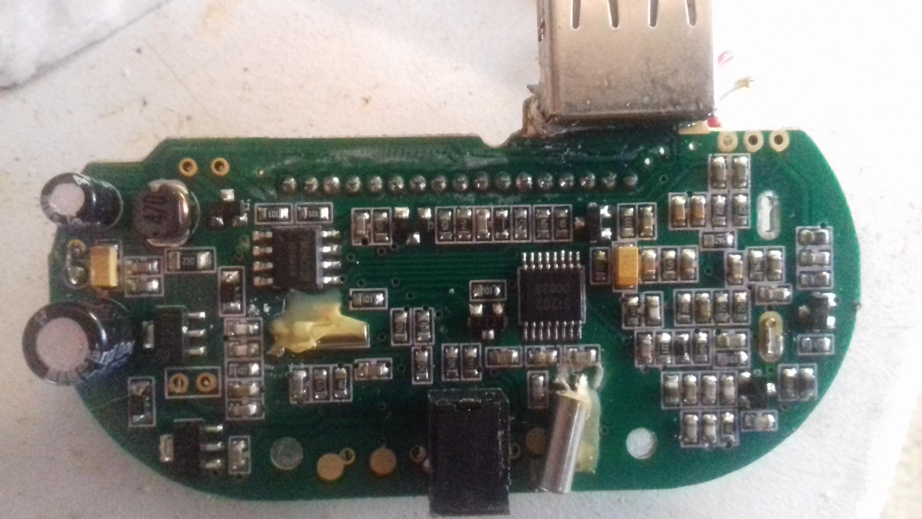

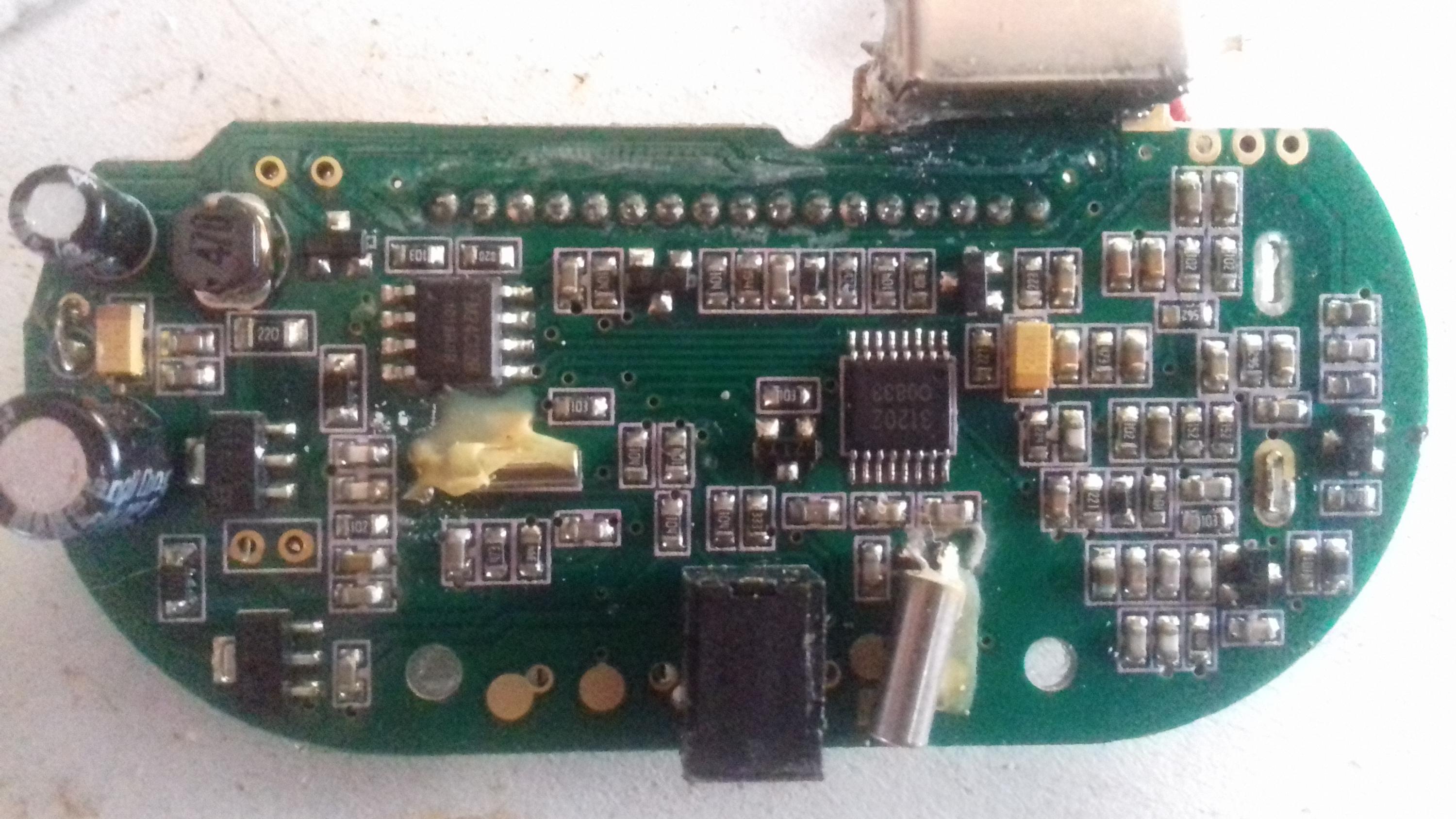

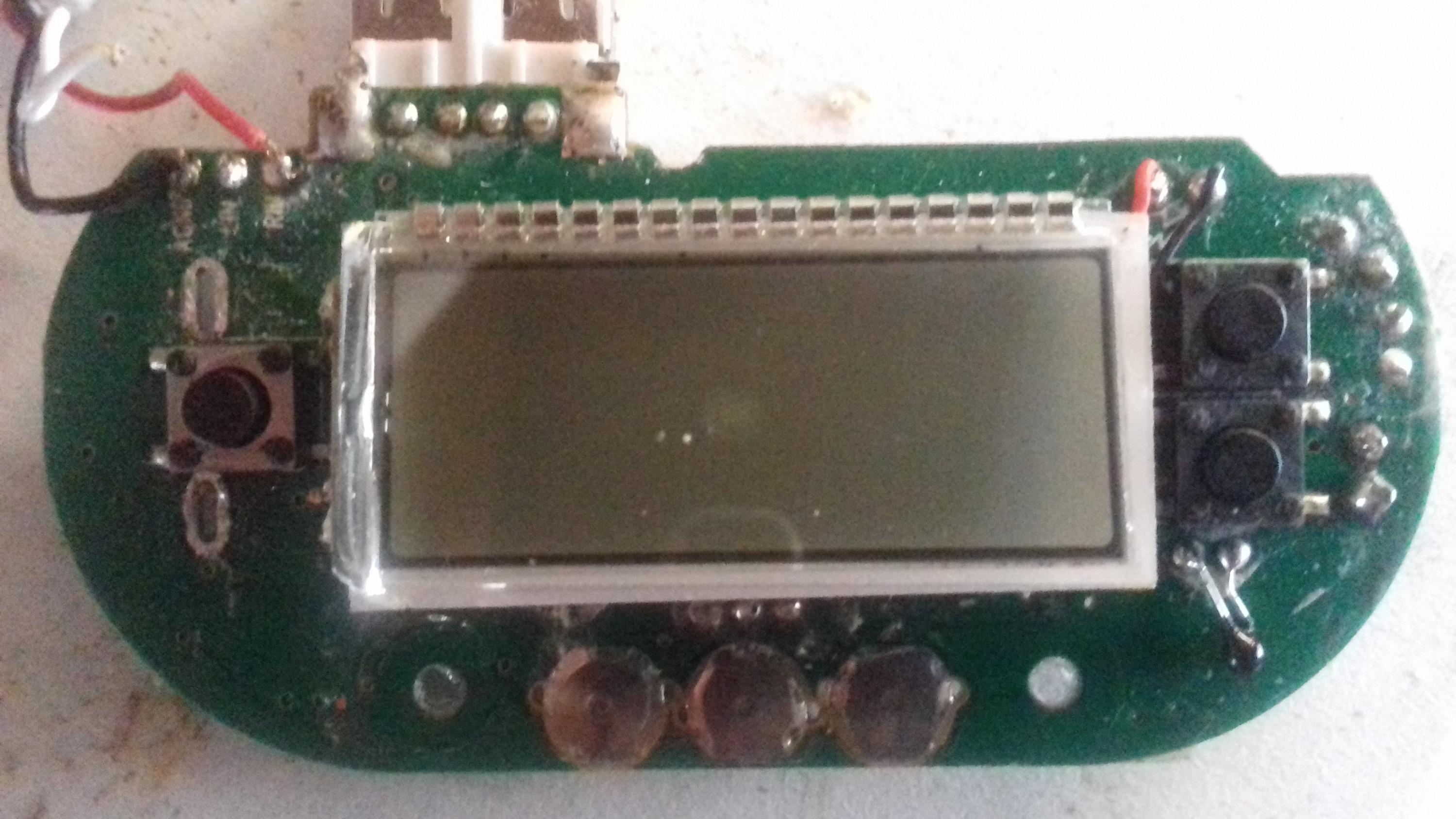

    trying to figure out where to connect an external antenna to this fm transmitter . i doubled up on pics in case 1 of each was better than the others .

    Re: fm transmitter connect antenna ?
    They typically use the headphone-in cable for the antenna.
    I think the FM transmitter PA is on the far edge of the board, it seems to connect to the headphone AGND pad. If you follow the SOT-23 transistor at the far edge.
    I couldn't find datasheets on the 31202 IC.

      http://www.chipdocs.com/datasheets/d...a/TB31202.html
        i found some that have an extra wire for the antenna a blue wire . and some that have the antenna etched on the board .this one has neither of those so it threw me as to where to connect and if i need to remove an attenuator or not . .
          The output of the 31202 should be pin9, follow that pin to the next transistor
            i just checked and right now pin 9 doesn't seem to connect to anything . i went through everything on the same side of the board . . i dont see any transistors on the other side .
            making me wonder if the antenna is maybe under the ic .
              That should be the output of the pll ic, it is very likely coupled to the next circuit with a small cap, so it might be hard to trace, it wont be directly connected to the next circuit. That ic output is not a power output so it won't be connected to the antenna but to the input of the output section.
                i tried to absolutely everything from that pin 9 thats opposite diagonally from the dot . no beep on anything . i know its a bit strange . i randomly tried from other pins in case its coated with something but no problem tracing those pins with my meter . i will check again . i dont really want to be removing the ic to look at the traces .
                  just checked again a few times and not finding where it goes to . i can trace the other pins no problem ... i know it has to connect to somewhere or it wont work .
                      looks same as the one i already posted ... i still cant find continuity from pin 9 to anything .

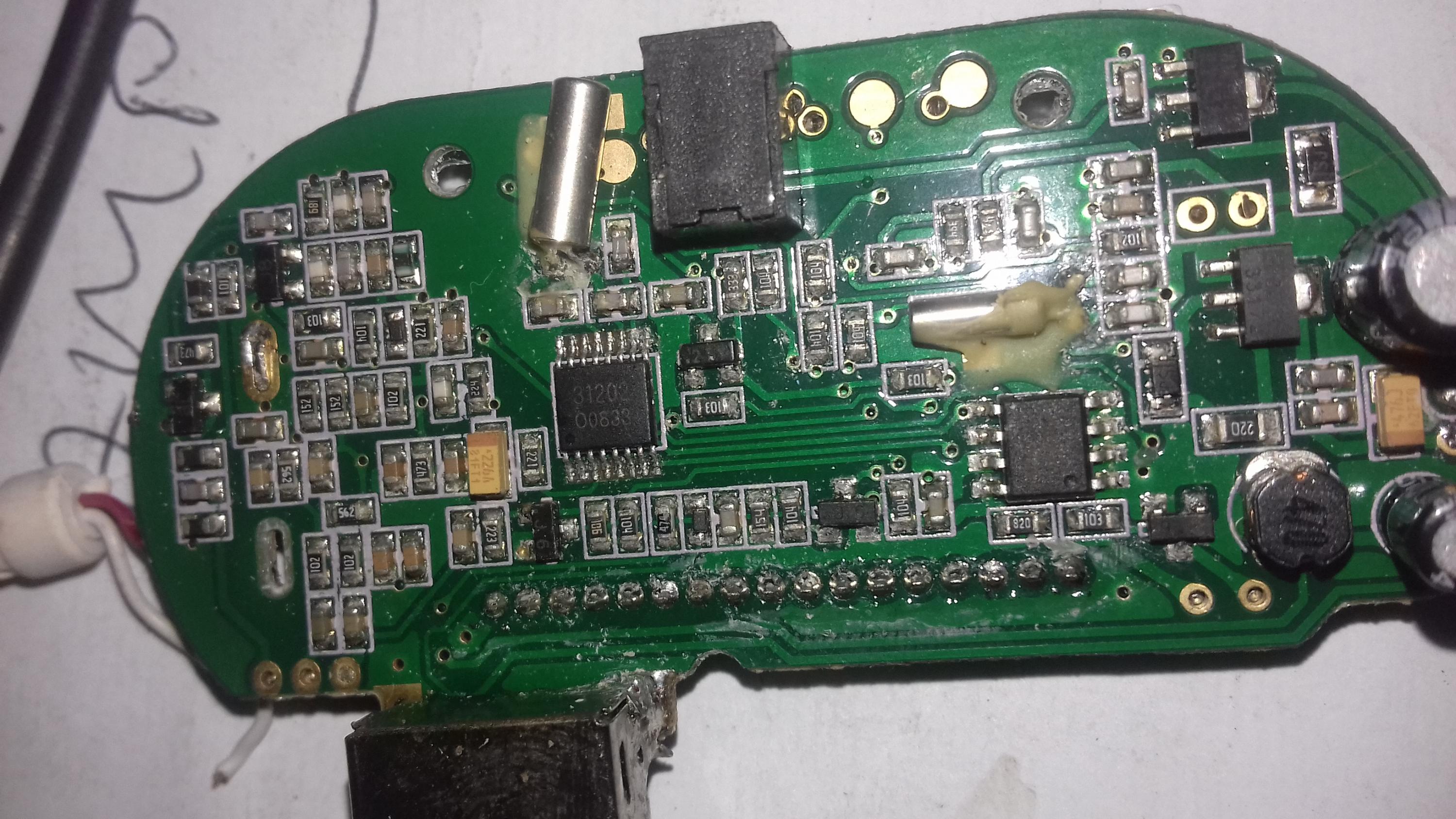

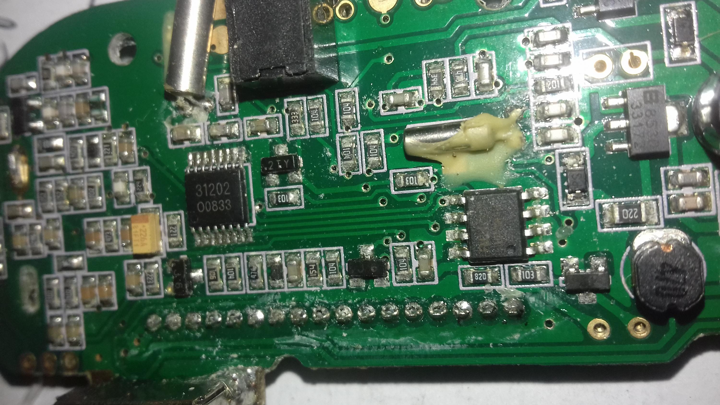

                        2 better pics that can be zoomed in

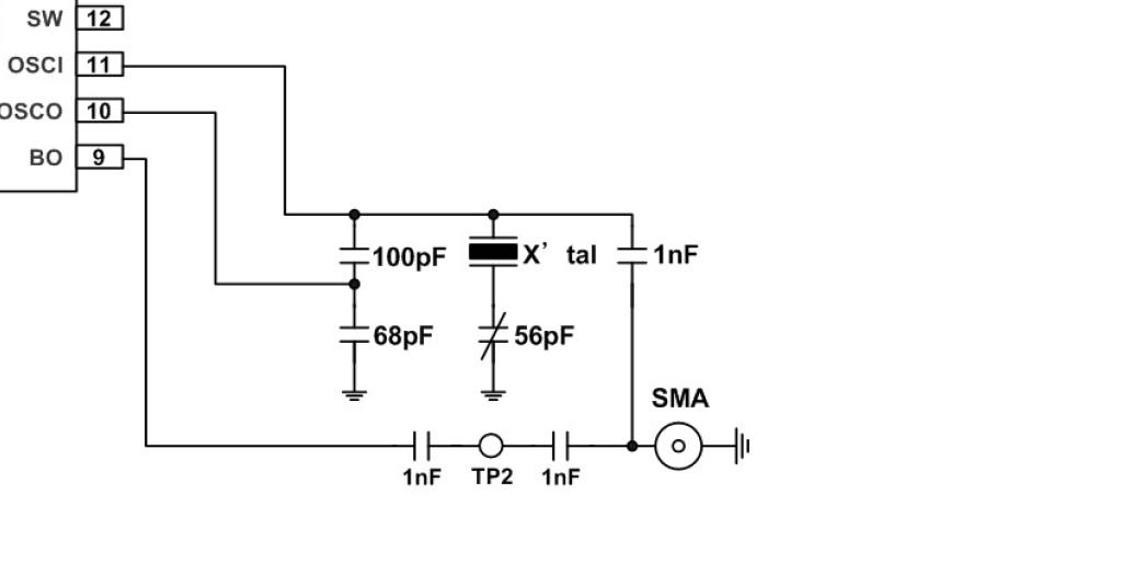

                          here are a couple similar schematics.
                            is that using pin 3 charge pump 1 for out to amp circuit ?
                              Every diagram I look at is different, this is just the rf drive, the modulation will enter somewhere else.
                                i don't see any coils on this thing unless they are hiding in smd components .. i would have expected to see open coils and 1 to antenna . still cant see whats used as an antenna .it must have one must it not ?
                                  This is a simple low power device, it likely only has one small transistor for the final output. They could use a small cap to couple the r.f. to the dc input wire, audio input wire, a piece of tinfoil in the case.
                                  What was connected to the two elongated holes in the baord?
                                    the batteries connect there .
                                      The SMT inductors are dark gray or green, caps are brown or white. Pin 9 must have a via or trace under the IC which then heads over to the RF power amp.
                                      I see the RF power amp as the two transistors at the edge. Note circuit AGND pad connects to the pcb ground pour through the inductor, not directly.
                                      So what I would do is use the AGND pad for the antenna connection, and connect incoming signal GND to the main ground pour.
                                        pin 9 isnt connected to anything . i have checked a few times now .
