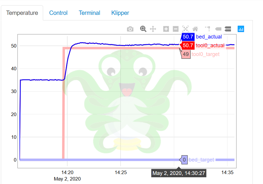

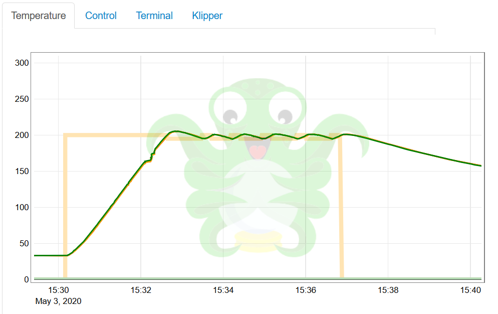

          CG: I spent yesterday changing the pid values and observing. I came to the conclusion that it would be a whole lot easier to just run one of the halogen lights and use the resistive heaters as boost only for high temps. Ran a pid tune on the lower halogen heater, and ran some 10 minute cycles. The halogens overshot by 1-2C and settled pretty much solid at 1-2C over target. I'm ok with that for now. Also did some testing, opening the door, a few times, the algorithm corrected quickly, no issues. I also checked temperatures front, back, top, bottom, side to side, and it's remarkably uniform. No more than 1C variation anywhere. My meter measured 47-48C when the system showed 51C. The variation could easily be error in the thermocouples.
          Otherwise, I wrote some python scripts to generate my profiles, the gcode didn't react quite the way I expected it to, so there's some long stretches of "dwell for 5 seconds", "display temp" repeat. I put it through enough cycles to have some confidence that it's not going to go completely haywire, it will perform according to expected parameters.
          I also found a plugin to enhance the graphing in octoprint. Pretty nice. Pic attached.

            Welcome to the joys of loop tuning! You will discover that it can be really frustrating as you're never sure if what you're doing is making things BETTER, or WORSE. It's ART more than SCIENCE.
            Note that, to a certain extent, you can limit the number and frequency of such "disturbances". E.g., when you bake a cake, you don't keep opening the door just to see how it looks!

                                  At full blast, 2 minutes 22 sec from room temp to 200C. 190C temp rise is about 1.3C per second, straight slope, no lagging at the top either. SSR heat sink was warm, definitely not hot. No popped breaker. Looks like green light for a reflow profile.

                                    Just let me say I really like your setup and you gave some ideas
                                    The only problem that I see if you cycle the light a lot like that the bulb might not last very long just keep this in mind
                                    I going to use this setup but I going to use a high amperage SCR controller and adjusting the amount of current to the light bulb just keep it warm and at steady temperature
                                    And see how well I can maintain the temperature doing this way
                                    I not saying that my concept will work or not but I going to give it a try
