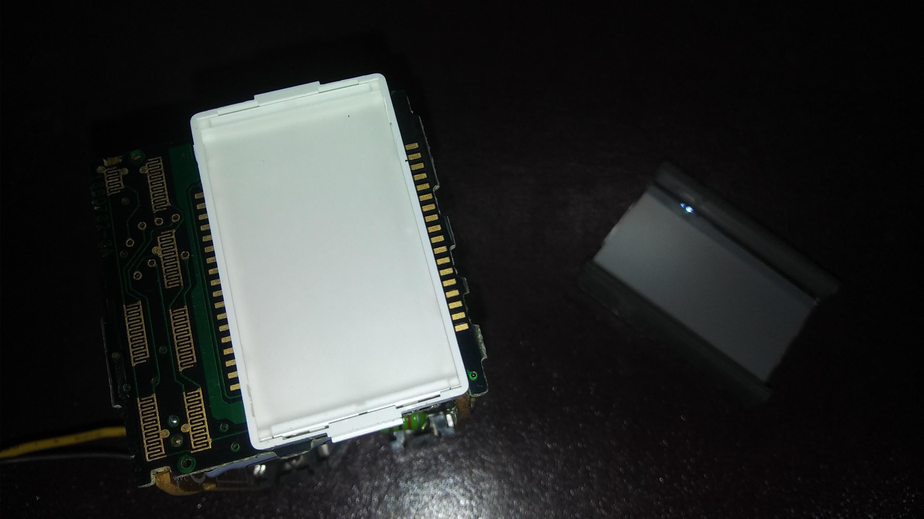

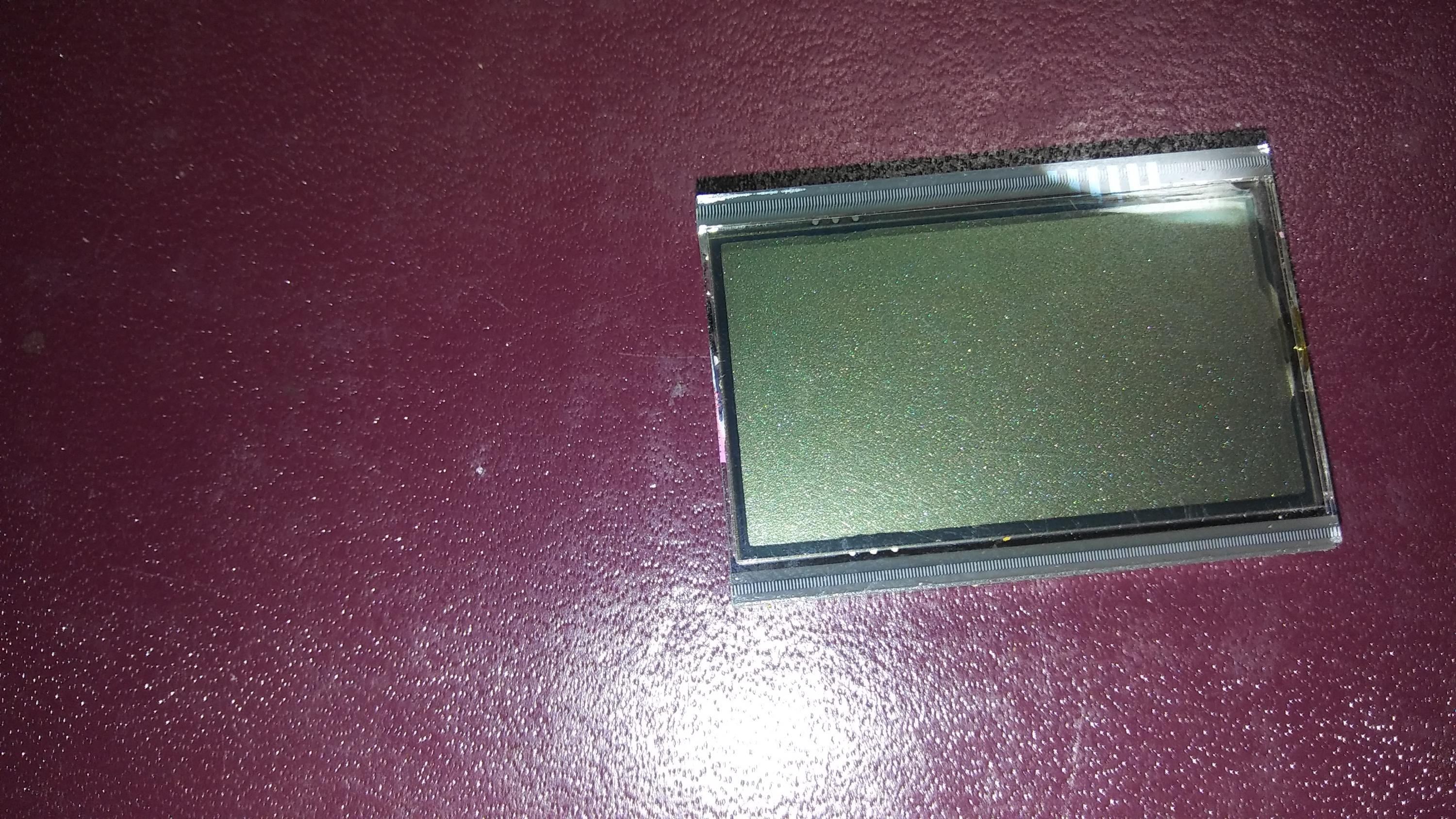

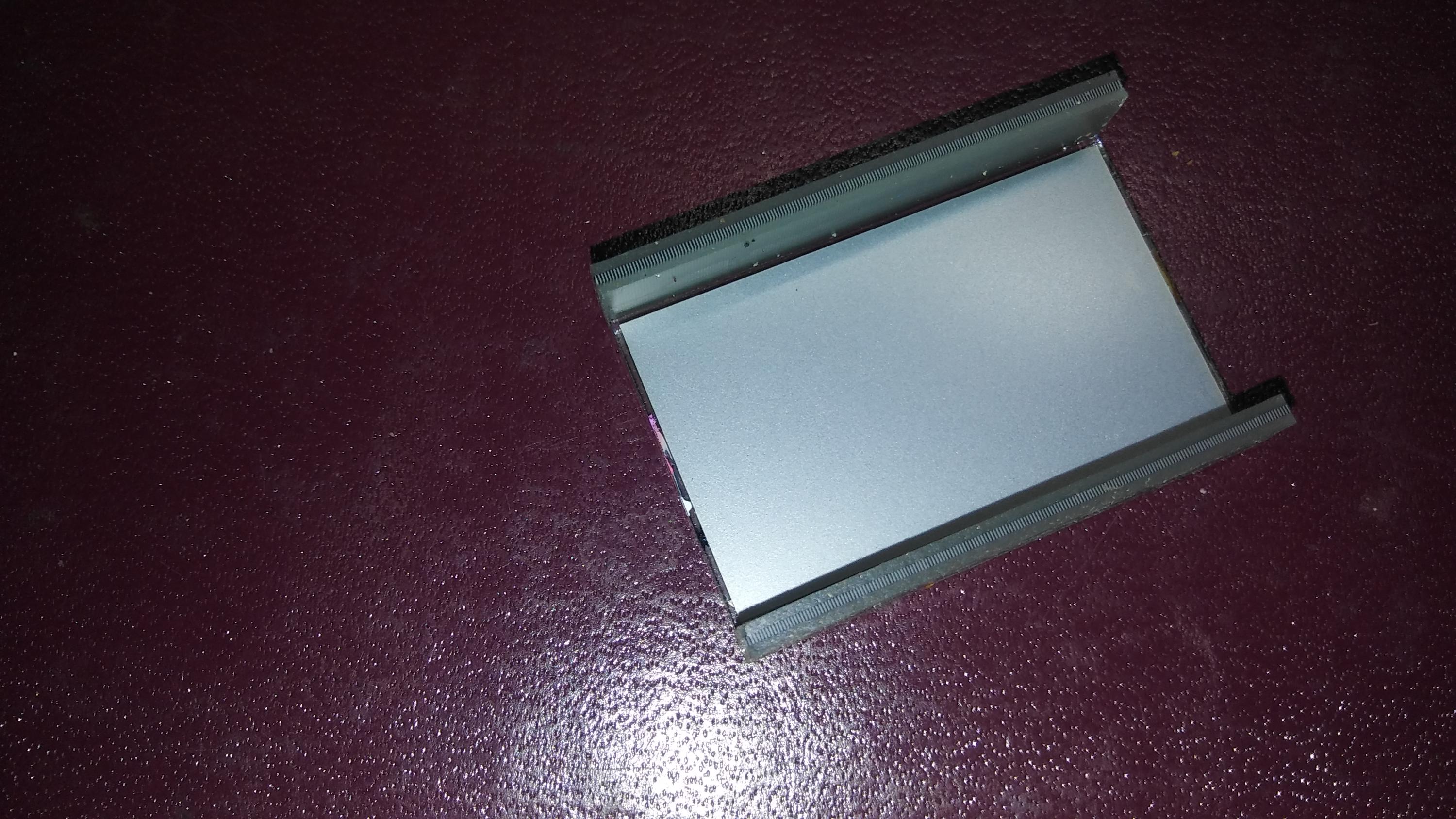

I try to repair the LCD display contact rubber, any suggestions?
Repair LCD display contact rubber!
Re: Repair LCD display contact rubber!
It's called Zebra Strip, I would try cleaning the pc board contacts first then give the strip a wipe with alcohol. its more likely a problem with uneven preasure caused by the zebra strip being compressed and it has shrunk slightly over time. you can buy new zebra strip.Last edited by R_J; 02-19-2019, 10:22 AM. -

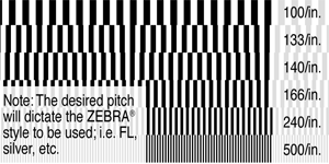

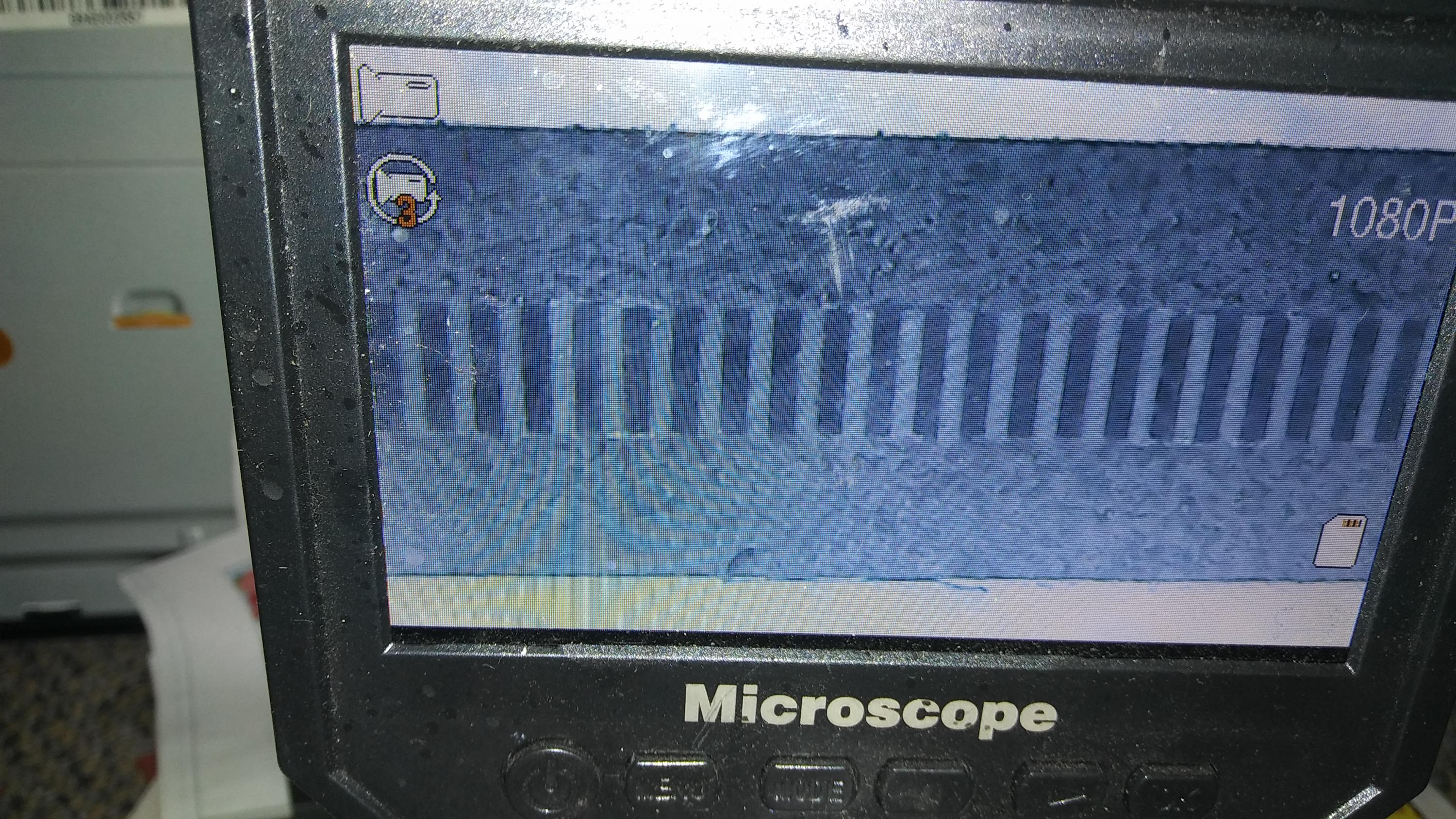

They are made of alternating (zebra stripe) layers of silicone rubber. The conductive black stripes are carbon-filled silicone rubber. The support portion is usually (pink) sponge rubber or (greyish translucent) solid rubber.
I think they fail because the carbon-stripe part shrinks after being squished for years. It's supposed to stick out past the support rubber part, to touch the LCD/PC board.Comment
I am thinking the correct way is to measure zebra strips (carbon-filled silicone rubber) and LCD contact pads (Indium tin oxide (ITO)) their resistance.
