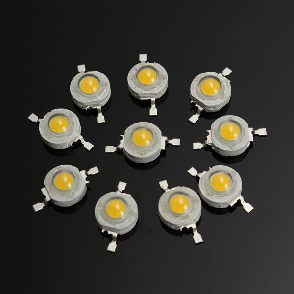

        Since each LED is around 3.4V, a 5V power supply is not good. 1.6V is wasted as heat in a resistor. A 12V supply with three LED's in series, wastes 1.8V on a resistor as heat, but for three LEDs, not one. I like higher voltage with strings in series.

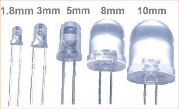

        Did you mean 5mm or 10mm through-hole LED? (T10 is a wedge base for 194 car lamps). These epoxy LED's are low power, 20mA usually.
        So I think it's better to use fewer high power LED's, unless you want to solder 300 LEDs...
        I use 1W or 3W SMT "bead" LED's (very cheap) and each is at least 10X-20X more power than a T1-3/4 5mm LED. Then getting rid of heat becomes the challenge. They have a thermal pad on the back, mounted to aluminum PCB.
        So you need 10-20X fewer LEDs for the same light output. People tell me COB LED boards are better but I have not tried them.
        Or you can buy a single very high power LED, like a 50W LED and use that. I found the quality of light poor, shadows, fan-cooled, not good for the workbench.

                  Which ones are the 10mm LEDs

                  You can run high power LED's (say 1W or 3W) at lower currents, to not need heatsinks. They are more efficient too. Run them at say one-tenth power 0.3W
                  5VDC PSU and 90R 1/4W resistor for 20mA (0.064W/LED) or 18R 1/2W for 100mA (0.32W per LED), as examples. A resistor works fine, LM317 is not needed.
                  My point is one large LED can do the work of five little ones.
                  Here are through-hole LED pics, T-1 3mm and T1-3/4 5mm are most common, the 10mm is the same LED die and just more lens. Same light output just different lens.

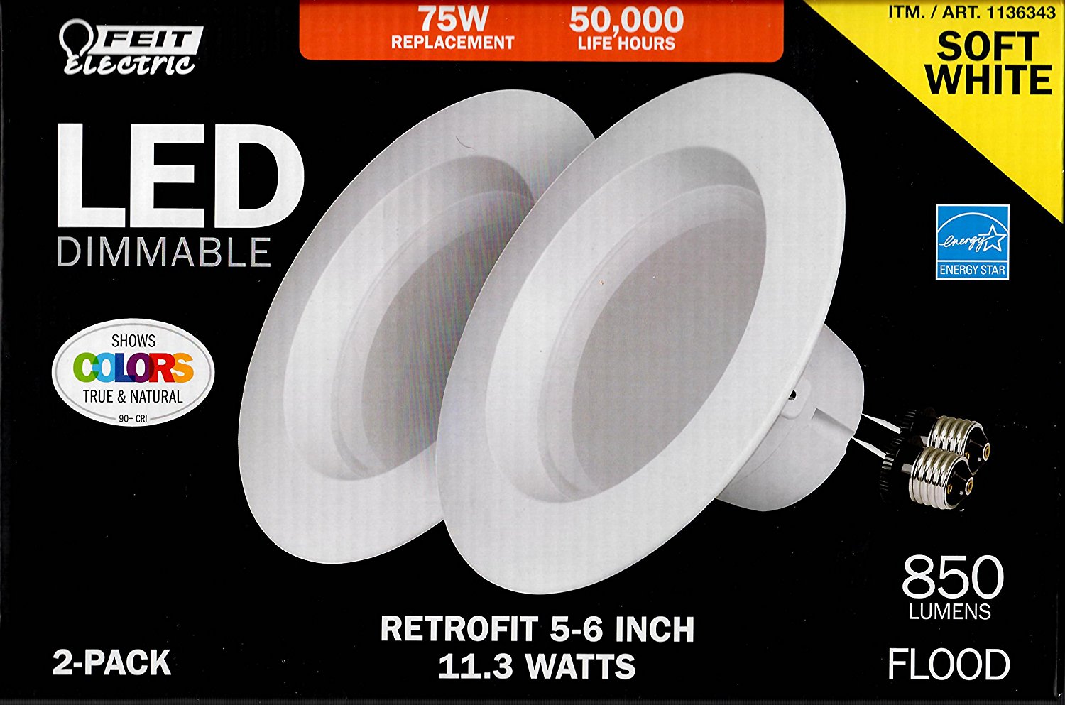

                        Re: I want to build a LED flood light board use 3.3 volts or 5 volts (White color LE
                        Do you have COSTCO card?
                        They have 2-pack on sale for $4.89
                        Buy them and take them apart to see if you can modify it to what you need.
