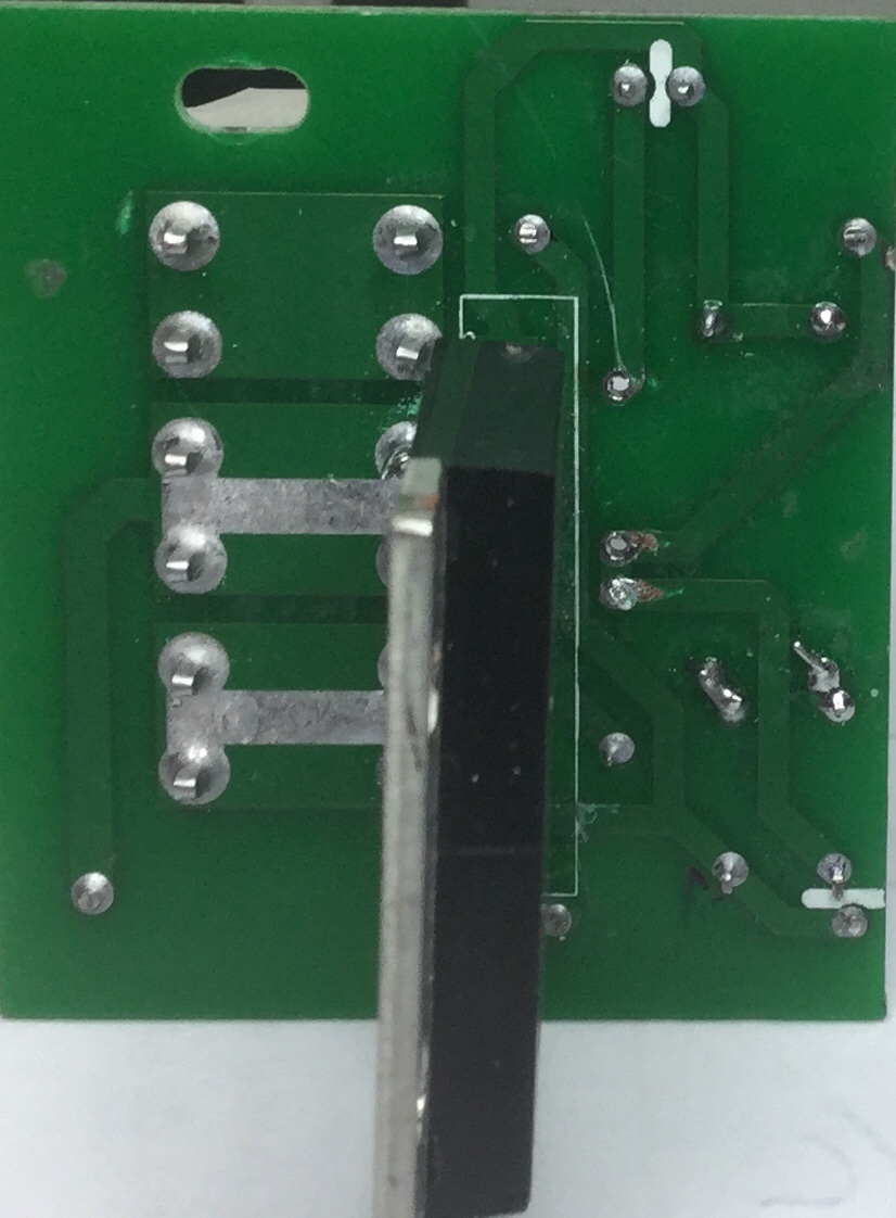

    The photos are below
    I have a few of these TRIAC ( BTA100-800B )
    I can control the transformer but I do not have the fine control over the transformer that would like to have
    Does anyone have any idea how to have more control over the triac

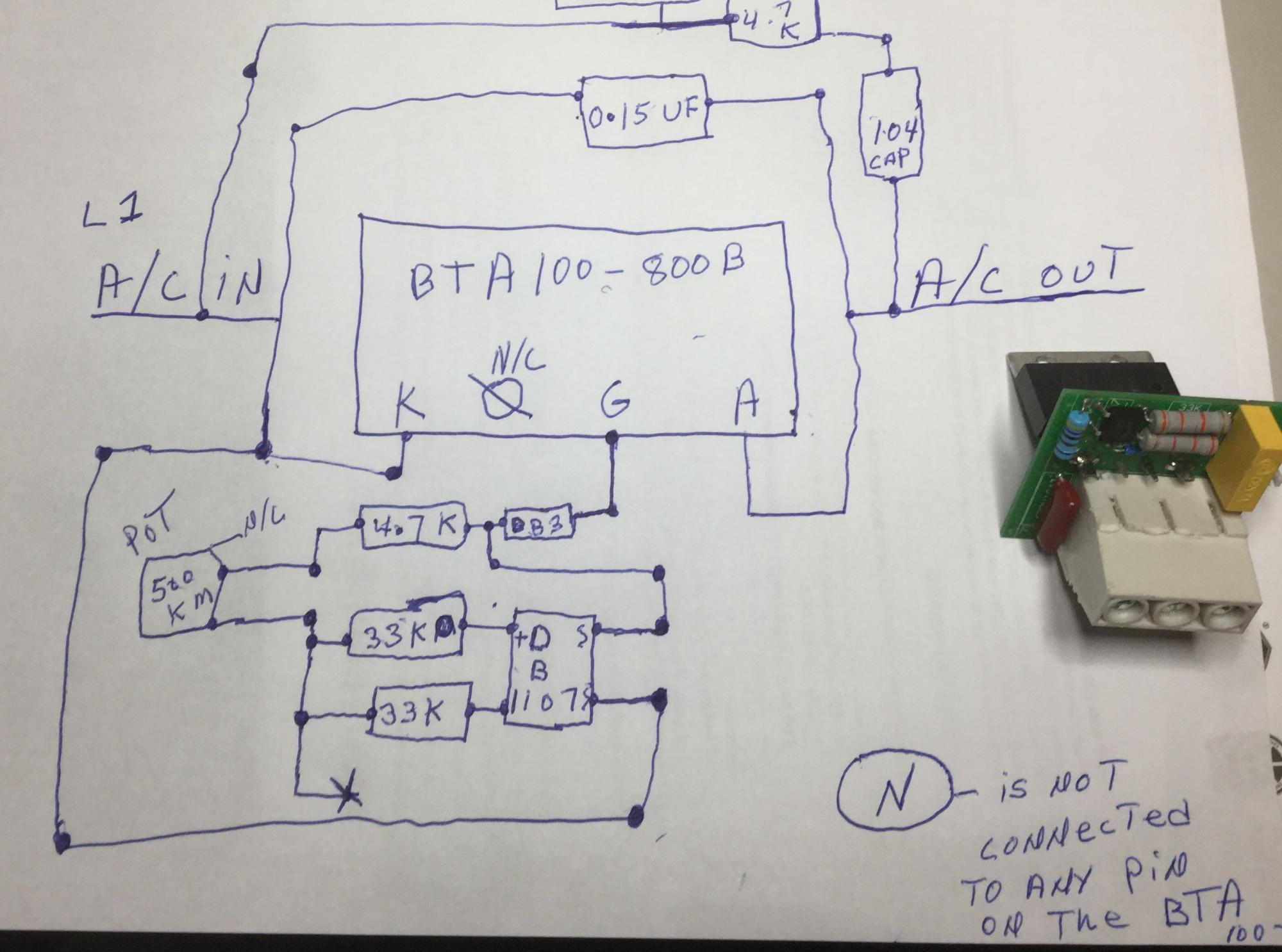

        Here is a circuit drawing of this circuit board for the BTA100-800B triac
        The part of this circuit I do not understand is what role does the bridge rectifier plays in this circuit the way that it is wired and why the (+) and (-) terminals are wired two 33k ohm resistors that come together on the opposite side of the resistors then go to (DB3) with I think is a DIAC of some sort
        AC (IN terminals) on the bridge rectifier one terminal goes (K) and the other terminal to the DIAC and the 4.7k ohm resistor

              Can you check your schematic, the 0.15uF firing capacitor is not in the right place.

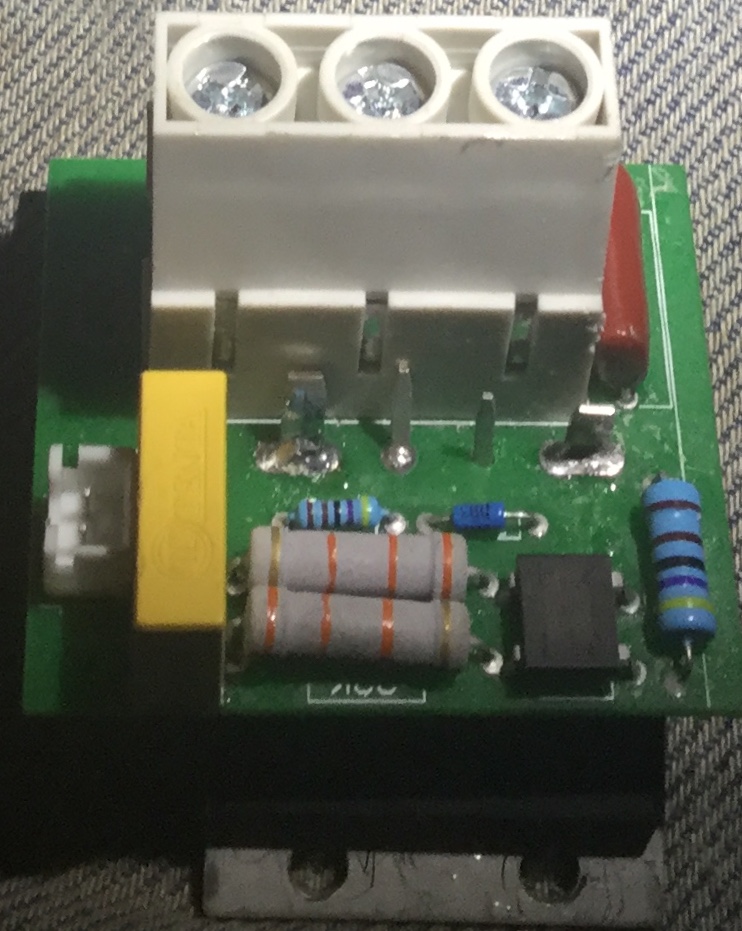

                The circuit is your generic chinese triac phase control off fleabay. Usually mixed up or the wrong parts on them.
                500k potentiometer is for 220VAC. 200k-250k potentiometer for 120VAC.
                So a large dead zone with the pot you have. You could try add a resistor in parallel with the pot, like 250k 1/4W , to make up for the dead zone.

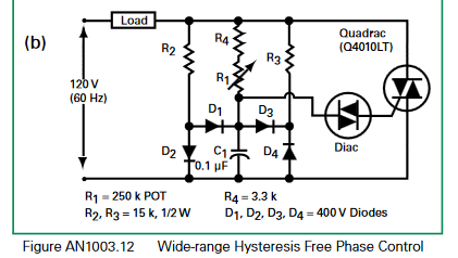

                The circuit is not your usual one. There is an added bridge rectifier to give "hysteresis free" or "no snapback" effect, like you see with lamp dimmers. It's also helps with inductive loads.
                The extra diodes discharge (reset) the firing delay capacitor every cycle, to give consistent phase delay.
                More can be found in figure AN1003.12 on Teccor App note AN1003
                Note the potentiometer is hazardous live and should have a grounded case/shaft or a good knob.

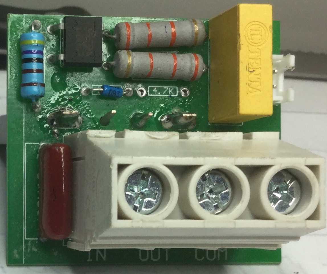

                  The yellow cap is the one that is next to the two 33k ohm resistor
