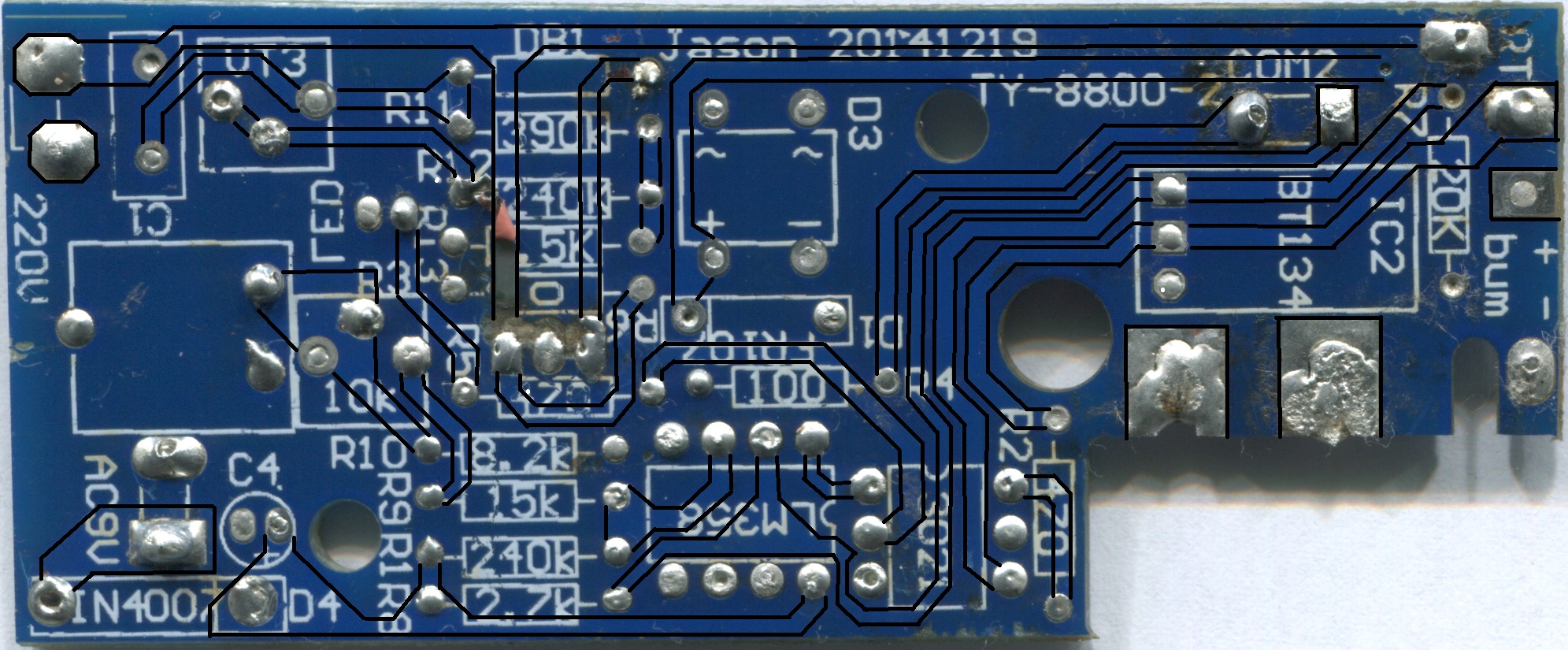

    AOYUE 8800 Desoldering Gun PCB
    PCB Components list
    BT134-600E Thyristor TRIAC 600V 4A TO-126
    LM358P DIP-8
    MOC3021 Random-Phase Optoisolators Triac Driver Output DIP-6
    DB107 DIP 1A 1000V Rectifier Bridge
    DB3 ST trigger diode
    y2 250v x1 400v ceramic capacitor
    100uF 16v Capacitor
    46E 104J CBB capacitor
    b203 potentiometer
    3362 potentiometer
    1N4007 Diode
    FR107 Diode
    20k Ohms 1%
    390k Ohms 1%
    240k Ohms 1%
    1.5k Ohms 1%
    8.2k Ohms 1%
    15k Ohms 1%
    2.7k Ohms 1%
    100 Ohms 1%
    470 Ohms 1%
    I'm going to make a duplicate of this pcb, for another 3d printed desoldering unit. Using replacement C088 element/barrel/nozzle.
    Using CadSoft EAGLE to try recreate this layout. but so far not 100% certain of the components list.

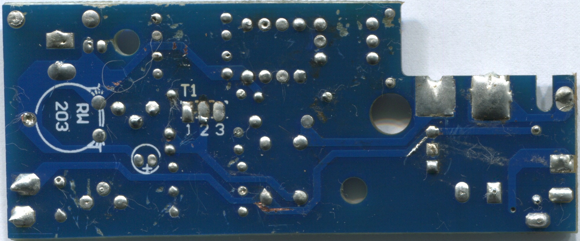

    It looks like a 2 sided pcb, it lets light through, I marked a red arrow is that a via bridging top and bottom circuit?
    The silkscreen info has
    1.5k resistor / 470ohm yet have the same colour bands.
    same for the two 470ohm resistors.
    Potentiometers are unknown ohms, Is it ok to turn these or will they be calibrated?
    RW 203
    10K
    VT3
    Also attaching the bare pcb layout the traces are damaged, and hard to see so I defined the copper in black.
    any help or advice would be appreciated thanks.
