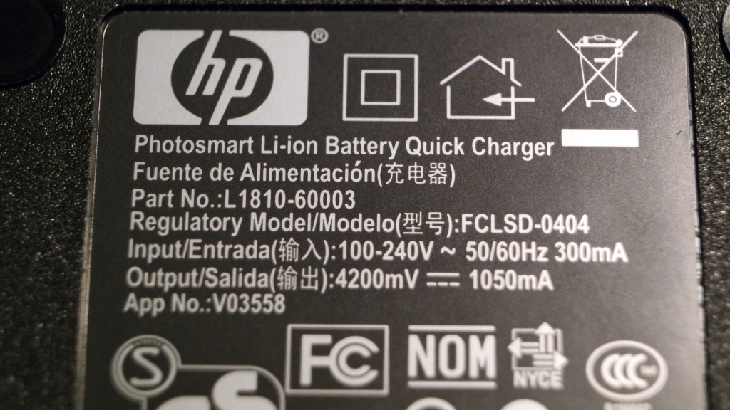

    HP li-ion battery quick charger

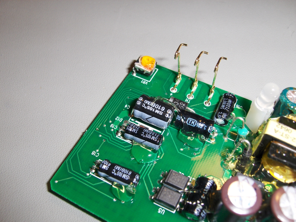

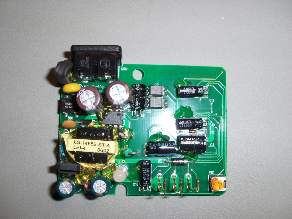

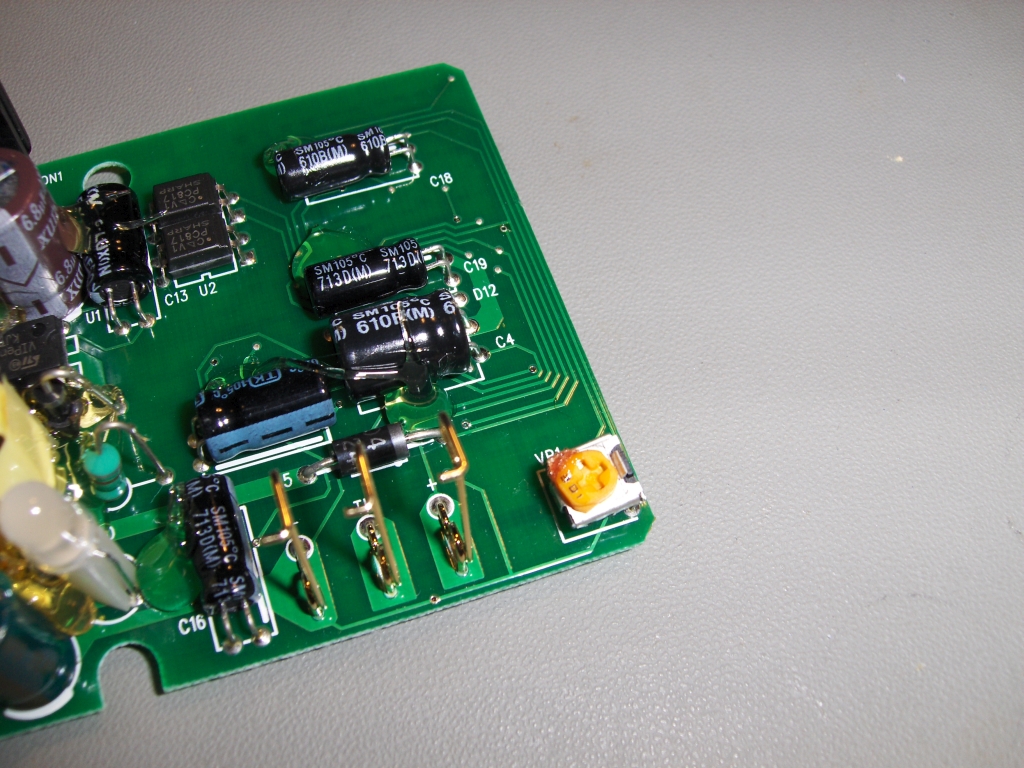

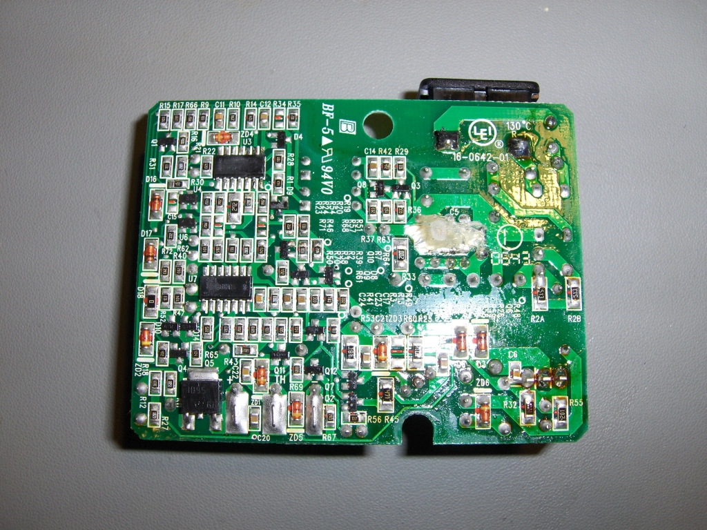

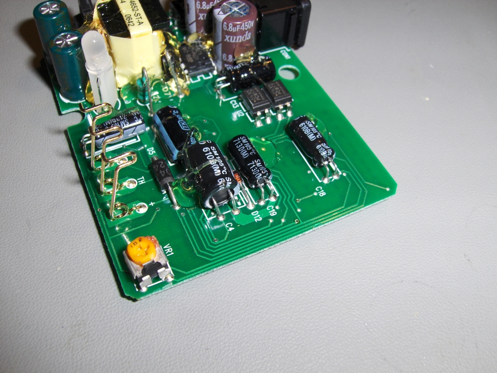

    I was interested to see what was inside, I guessed it would be a good quality smps and a 8 pin soic lion charger chip but is was much more complicated.
    The top 14 pin is a lm324, the lower 14 pin is marked ST N001.
    What do you think the pot is for ? termination charge voltage or charge current ?
