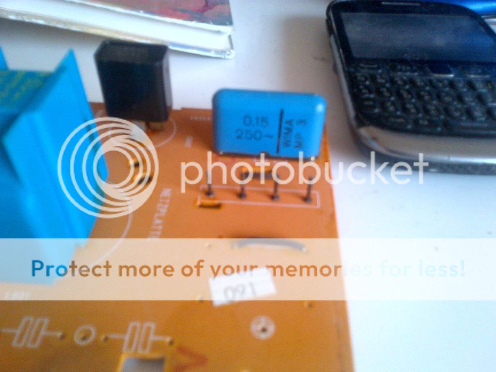

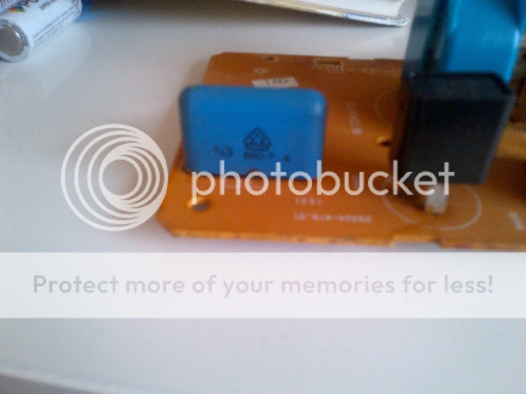

Help with a Capacitor
+ More Options
Posts
  • odotb3
    • Dec 2015
    • 2
    • uk
    Help with a Capacitor
    I recently acquired an old Grundig TV from 1982. Series 815 CUC 95. Somebody I work with was just going to throw it away! I'm a retro gamer so I know these old CRTs give the best picture with old school gaming consoles. And I was right, playing Super Mario bros 3 on an NES on this TV compared to a modern day LCD is like night and day!
    So anyway, I was playing smb3, got to world 7 and decided I would take a break. I left the TV on and came back an hour later to a room full of smoke! The TV was still running fine and after the initial shock of the thought that my house was burning down, I opened the back case of the TV to find a metal film cap had exploded! I slid the board out of the chassis.
    [/URL][/IMG]
    Now, it is my understanding that this TV was not in use for some years, and after some heavy use from me over a period of a few days, the cap decided to give up. Assuming they've never been replaced, these caps are nearly 35 years old.
    I'm wondering whether the cap blew from age, or something else caused it to blow? I cannot find a (free) copy of the service manual. Having said that everything else looks ok.
    I'm just going to replace it. The cap says 0.15 250v~ wima mp3. The markings on the back say N3 560-7 X. However I cannot find a suitable replacement locally. This is the only one I can go around the corner and grab but its voltage is rated much higher. I know you should never decrease the Voltage rating, however I am unsure whether this is a suitable replacement. I was also wondering whether the type of film capacitor is important.
    There is another cap on the same board which is identical and im thinking of replacing that one as well.
    [/URL][/IMG]
    [/URL][/IMG]
    Thanks in advance to anyone who can help!
    Last edited by odotb3; 03-12-2016, 09:40 AM.
  • MORETTIGIAN
    Capacitor detached from PCB – RTX 2070 Super Founders Edition
    by MORETTIGIAN
    Title:
    Capacitor detached from PCB – RTX 2070 Super Founders Edition
    Description:
    During maintenance on an RTX 2070 SUPER Founders Edition, I found a capacitor lying on my desk after reassembly.
    I did not notice it detaching, so I am unsure of its original location on the PCB.
    Procedure performed:
    - Removed backplate
    - Cleaned heatsink and PCB with isopropyl alcohol + soft ESD brush
    - Reapplied thermal compound
    - Reassembled card
    Observed behavior after reassembly:
    - GPU powers on and operates normally under...
    09-18-2025, 12:14 PM
  • Prolog
    RTX 3080 FE Identifying capacitor
    by Prolog
    Hi people, I hope this is the correct spot to post this, I'm new to the forum.
    I have an RTX 3080 Founders Edition which has a burnt up capacitor (it was in parallel with another capacitor which appears damaged too), so I am hoping to be able to identify the capacitor values and order replacements.
    I hope these photos make it clear which component I am referring to:
    (yes, the soldering is a bit botched from removing the blown one, I know)
    I have found the board schematic (attached), but there does not seem to be a boardview available. I have never...
    12-01-2024, 08:27 PM
  • chth96
    If I replace with inferior capacitor, Is it No harm to other IC components at all?
    by chth96
    I replaced some capacitor which is located on optical pickup pcb which is shown in the table below(PCB #2).Because it have been out of order.
    Now,It works very well,But I just have found that all caps (6svpc100my and other part number as well) ,which is shown in the table below, has ultra-high ripple current spec.
    It is not able to obtain any capacitor which can be a substitute for this ultra-high ripple current nichicon capacitor.
    So I replaced it with samxon and rubycon's general capacitor(GP,YXA series).
    I know that these capacitor will not last as long as nichicon capacitor...
    12-22-2023, 04:34 AM
  • chth96
    How can I test non-polarized capacitor?
    by chth96
    I desoldered samwha NF capacitor(50v 5.6uf) from PCB circuit of 29inch CRT TV which have symptoms of no display after I heard sound of inrush of current to TV whenever I switch on this television.
    I measured ESR value of this non-polarized capacitor(samwha NF capacitor 50v 5.6uf) by means of MESR-100 ESR meter and It displayed 0.3 ohm
    And When I measured its capacitance with digital multimeter and LCR-T4 Mega328 meter, It displayed 10uf from DMM and 8uf from LCR-T4 meter.
    I found catalogue of samwha capacitor(samwha-catalogue_3.pdf file), which is attached to this thread,...
    06-02-2024, 07:31 PM
  • chth96
    Is it no harm to replace with capacitor without ripple current rating?
    by chth96
    When I tried to repair LG 29 inch CRT TV, I found that the ESR value of samyoung SMS capacitor(160v 2.2uf), which is very close to D1879 transistor, is 6 ohm.
    Judging from above ESR Meter Table,I think It is necessary to replace this sms capacitor.So I visited local electronics shop,and I purchased 160v 2.2uf rubycon YK capacitor.
    But when I browse through rubycon YK datasheet,I found that there is no ripple current rating for 160v 2.2uf specification. But On the contrary, I found 39 mA ripple current rating for 160v 2.2uf SMS capacitor.
    Rubycon YK DataSheet (b...
    04-19-2024, 05:19 AM
