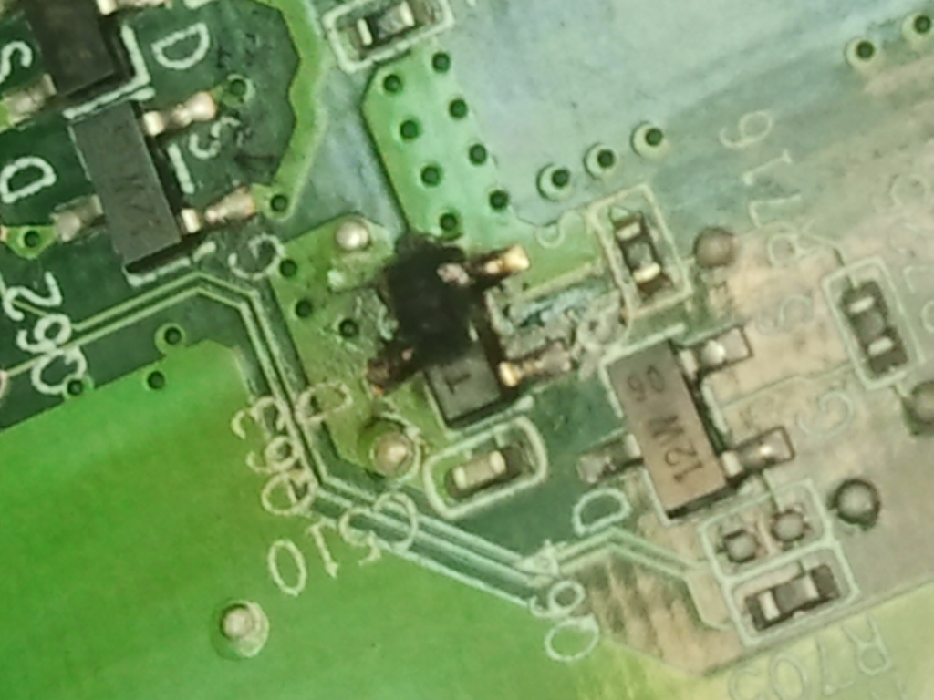

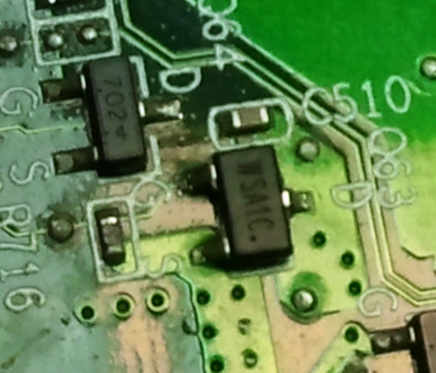

    Please help in identifying this chip from a Dell all-in-one pc. I cant crack the secret code. The blown chip starts with a T and the other is from a MB of the exact same PC. I have searched through all of my old boards to see if I could match it but have yet to see a code like. Thanks in advance for the help.

    WSA1C I think is a AO3401 P-ch MOSFET. Marking Code: https://cdn.badcaps-static.com/pdfs/...e12b435266.pdf
    I have good luck at this slow site: http://chip.tomsk.ru/chip/ChipDoc.ns...at=T&count=500

      WSA1C --> ME2345A 30V P MOSFET , marking code WSAXX
      ME2345A can replace AO3401A
