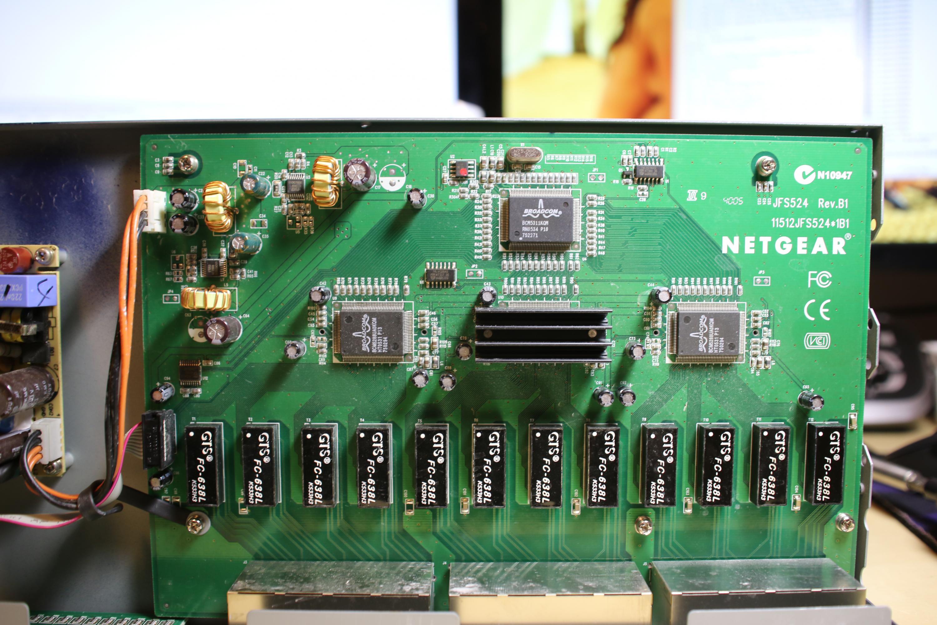

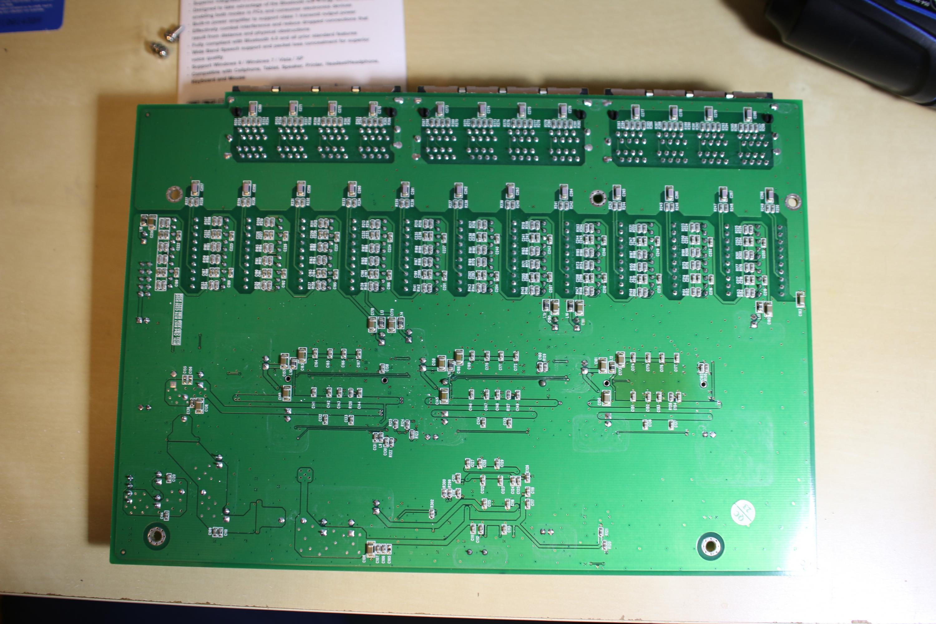

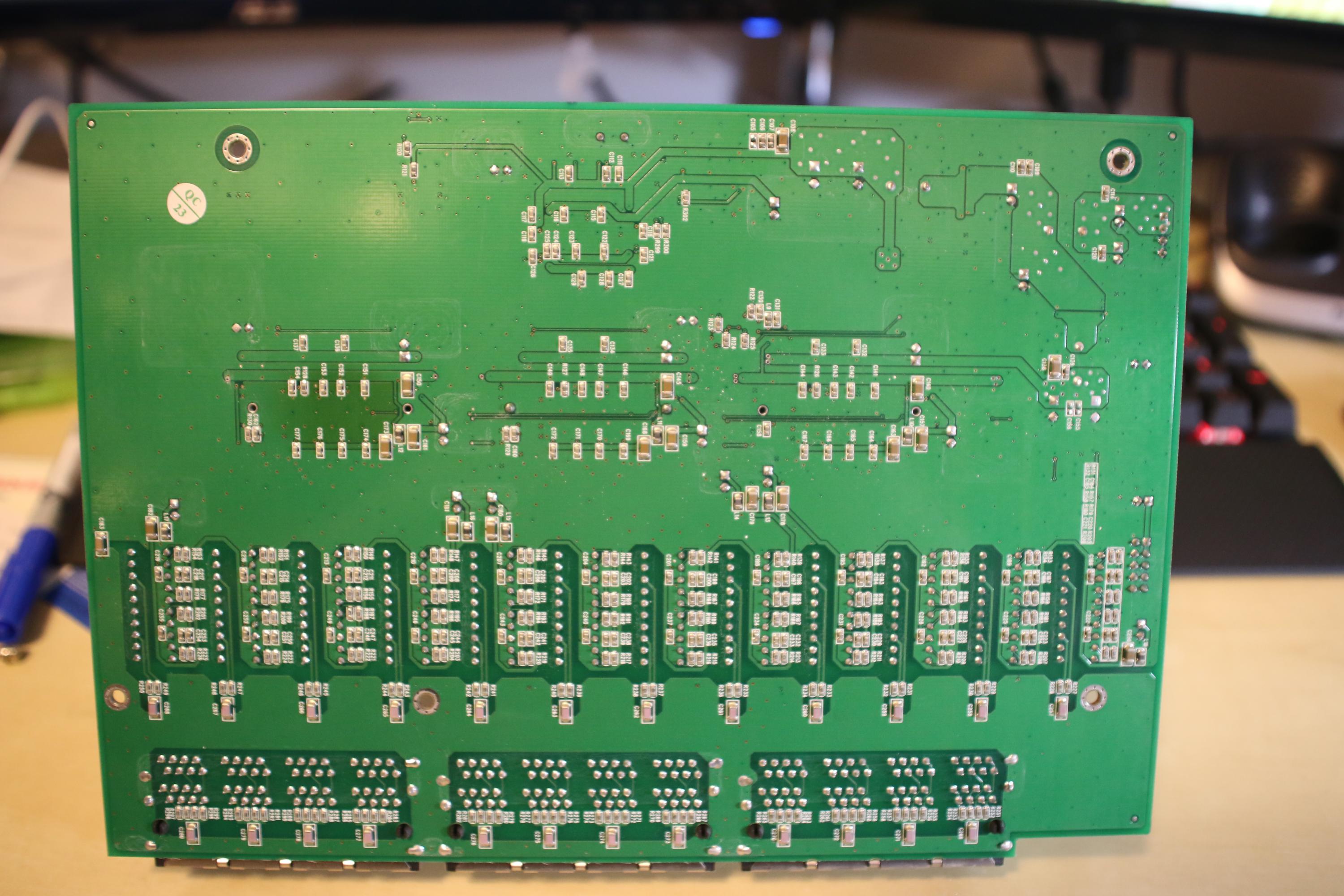

    Hi everyone,
    I had a Netgear ProSafe 24 ports 10/100 Switch, model # JFS524 that has some network connections is defective. I would like to know if i can repair or change some parts on the board to recover my switch.
    I had took some pictures of the motherboard here they are:
    Any help is appreciated. Thanks.
    EDIT: I fully tested the switch; and here the ports that don't work.
    PORT #17 always ON light 1 of 2 (Light 1 is LINK/ACT)
    Port #2,
    Port #17
    Port #18
    not working at all.
    All the other ports is working.
    I can took electronics microscope of some parts if needed. I had an 2MP microscope 1080P.

    Is it possible those ports took a hit? Like lightning or other surge? The protectors for those may have a short. I have a xyzel gs1100 in similar state. I have not figured it out yet. Also check for any bad solder joints running from those ports back to the IC.

        I would check the FC-638L components (there are 12 - 1 for every 2 ports) and compare to a working one. My guess is that a couple of the ports that are bad have shorted windings due to a surge. The datasheet for them are available on-line here: http://datasheet.seekic.com/pdfimage...nologypdf0.jpg
        I had a switch that was shorted due to lightning strike before and would not work. When I pulled the transformer/protector that switch came to life. I never fixed it since it was an experiment. I have no idea where you could get the parts if you find one is defective. They are mfg. in China. Good luck and let us know what you find

          Agreed. Remove the pulse transformers for the non-working ports and check for problems. Every similar device uses these parts so you can get lots of them from any junk box. If the transformers are OK, then the switch is not repairable unless you love changing IC's.

                Easiest way should be to do comparison tests. Compare the transformers for open\short and check those SMD capacitors next to each port too.. Compare resistances when off, voltages when on, etc.
