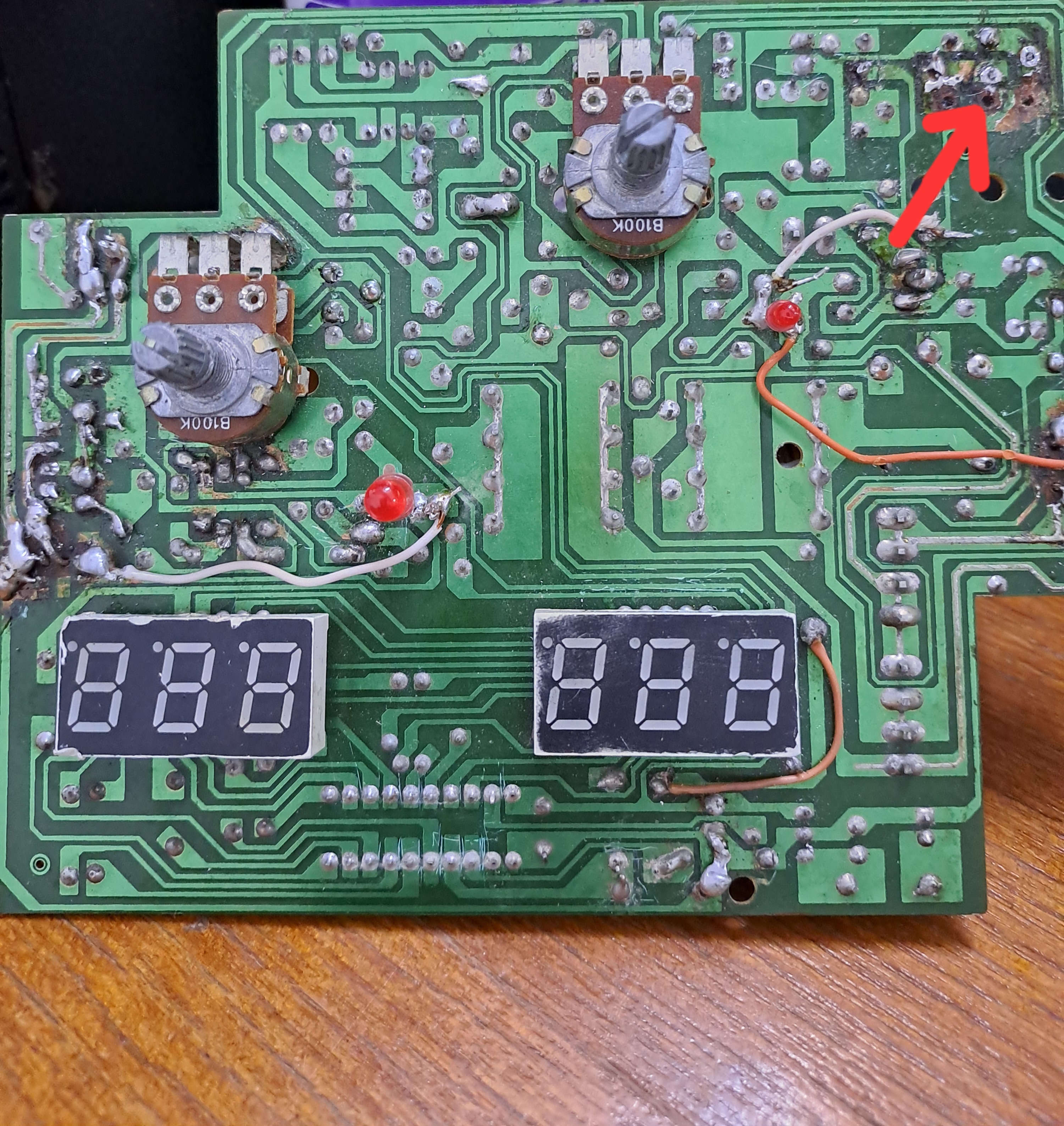

    Hi, i have a hotair station LK852D-2 , and the problem is about the air flow is little and hardly to getout any air flow from it, i unfurtanitly replaced the potinmeter 500k ohm with new one, but it never solved the problem, and then i unsoldered from the board as you can see in the attached photo, and that make Some parts of the circuit diagram been damaged, and I need someone who has the same circuit diagram to provide me same photo of the diagram, especially the place where the 500 kΩ potentiometer switch is located( the place of 500k ohm potentiometer is indicated it with red arrow in the attached photo). is there any solution to the low air flow problem? What is the reason for that? Thanks in advance.

    show the pump/fan, it could be a mechanical issue

      Does it have an internal air pump, or a blower fan in the hand-piece?

        pump Diaphragm

          It has internal air pump

            There is no fan inside of it

                I don't know how the pump is controlled. Is it with a Triac, like the heaters?
                You basically have two possible problems - the pump is bad, or the control circuit is bad.
                What voltage do you get to the pump when the air control is turned to maximum? I imagine it should be very close to, or the same as, the line voltage - assuming the pump runs from mains, anyway.
                If the voltage is much lower, you probably have a control circuit fault, if the voltage is normal, the pump is probably bad, likely mechanically.
                Another test would be to connect the pump directly to whatever power supply it uses, bypassing the control circuit, and see if it runs normally.
