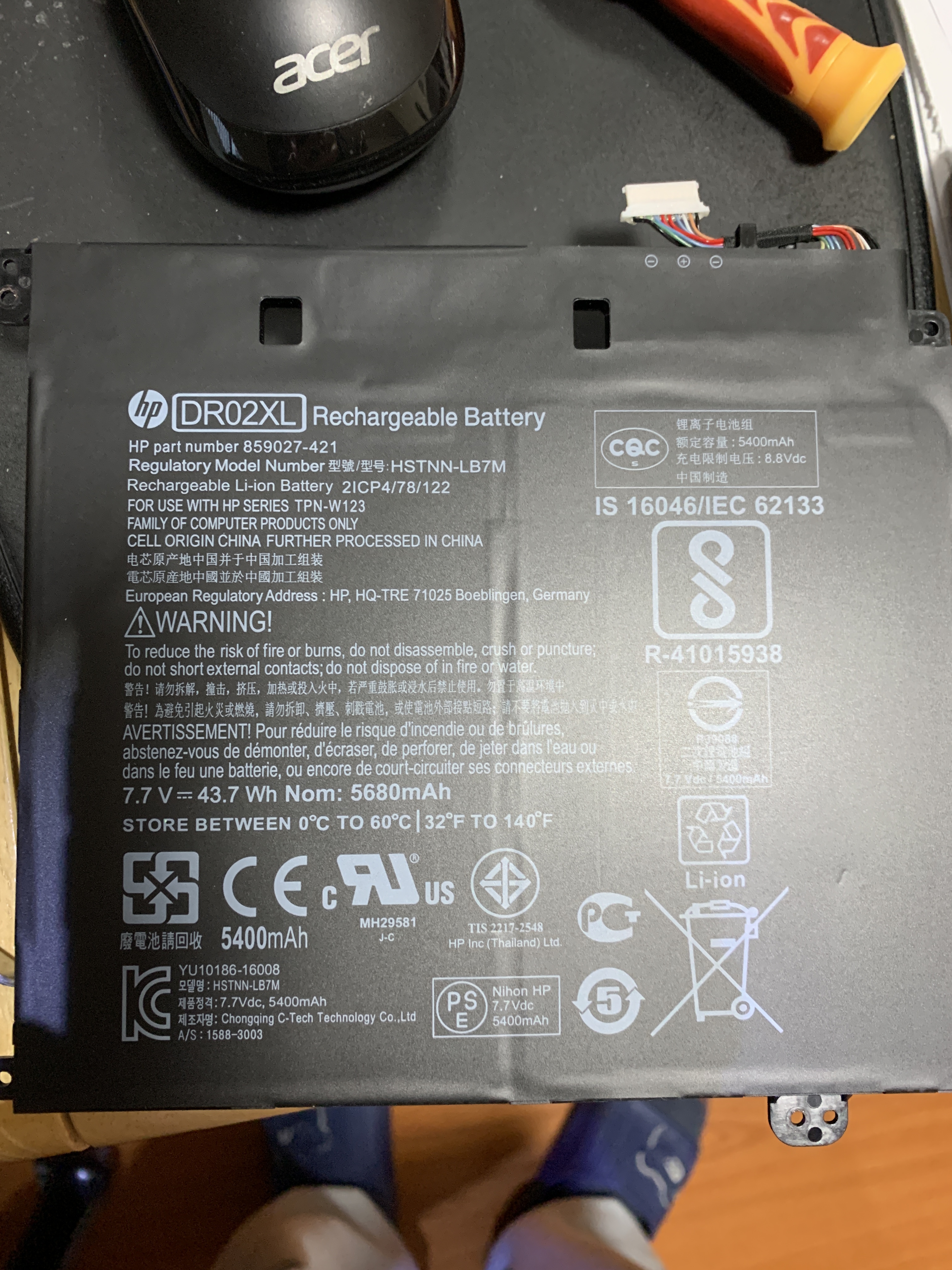

          Thanks for your comment.
          Sorry, I did not post the outer packing of the battery pack. Also, there is markings on the cell, but I just do not know what it means. Here they are.
          The markings show 7.7V which I think should be the nominal voltage. Then the maximum or full voltage for each cell should be 4.2V. Did I make a mistake?
            I personally do not understand this either because I am wondering if it is a Lipo 4 type battery then would make sense in respect of maximum voltage
            what is the Chromebook’s voltage going to battery terminals because 7.7 volts would make sense now if the voltage is 8.4 volts going to battery cells then would say that the battery battery pack has some type of issue
