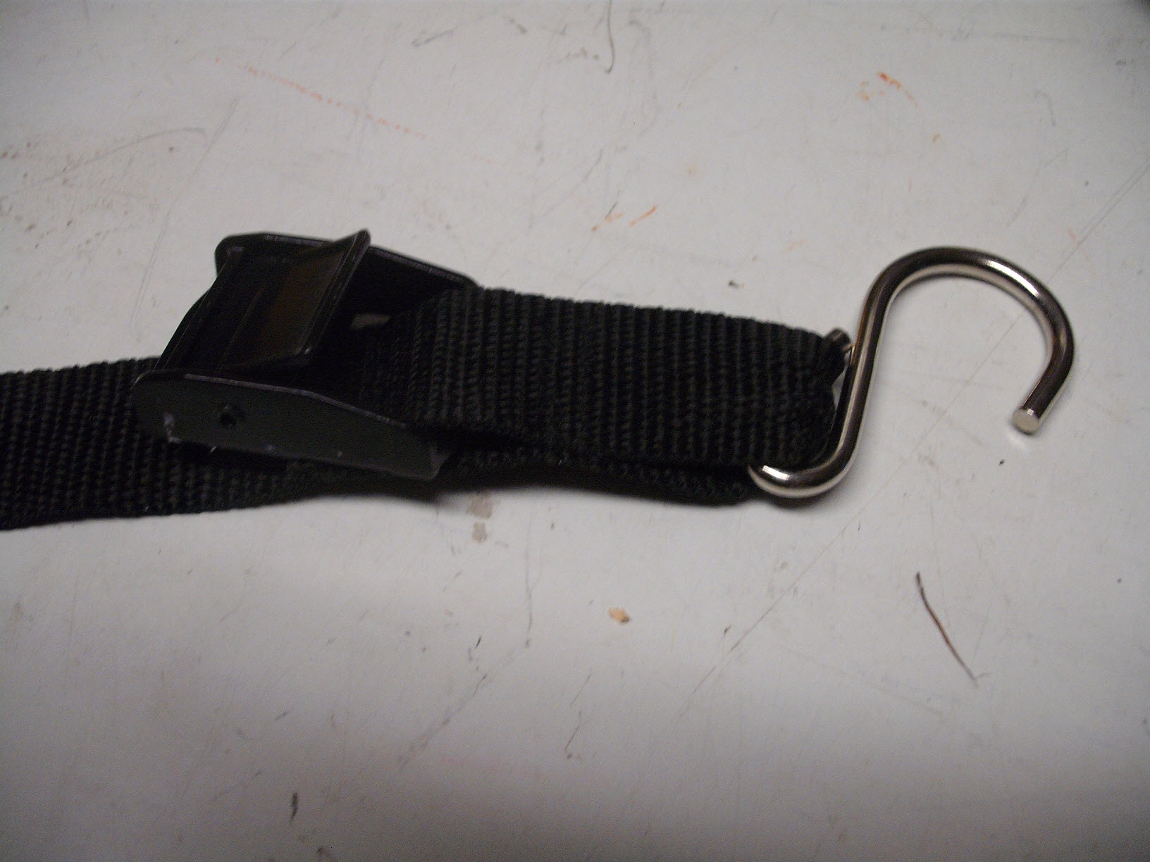

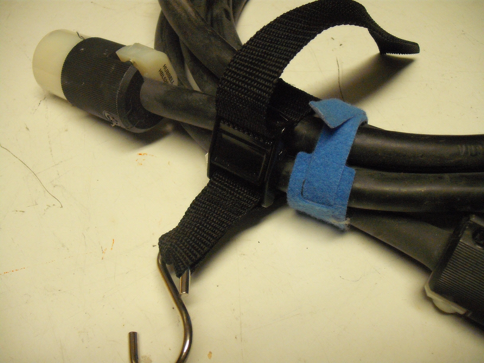

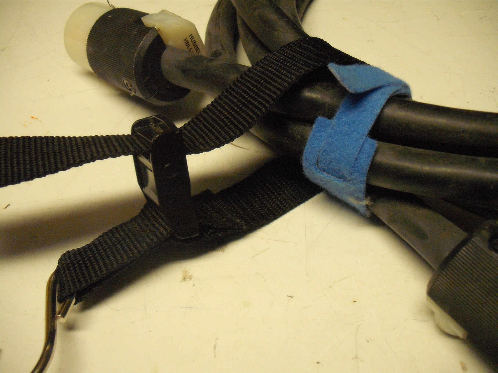

    In the past, I'd just coil them and wrap a velcro "tie" around them (the blue item in the photos below -- a few hundred rescued from some medical supplies). But, while that kept them from unspooling, you're still stuck with a big pile of wire to store!
    Here's a short (~15 ft) cord with my newest "storage technique"... I then hang them from a perforated length of angle on the garage ceiling. So, I can see my entire "inventory" and access them just by lifting them off their mounts.
    I'd originally planned on just fastening a steel ring to the far end of the strap and threading the hook end through the ring (after wrapping around the extension cord). The weight of the cord would pull the strap tight.
    But, then "tick bundles" would tend to hang higher than "thin bundles". With the current approach, they all hang at the same height.

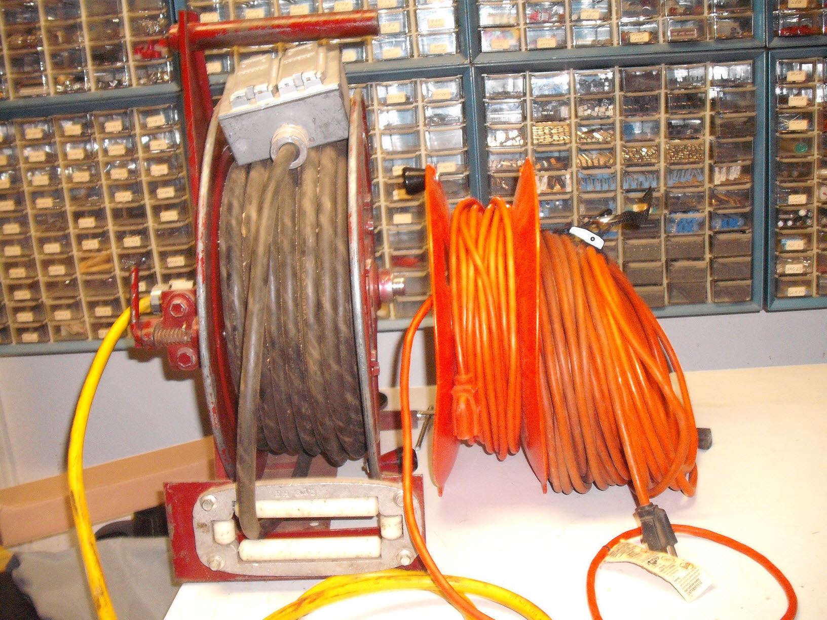

                    By way of illustration, three examples of 100 ft of cord. From left to right:
                    • 12/3 on a cable reel
                    • 16/3 on a spool
                    • 14/3 "air wound"
                    Note that the spool requires the "inner end" of the cord to be left dangling (pigtail) if you want to be able to use the cord while any part of it is still wound on the spool. In addition to the "donut hole" representing unused space (volume), you also lose the space required araound the edge of the spool (if the cord doesn't fill it completely).
                    Both ends of the cord are accessible, at all times, in the air wound approach. And, only the donut hole is lost space (if you make larger coils, you can flatten the coil into a lozenge shape and eliminate the void in the center).
                    The cable reel is mechanically and electrically part of the cord so it's a constant overhead regardless of how much of the cord you play out. There is a LOT of "wasted" space (and weight), there!

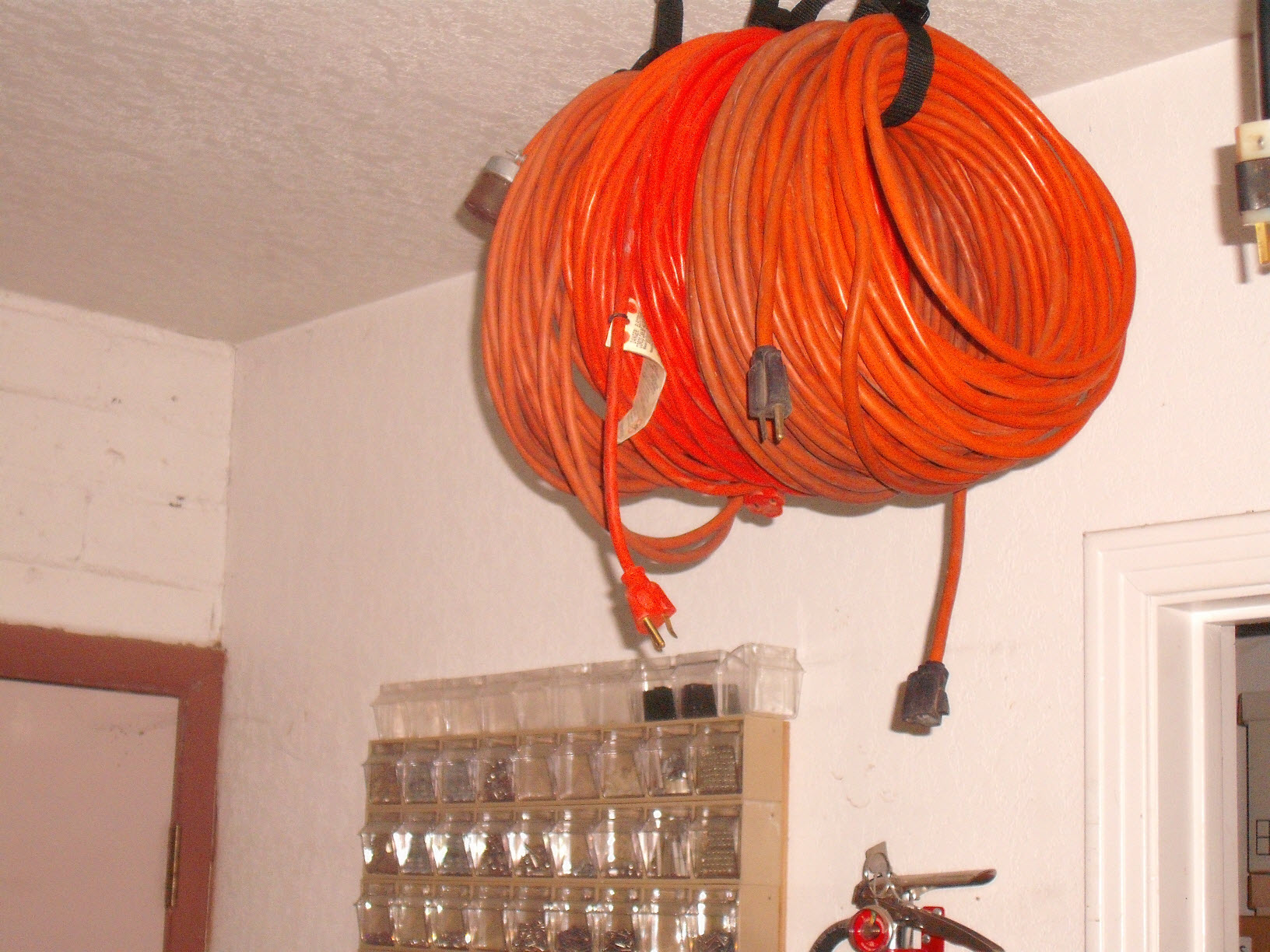

                    Second pic shows three of the "household duty" cords hanging in storage.
