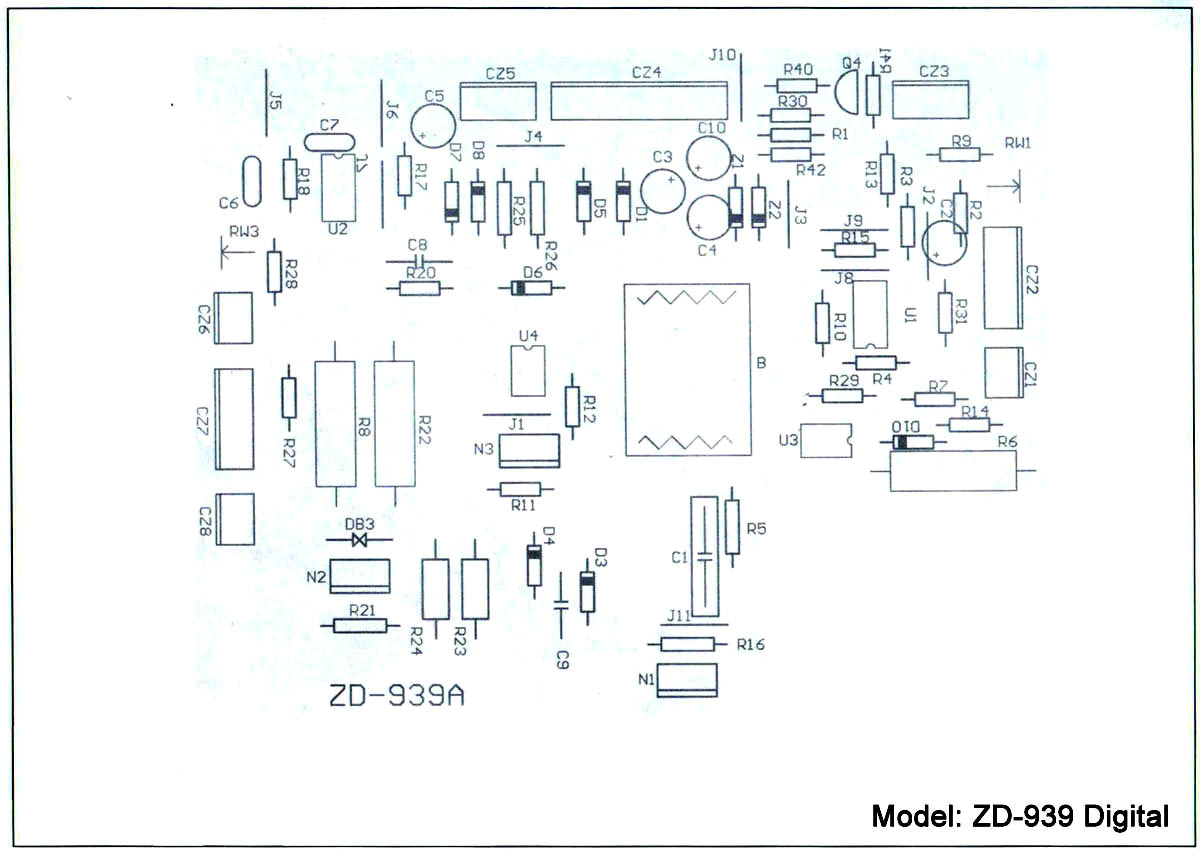

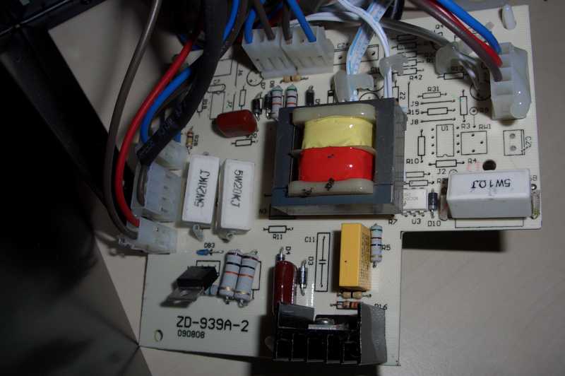

        It looks like ZD-939L is using a ZD-939A power board, but with the analog control parts not populated.
        I see two versions of power boards ZD-939A-1, ZD-939A-2.

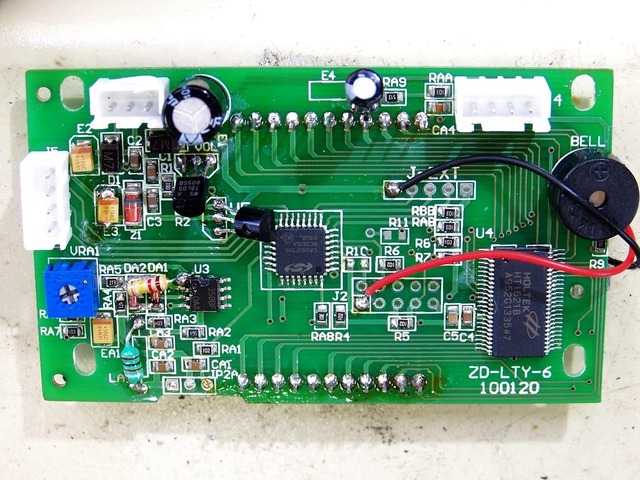

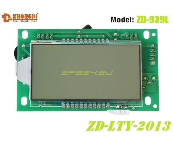

        I see two different ZD-939L LCD control boards, seem to be the same as ZD-912, ZD-915 but with different firmware.
        ZD-LTY-2013 (all SMT)
        ZD-LTY-6 (mostly SMT, 80C51)
        Many people complain the 5V regulator runs hot and fades out.
        You'd have to figure out how to connect power and control from the power board to the LCD control board.
        Three ribbon cables,
        Three conductor cable is 12VAC power
        Two conductor for triac opto-coupler drive hot air heater
        Two conductor for ?
