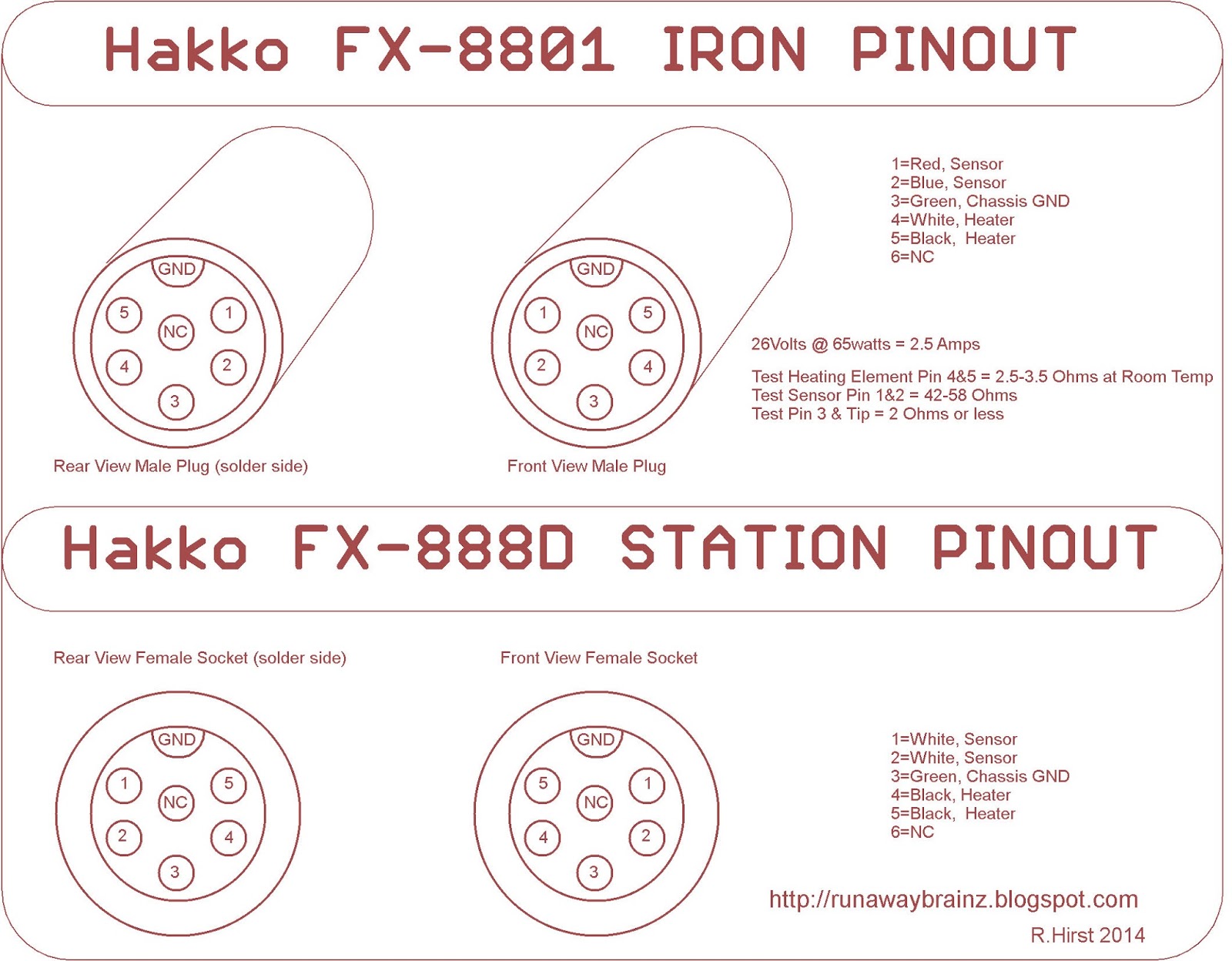

      Honestly, my old station was pretty good in the beginning, but now it doesn't regulate the heat as well and the tips don't last long, even good tips. I may buy a spare Hakko iron and see if it will work with it. It has the same plug, but I'll have to verify voltage. I really love not having to hot swap iron tips anymore. I mainly use a D16 (1.6mm) chisel tip, but sometimes I need a pencil tip too, and it's nice to have them both available at the same time.

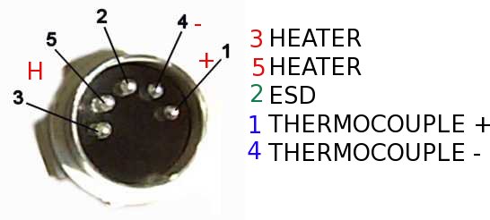

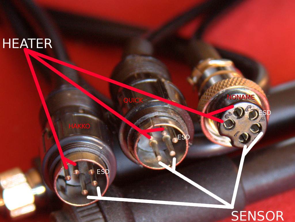

        Re: Hakko FX-888 vs my old generic rework station: No contest
        real hakko vs 900 series clones, the sensor is usually different.
        maybe the pinout on the plug too.
        the real hakko had a shit "din" connector, so the cloners used other connectors - usually locking "microphone" type ones.
          I'm mistaken. My old station was a Kendal 852D++. Still a 900 series clone though. I hadn't looked too closely at the connectors. Probably wouldn't have fit anyway. Maybe I can just rewire one. Basically, I just want a handle that won't come loose every time I put pressure on something. That's probably what I hate the most about the cheap station.
