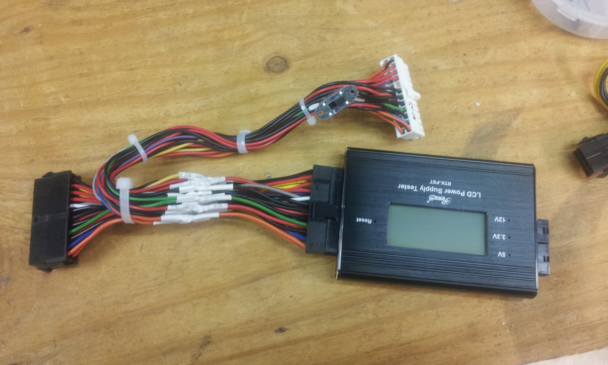

    Desktop Computer Test Cable
    I have a digital power supply tester. Normally it checks the P.S. without a load.
    I made a cable that lets the power supply connect and turn on to load the P.S.
    While under test. Has a switch to enable / disable the green wire for tester
