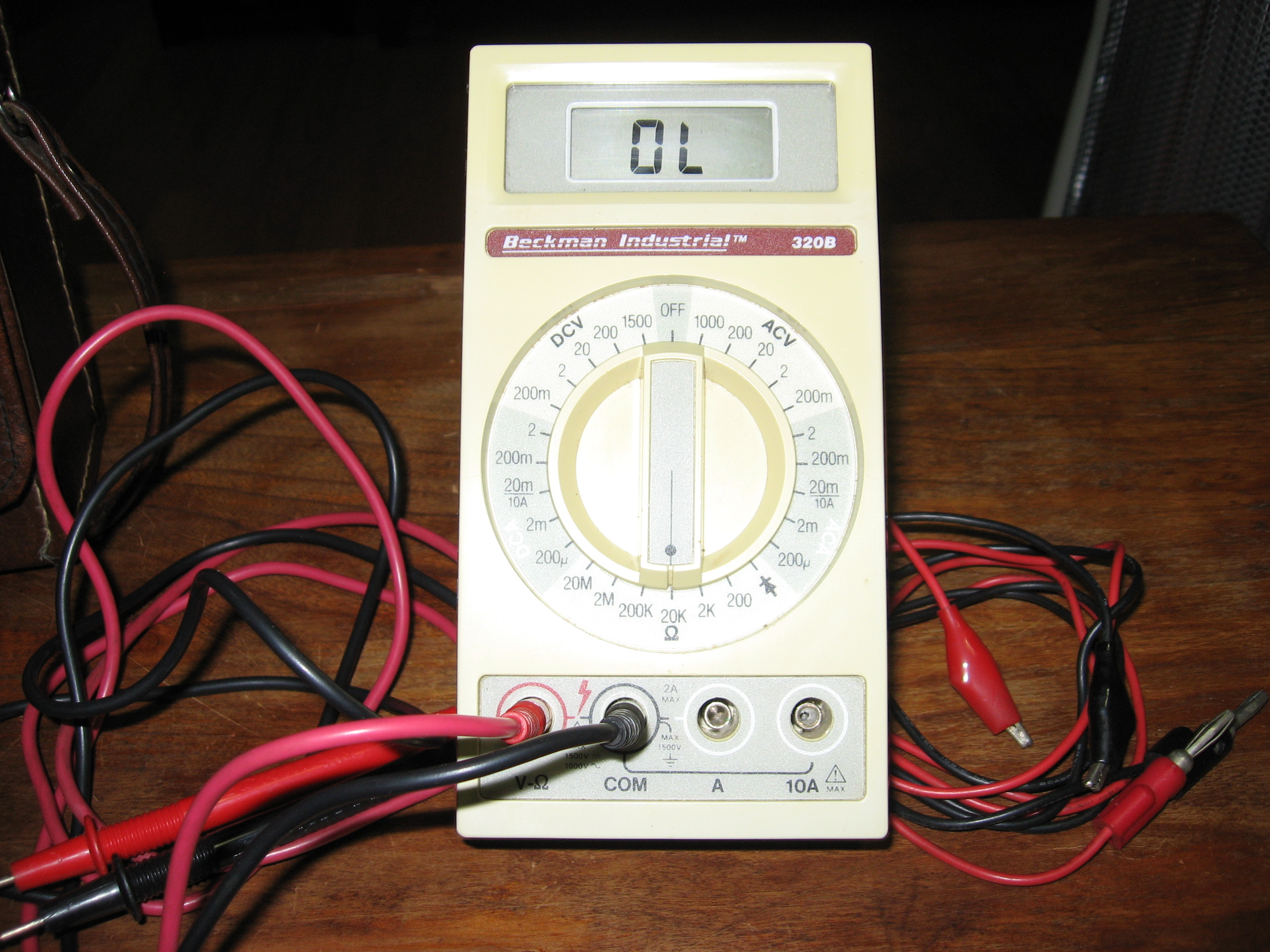

    Beckman Industrial 320B

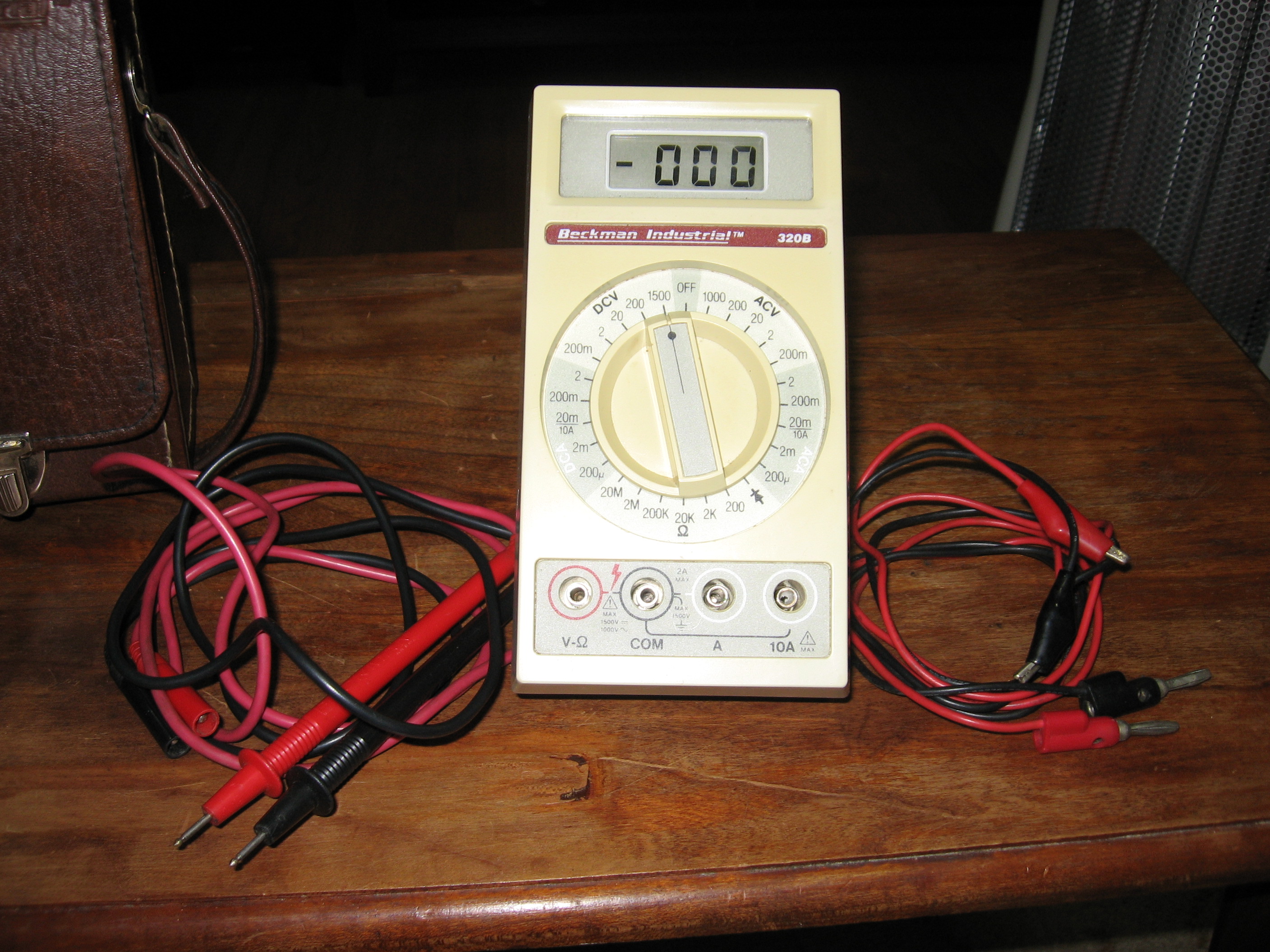

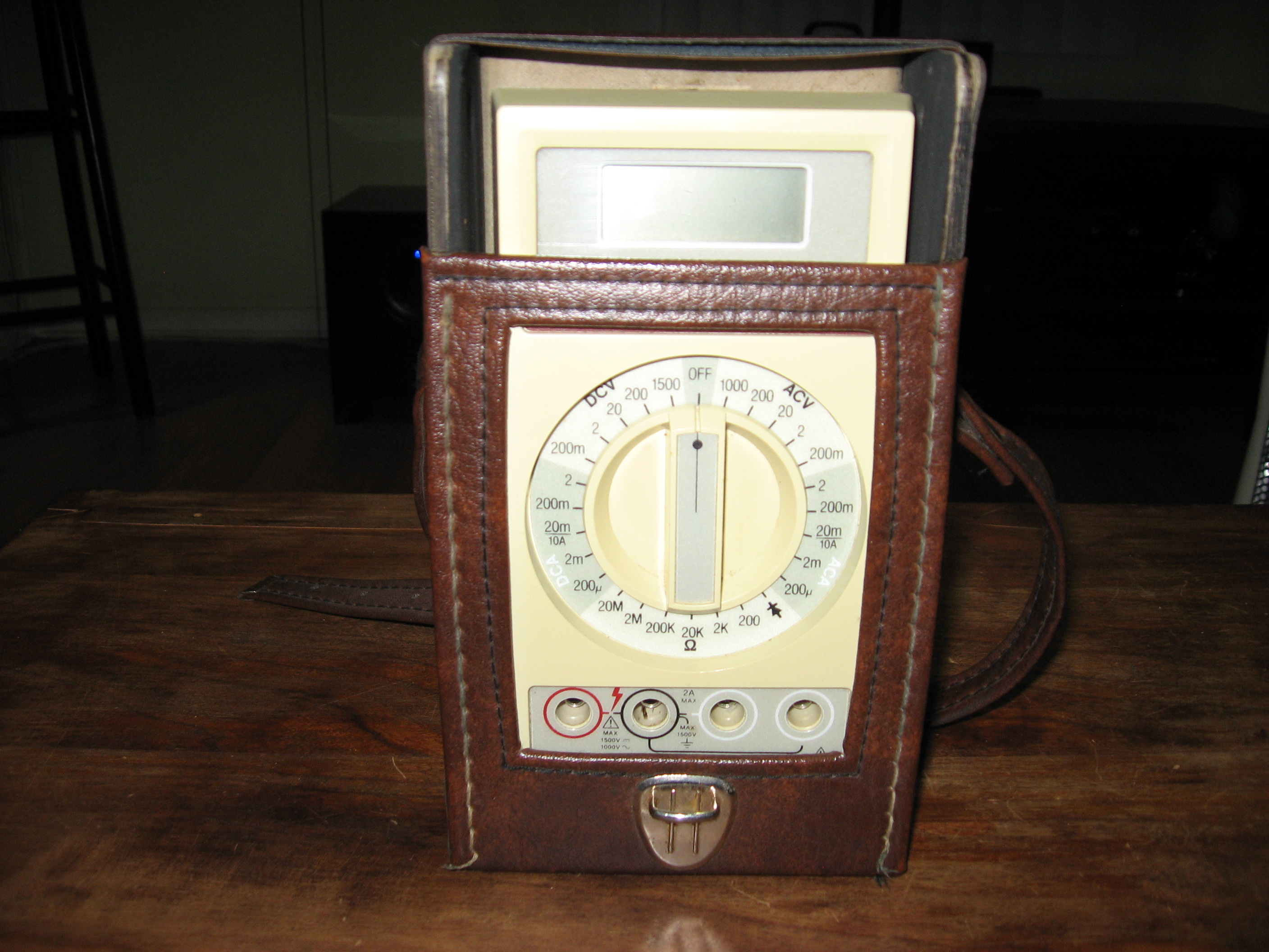

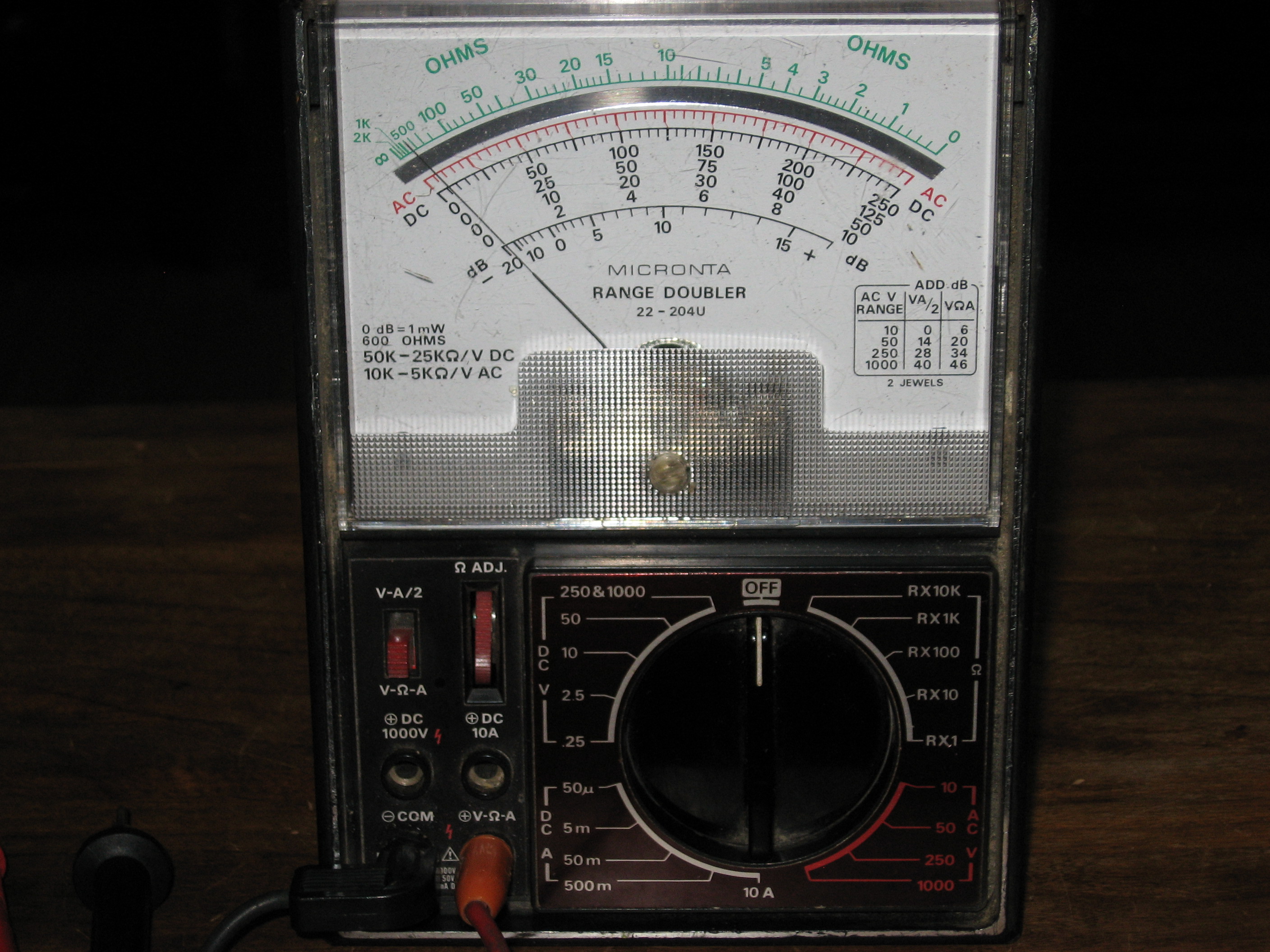

    When I started doing this about 2 years back I didn't have a meter or know how to use one. Then I got one that my Mom had when she worked for AT&T. Then I bought a cheap Cen-tech from harbor freight. This week I was given this Beckman from my step dad. Still want an auto range one. Oh well I needed a hobby.
    Thought some of you might like to see this. Also I've search and can't find a manual for it. At least not a free one.

    One retiredcaps' bonus point for pictures of the Beckman and Micronta.

        Thanks for the two links I may need them. It seemed to be working ok. But now the numbers on DCV and ACV are jumping around. Looks I'll need to open it up and check it.
            Are they jumping around when you short the probes together?
            Modemhead's advice about IPA cleaning has help me fix a few multimeters that had erratic readings.

              DCV settles down and ohms is ok. ACV doesn't stop. I'm only going to try to clean the LCD chip and check for loose parts. The basic lay out is just like the HD100. The pics Modemhead has will help.

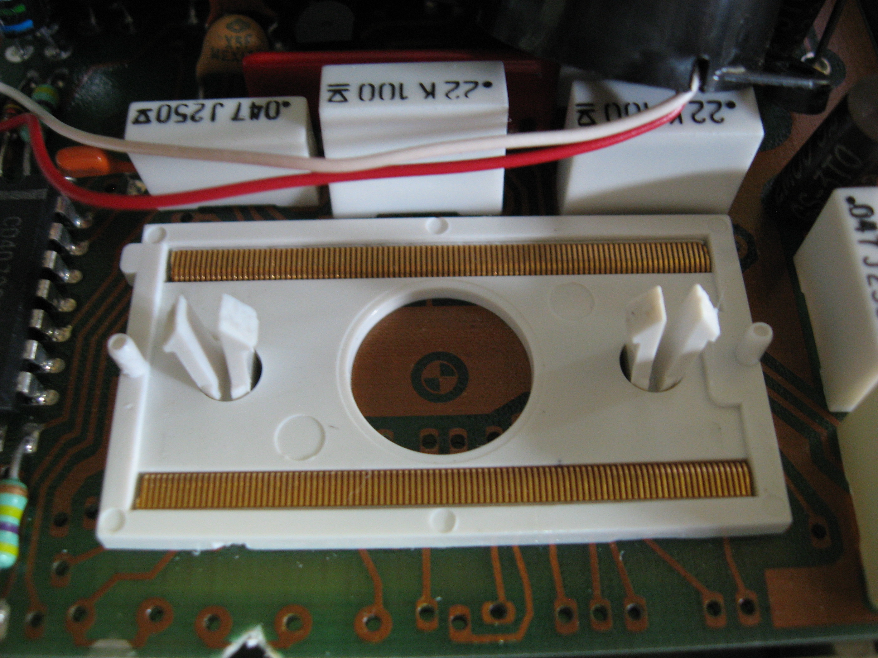

                I took it apart to clean. Now I can't seem to get the strips back in to get it to work. Any way to rehab these?

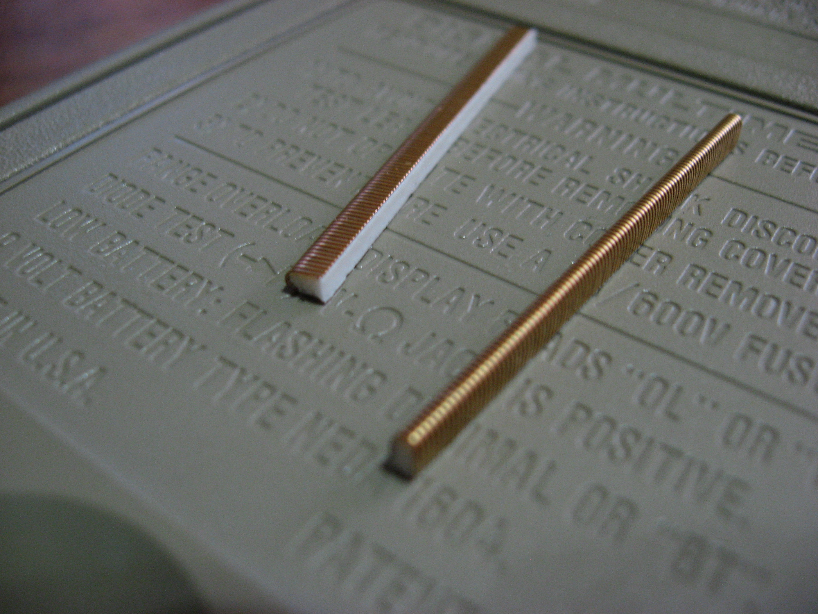

                  I own a few Beckman's and two problems they have:
                  -The rotary switch contacts - the leafs get bent or oxide on them, as they weren't gold-plated. Make sure the fingers all line up okay.
                  -The zebra-strips shrink with age, making bad connections. I've rehabilitated some by soaking them in hot water for a while and then letting them dry. It seems to rehydrate the plastic. Do not microwave them- they will blow up as they are conductive.
                  Symptoms would be a messed up decimal point, readings all over the place, won't settle down. It's been a while but I recall the zebra-strips connect the CPU and LCD, so it's more than missing segments.
                  I love these meters, they actually beat Flukes in a few ways that are important enough.
                    I don't have any Beckman's,
                    1) From your pictures it looks like the corner pins in bottom left, top left and top right strips are not "sticking out" enough. They may not be making contact with the chip on board plated pins?
                    2) Is it possible you installed the "chip on board" daughterboard upside down? I don't know if yours is keyed?
                    3) Carefully check the strip to see if there is anything lodged in between or in two pins are shorted together.

                          Readings all over the place is what I was getting. I haven't removed the switch because I can't get the nob off and I'm don't want to pry on it to much. I'll try soaking the strips and see what happens.

                            The board is keyed so I know it's in right. The strips fell out when I took the board out so I didn't know how they were in.

                              I got the LCD to work. But something isn't right. ACV isn't reading right at all. I'm thinking the contacts in the knob may need cleaned. It wouldn't hurt to change the strips either.

                                Years back, I couldn't find replacement zebra strips for Beckman multimeters. Best I could do was find an LCD zebra strip manufacturer that offered a similar size, and I could maybe request samples. But the hot water trick worked, even after years...
                                Try moving the rotary switch in-between clicks and see if you can get it to behave - which means the switch contacts are dirty or bent. The leafs are very fragile, I used a piece of paper to clean them (abrasive). Contact cleaning sprays did not last more than a few months. The PCB is gold so that part is ok.

                                        I got the strips working by bending them a little between my fingers. I guess that could cause the bad readings. I'm checking it against the cheap cen-tech. The cen-tech reads 120v +/-. Beckman reading 154v +/-. I wonder if I could find the strips in something with an older lcd in it. Maybe a radio or something, just a thought.
