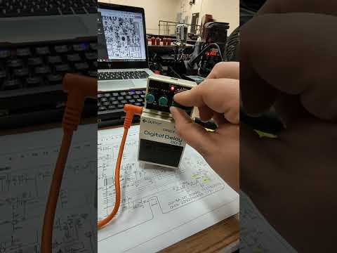

          • Unluckyfett
            Boss DD-3 (b) Problem
            by Unluckyfett
            Bypass works, direct out works. Delay signal is not right. ​​​​​Clock seems to be working. I replaced all 10uf electrolytics just because. No change. Based on sound and experience, should I be looking at the AD part or the DA part? I found a breakdown of how the microcontroller samples 12bit audio, I have a scope, I plan on doing more probing, just bothering me as I sit at home with it on my bench at work waiting to be fixed. If I'm reading correctly pin 7 on IC5 should be ≈ input signal. And pin 7 on IC8 should be delayed waveform? So if I have clean delayed waveform on IC8, the problem...
            07-23-2024, 04:33 PM
