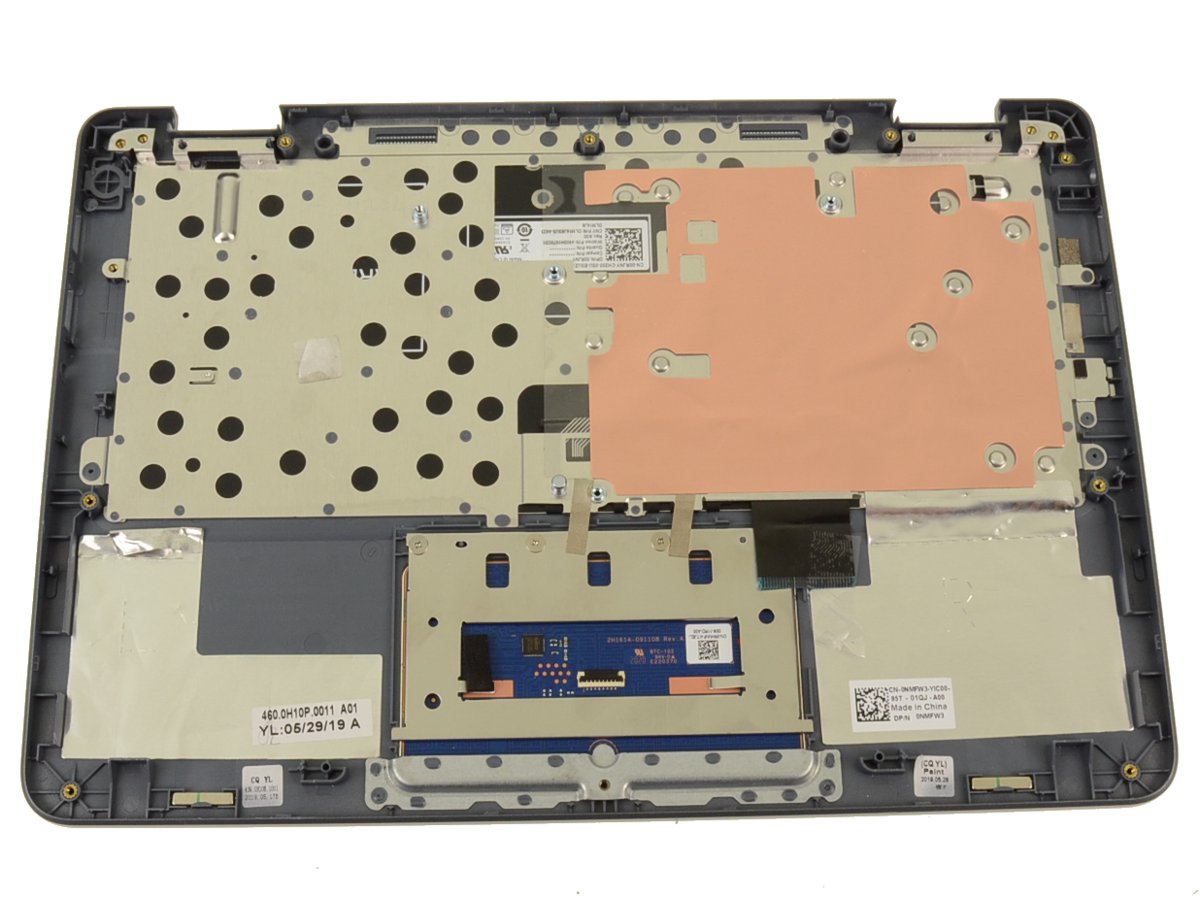

    Got it from a customer I've known for years. Said a "screw came out"
    I got it and the barrels are ripped out of the plastic on one side, one of the other side but it wasn't as bad. I say it was dropped or sat on. Still turned on. They're kind of shiesty so on top of the $36 palmrest, I talked her up to $80 for labor. She gave me the cash for it, and I ordered it.

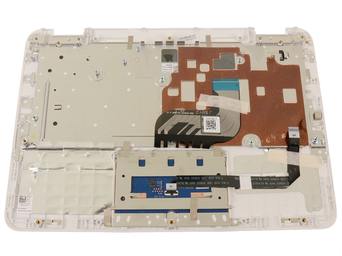

    Did not fit. It looked like it had no USB ports, like the bottom plate had the ports instead.
    Looking further, I found in the bios that it's a 3195. See how this one has the USB ports on the walls
    Searching further, I found very little. New palmrests are expensive but I found one on ebay, and it was grey. Her laptop was white. NO white ones exist. She said it was OK.
    Found a third one, which was new, I didn't see, was going to return the second one
    So yay, I was putting the motherboard in...and the FFC connector actuator broke off. Tried for two hours to pop it back in, with many little tools I have, but it broke in half. I think the exposure to heat/cold made it brittle. I used everything I could think of. strips of 3M VHB to hold the cable down a few mm from the front of the connector, with a second to try to force it down on the connectors. Pushing it down hard enough the keyboard worked for a second or two.
    I started to get stupid. I used my solder iron to pull the connector off. Looked online and found NOTHING. 30 pin connector with a 0.9MM pitch. Nothing. Tried to scratch the connections on the cable so I can solder it directly to the board. Didn't do it.
    So, used motherboard, $139.
    Going to return the first palmrest (cheapest), fucked the keyboard on the third new one. So I switched them out (pain in the ass molded plastic holders). In the end, decided just to use the second one. Something I should have done when I first did this.
