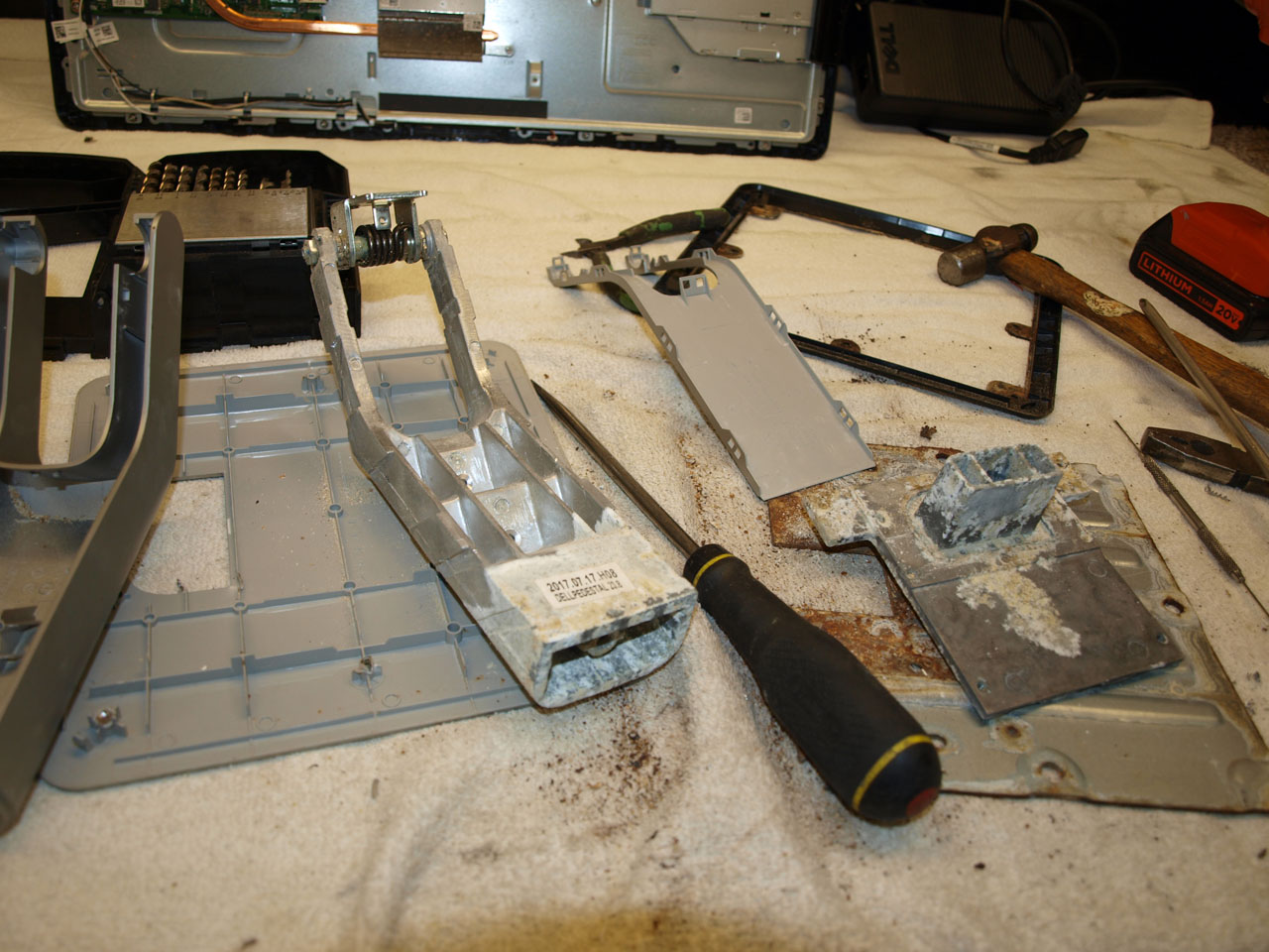

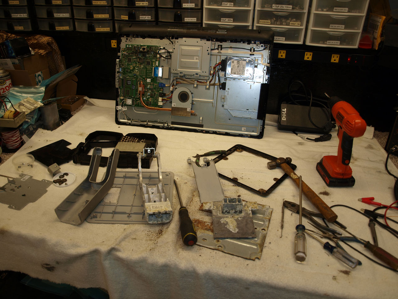

                                    Re: Topcat's Other Misc Weird Build Thread
                                    This one is a Dell 24" AIO; model 3464.... Generation 7 I3, 16gb DDR4, and a 1tb spinner. Problem is, cockroaches & animal piss (or so it smells) all over the base...
                                    This is new & large enough that it's well worth fixing...but it needs some love.
                                    Inside the canse isn't bad....openings were too small for the critters to get in.
                                    First things first, see if it even works....the brick was missing, so I used the bench supply.
                                    Success, it comes on, screen is good....and since its bitching about a non-genuine power supply, I'll ASSume the motherboard is good.
                                    Now for the worst part, the horribly corroded stand.... When I have to break out drills, prybars, hammer, and easy-outs just to get it apart; you know it's going to be bad!!
                                    Drilled out 3 screws to separate the bottom from the counterweight.
                                    The remains of the screws. Some did come out....but most didn't.
                                    Had to tap with a hammer to break the corrosion loose from the base plate and the vertical portion of the stand.
                                    ...and here we are...
                                    I'll disassemble everything and clean it. The corroded metal parts in the stand will get wire wheeled and likely painted. That will clean and then make it look good....not to mention get rid of the smell.
                                    To be continued. I did order a new & genuine Dell power brick for it for $18.00. I will also get rid of the 5400RPM HDD and replace it with a SSD. This one will sell easily for a nice profit when I'm done.
                                      Wow, that looks pretty bad. Perhaps this was in a basement or some other low area that got flooded? The "water line" on the corroded base seems to indicate so... though it could also have been a "naughty" house pet. (Cat maybe? I know that cat piss smells pretty bad and makes sense if the monitor was on a desk as most normal-size dogs wouldn't go up there to do that.)
                                      Probably is, though even with the "unknown" power adapter, you still may be able to run the Dell built-in diagnostics... or maybe not? On some of the old machines, you could, IIRC.
                                      Ouch. That's certainly going to require some deep sanding to prevent the rust from coming back - at least on the steel parts.
                                      Curious question... what kind of paint do you use for this kind of task? From my limited experience, even if the surface is well cleaned, rust will come back through whenever I used just canned spray paint from the big box stores. So as with my PacMan PC case restoration, I've turned to latex house paint, which seems to adhere better and not let rust through anymore afterwards. That case is still 100% rust free.

                                        Well, disaster struck.... I was getting close to the end of the physical refurbishing when I was wiping down the front and noticed the digitizer had cracked. There was a deep scratch out of the screen's viewing area....I guess it scored deep enough that when I applied a little pressure to clean it, it cracked.
                                        You can see the scratch with the little 'flea bite' where the crack originates.
                                        Kind of a shame......
                                        I was cruising right along before the crack....
                                        The base counterweight wire wheeled & painted with rust inhibiting paint.
                                        The rest is aluminum that was corroded. I wire wheeled it and cleaned it up. I also cleaned up the back plastics and other accessories.
                                        All that was left was the front and the system itself...
                                        ...and right after that the digitzer cracked... I looked around and they're nowhere to be found. I'm going to remove it from the bezel and see what I can do with it, just to save the system.....but there went the resale.... It'll get delegated to the garage or something....
