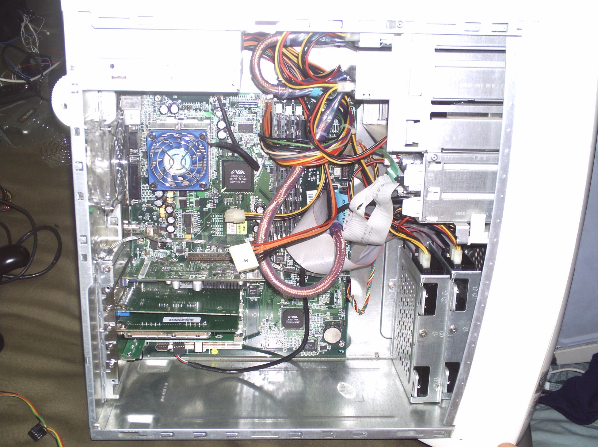

    p3 running HOT
    heres the scoop
    i have a compaq presario 7000, with a 866 p3 cuminine
    it has a ati radeon 7500 agp card
    delta 300w ps - a good one
    board had no visibly failed caps- 6 rubycon 7 nova
    graphics card and cpu hot, ps only hot near cpu (sides cool, bottom warm around the cpu)
    i have a cables unlimited 80mm fan in the back, runs
    it was sitting idle when it seemed to get hot
    about 80 degrees f in my room, may be cooler...
    would bad caps be a potential cuprit
    also, i will recap the spare board i have soon, will that fix it?

      Re: p3 running HOT
      okay i have a picture (attached, sould someone tell me how to make them appear in the post itself)
      also, i am running ubuntu 9.04 on it.
      would a downgrade to nvidia riva tnt2 help any
      my existing card has one of those sacons that look like polys on it, not failed

        Re: p3 running HOT
        How hot are we talking about? Have you used any software to check any of the temperatures?
        You can use HD Tune to check hard drive temperature and PCWizard, Sandra, and a few more to check CPU/motherboard temperature (if your motherboard has sensors of course).
        Also, does the video card have a fan? Are the PSU caps ok and do the caps near CPU get hot? What about the Sacons - are they getting hot too?

          Re: p3 running HOT
          There is one version of 866 that is 29W. Which voltage one is yours? 1.65V to 1.75V?
          And confirm you are at correct voltage.
          Intel released 5 types of 866, mostly 22W, one 26W and one 29W. All these three with this type of heatsink is barely enough. Look for a socket 462 athlon heatsink and install it. A good heatsink have copper base (preferred) and wide fin spacing. Not the stamped and glued fins onto a base.
          Second, hard drives in that position is POOR for air flow. You will need to get good case and NOT flimsy!, this good cases that will mount the hard drives horizontal and have cooling holes in front of them and let case pressure draw air in.
          Another option is strip down case and drill bunch of holes thru the bottom case where hard drives are sitting on in a matrix of small holes (say 1/8") and install thicker feet to keep air space under the case so air will flow and go through the hard drive and out via fans at back.
          Other than that what you have done is good.

            Re: p3 running HOT
            mine is huge
            it is this one
            http://masscool.com/product_detail.php?pid=153&id=19
            im not overclocking it so this one should be adequate
            oh, no cpu temp sensor, it seemed to be running slow, i felt hot air coming out of the fan, and thats what i found, hot stuff
            it usually doesnt get that hot...
            edit: i removed the pre-applicated grease and regreased it myself, very small amt- maybe the size of a small zip tie head (4mm), 2mm high

              Re: p3 running HOT
              oh, it is set on the carpet floor of my room, desk has no spot for it
              would removing a hd help? the 320 is not in use
              and the pinouts for the front usb is really odd, i dont know what they are (i think they are the same as the FIC az31 because p. 7000=5000=az31) they are goofy and most cases wont fit it,
              i cant change cases because of that and a new case is too expensive
              and i dont want to mod it,

                      Re: p3 running HOT
                      That heatsink still isn't very big.
                      http://www.newegg.com/Product/Produc...82E16835200017
                      That would keep your cpu pretty cool, probably a little overkill, but its either too small or this.
                      Also, the heatsink on the GPU is pretty small. A small fanless heatsink like that needs to be upgraded or have a fan put on it.

                              Re: p3 running HOT
                              That CPU heatsink should be fine, even at 80F. Specs say it can handle an Athlon XP 2100+ which has ~65 watts TDP. Just make sure your fan is running good.
                              Again, how hot are we talking about here? Hot so that you can't touch the heatsink or just warm? Have you tried running HD Tune yet to see how hot your hard drives are getting? If not above 40C, you should be good (mine always run around 40C when it's ~80F in the house).
                              Also if you have a small fan around somewhere, add it to the video card heatsink like 370forlife said. Run it at either 5v or 7v if you want to keep noise down.

                                      Re: p3 running HOT
                                      OK, several things.
                                      Have you changed anything? Hardware? Software?
                                      You said it was idle, did you check in the task manager to confirm that, or were you just not doing anything on it? Could be you have a parasite that's bumping up your CPU cycles, might be malicious, might not. Check task manager to confirm that your System Idle Process is using 90 plus percent of the CPU.
                                      [EDIT : Ok ignore all that, you're ubuntu]
                                      It's already been mentioned that the HDD placement is severely suboptimal, if you can't change that, then remove the extra drive, and the associated bracket, having them sit that close can lead to massive heat.
                                      What is the orientation of the case fan? With the CPU fan in that orientation, I'd have it blowing in, but optimally, I'd reverse the CPU fan and have it drawing air up through the heatsink and pushing it to the case fan, which would then blow it out of the case, make sure your PSU fan is also exhausting.
