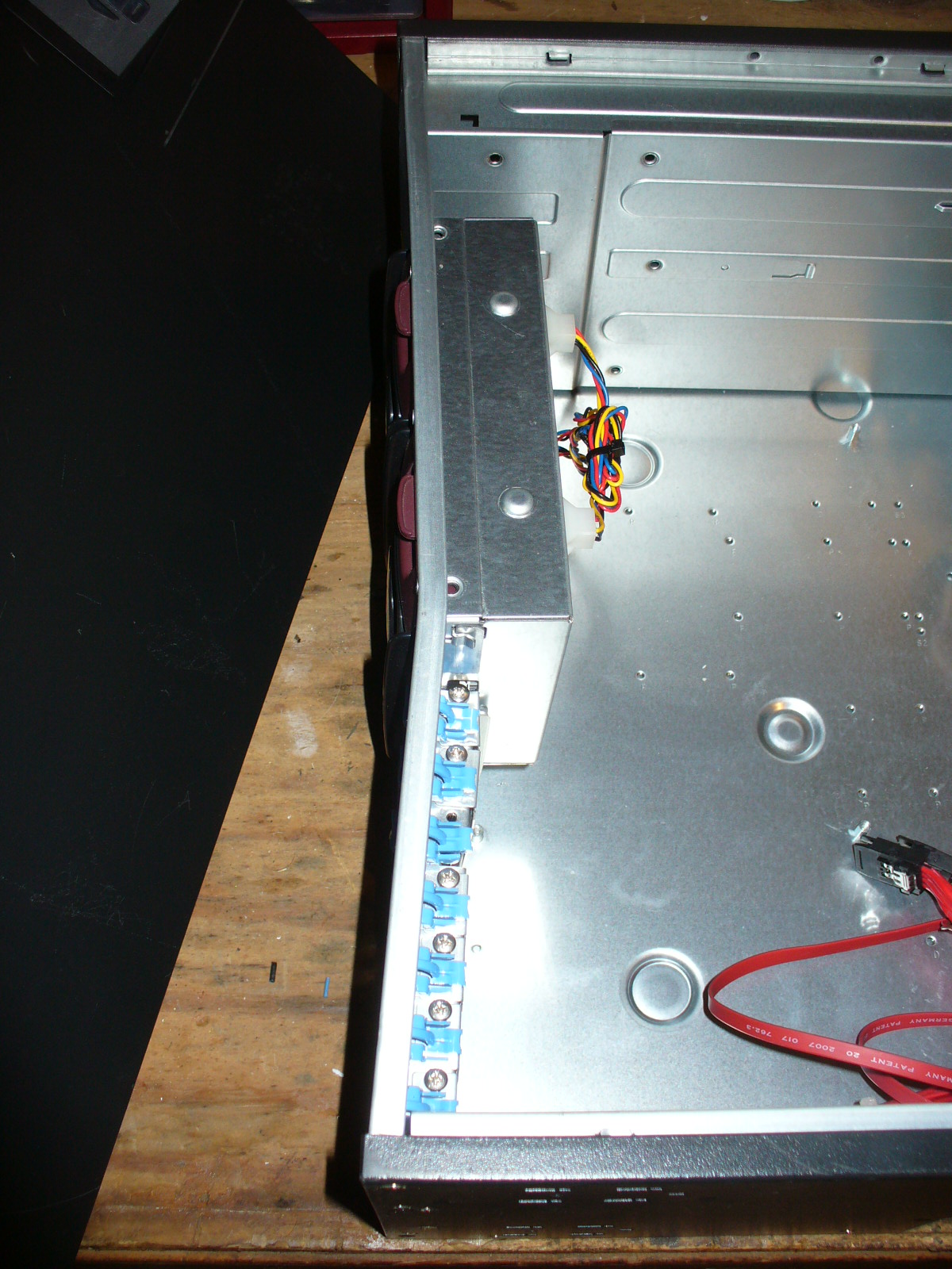

          A bunch of parts have come in... and I've gotten a lot of the build done.
          Anyway, I have pics but it's late and I'm sore and tired (had a nasty car wreck last night... I was literally hit by a truck ), so I'll keep this short (will post a proper pictorial tomorrow).
          Good news: It runs... sort of. POSTs but no graphics on either slot. I think my testing card (one of the GeForce 8600's from a prior build) is fried. The gLAN does work too... And since everything else on the PCIe bus seems to work, (and the fact I faintly remembering the card having some issue the last time I used it), I'm pretty sure the card is the issue. I'll have to steal a card from something or borrow/buy one of my co-worker's "old" cards he has sitting.
          Also, the case had a freebie in it:
          No idea if it works and what condition it's in (had a fun time removing it, see below), but I'll take it!
          Bad news: This has been a bad shipping method and damaged item nightmare... To start, jackass #1 shipped the motherboard in loose packing peanuts/Styrofoam with no AS bag:
          The fact that it works at all is a miracle... the peanuts are static-heavy as you might be able to see. What a f*cking idiot. And no, they didn't include the I/O shield (but it wasn't pictured or in the listing), so I guess I'm back to owing Topcat favors (if I wasn't already) .
          Then, the case had some issues to say the least. First, the back of it was dented pretty bad:
          As will be shown in the pictorial, I was able to fix it w/o too much trouble.
          Next, jackass #2 (whoever build the system) used a Molex to SATA adapter that was a cheap POS and fell apart in my hand:
          It wasn't needed, luckily.
          I don't have pictures (that turned out), but they also shoved some of the wiring and an unused PATA cable between the 5.25" bay sleeve and the case frame... was a PITA to pull apart, and they squashed and chafed a couple wires, which I had to tape back up (too thin for the heat shrink I have at the moment).
          Going back the the 500GB WD Caviar Black, they installed the damn thing with M3 (Optical/floppy) screws, not the proper #6 screws:
          Spin, spin, spin... I eventually got the screws to release the drive.
          Finally, I discovered that Jackass #3 (Whoever gutted the case out) must have been on a yanking mission... as the connector shell from the original motherboard was still on the PSU backplane cable:
          Doesn't affect me any, but sucks for whoever ended up with the original board.
          One other thing: the USB 3.0 card I ordered had an renesas (NEC) chipset shown in the picture (but not called out in the listing), but had a VLI chip on the actual card received:
          This seems to be the chip used on a lot of the cheapass cards... are they any good? Or do I need to get a verified renesas chipped card?
          Finally, one other oops: the air dam fits the case but not my coolers... this one is a lot lower in the middle and while better for RAM cooling, isn't so great for fanned 2U coolers. Guess I'll need to hunt down a newer adjustable dam like was in the first build.
          Anyway, more pictures coming soon. Yawn... Ouch. Getting in car wrecks doesn't feel good, even after pain meds

                    • ratdude747
                      Black Sheep
                      • Nov 2008
                      • 17136
                      Re: Ratdude's Main Rig V5.6
                      Picture time... with updates from today (it's good news!)
                      Unboxed the case... and removed the (not pictured) Ablecom PWS-801-1R PSUs... since they're Ablecom branded with no 80+ tag (not Supermicro with an 80+ rating of some sort), I assume they are old screamers... No thanks. I have something more suitable (we'll get to that in a bit).
                      Pictures:
                      About that missing top- that's a cosmetic thing. I may make a wood top for it or something (main rig 4.1's is busted too, they are a bit flimsy). Ideas are welcome.
                      The backplane is indeed SAS (backwards compatible with SATA):
                      Anyway, another view of the dented back panel:
                      In that position, I used a big flatblade screwdriver and a 4lb drilling hammer to straighten her out. End result:
                      Time to start tearing her down. Oh look, a SATA DVD-ROM drive:
                      I didn't know SATA drives that weren't burners were a thing. Must be a server specific item.
                      Compared to the other cases I've torn down, it looks like SM did something to combat front panel cables popping loose:
                      Don't worry, I used the zip-tie cleat to re-secure the USB and beeper wires... when they come unplugged up there, they can be a b*tch to reconnect.
                      Here's my latest $30 score:
                      Normally those are $50 a pop. Got this one for far less.. it's supposedly used but came in the box still in bag and the cables and the like still sealed. Heck yeah!
                      Life is too short for cheap crappy SATA power adapters:
                      5.25" drives installed:
                      At this point I decided to try to test fit the air duct:
                      Yup, it fits. No worries here
                      Motherboard transplant time. Here's the before: (dead board on the left, new board on the right):
                      (I did clean the bench after the photoshoot )
                      And after:
                      Shoehorned the board in (the SAS cables make it a PITA, just like last time):
                      Installed the SAS card and tied up the SAS/SATA cables. Seems a bit excessive, but it was included:
                      I may swap to shorter SAS and SATA cables later. Not digging having a coke bottle of cable shoved in there.
                      Went to fit the air duct and... *sad trombone* :
                      As mentioned in the last post, the correct part is on order.
                      Spare 920W "Quiet" PSU going in:
                      I'd like to eventually swap the the lastest 920W SM offers which is quieter yet... but the money isn't there at $100 or so a pop.
                      USB 3.0 card and cables installed:
                      Powered it up, BEEEEEP BEEP BEEP! GPU not detected. Swapped the slots, same thing. I ended up pulling the 9800GT out of 4.1 to test it, and bingo:
                      I'm running it with the fans on full blast and the cover on to ensure I don't slow cook the memory. As of this writing it passed the test. Yay!
                      Now I just need a proper GPU, SAS drives, and that bleeping air duct. Maybe a better USB 3.0 card too (I'm reading the VLI chips are OK, and no more).
                      What do you all think?
