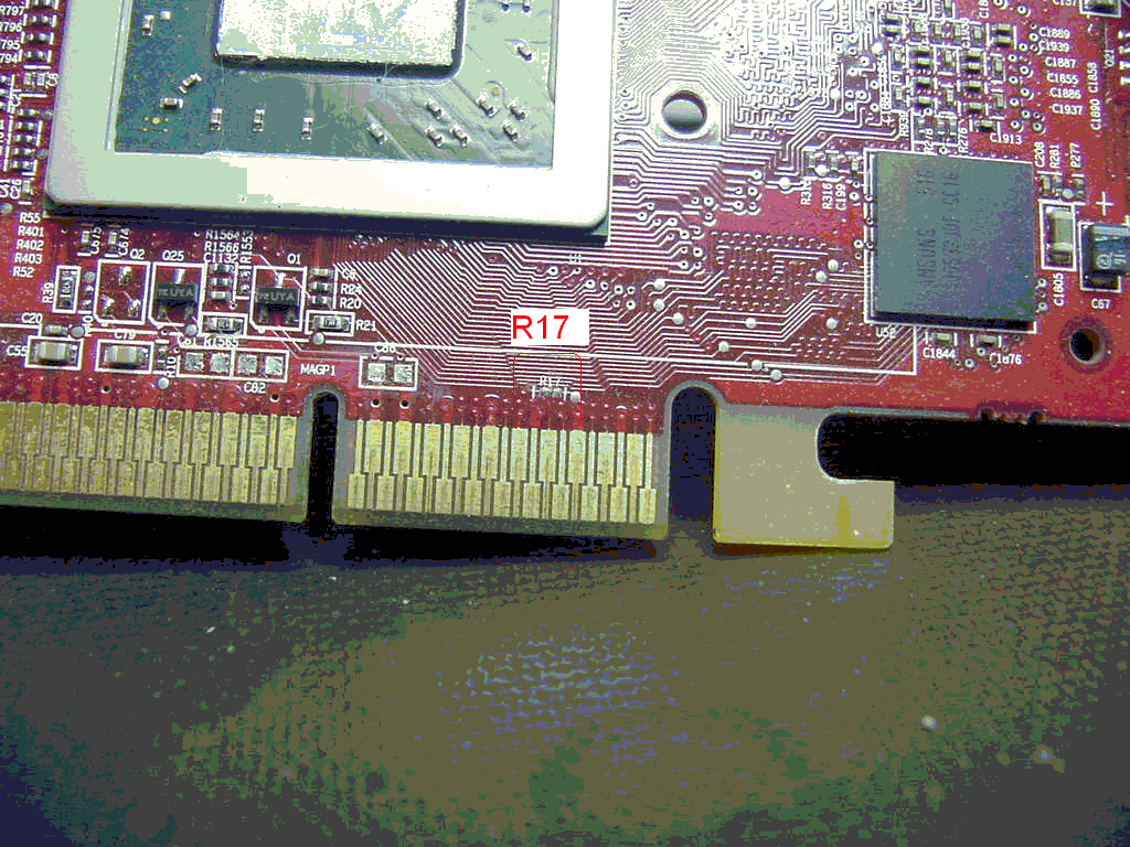

    i sure could use some help on R17 value located fan side above gold finger 8

    Hi HenryJ,
    Is the resistor damaged or missing? Or, you don't know how to get the value?
    Can you post a pic of the problem part or area?

      Received this missing along with C81 C82 so no pic or code to crack.

        Longtime comming on that pic Toast but with the help of plain Bill i'm able to post pic this time so here you go

          Without a reference X850 Pro card, there is no way to get that resistor value. If I had to -guess-, I would use the same value as R16 on the back side.
          Same goes for the 3 missing caps C81,82,86. Those caps are decoupling caps to keep noise off the lines. You could take one off the reverse and measure it to get a value.
          That resistor is extremely small. Trying to replace it is going to be very tricky at best as it's 2 x 1mm. The surface tension from the solder alone will drag it off the pads. Those are placed with a solder paste/glue that is cured then heated in a -very- precisely controlled environment to get the solder to flow. Be aware that heating and soldering on one side may cause you to lose components on the other. A too high wattage iron may destroy the traces and pads.
          Plus, you'll need a very good magnifier and a super steady hand. Get extras of each as you're gonna lose one...

            I have done it, need a needle tweezer to hold it down while soldering.
