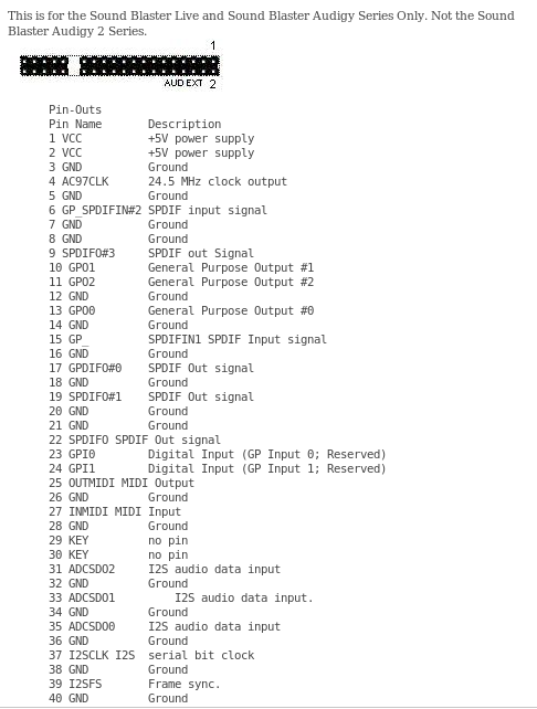

    Ever since I got my system setup I have never got the Live! drive IR to work with my Live! 5.1 card. I have the ribbon cable connected between the components and the drive has power but nothing on it works. When I got the system I had to manually download the drivers for the card but I don't know about the drive. I assumed it would work as soon as the sound card had it's drivers. Does the Live! Drive IR need it's own drivers? I really want to hook my headset up to the front and not have to crawl round back of the system.

            Okay the card model is SB0060 and the model of the drive is SB0010D
            Since I lack and documents I just guessed where the ribbon cable would plug in.
            I plugged into the pins marked "AUD_EXT(To SB LIVE!CARD)
            Ther was a second socket the same size marked "Digital I/O Card" as well as another marked "AUD_EXT_2", "DIGITAL DIN" which were different sizes and there was one jumper block I did not dare touch.

              I did some more searching and found this.
              http://www.digit-life.com/articles/s...m51/index.html
              I think that referring to a manual would be nice but I can't find one in PDF form anywhere.

                What is the CT# on the card? Not all versions of the card could simply be connected to a Live! Drive and just go. It was enabled or disabled by hardware configurations on the card. IIRC, this is something which is easily gotten around with the kX Project drivers, but otherwise you have to do some soldering to enable it due to CLI's skull-duggery keeping you from using the full functionality of your Live! card.
                Edit: Here ya go!
                http://web.telia.com/~u91003452/live...ifications.htm

                  nah... all 10k1 based cards should work out of the box with the LiveDrive (as long as they have the connector), if I remember correctly (so far, my LiveDrive II worked with CT4760, CT4830 and CT4870).
                  the Audigy series are a different thing though as they expect 24bit I/O, you have to solder a completely different ribbon cable and at least one ADC for Mic/LineIn2 has to be changed on the Drive.
                  EDIT: didn't see your link. i thought the value editions didn't have the full connectors (either SPDIF only or none at all).
                  hm...re-read it....this is for using a MOC with E-mu drivers on a Creative card. pin 23 and 24 should be set to high by the LD itself, anyway (which is not the case with the MOC).
                  SO... i think it should work without soldering at all as the SB0060 is a normal Live!5.1 Digital (right?)... I rather guess it's got something to do with a bad connection and/or the drivers.

                          The Edrive was the breakout box for the APS. Basically, it's the same thing as a LiveDrive.
                          See, in order to enable the Drive driver-wise, the soundblaster's GPI0 and GPI1 have to be connected. A normal LiveDrive does that, anyway (except there's something wrong with the cable). The Edrive doesn't, that's why you have to do it by hand.

                                  It looks like the reason it won't work is because Creative did the sneaky task of making a regular ribbon cable proprietary. That ribbon cable is not directly wired and requires modifications apparently so I can get the drive to work.
                                  After some work I was able to find the pinout for the sound card however I was still unable to find the pinout for the Live! Drive so in order for me to rewire the ribbon cable I have, I need to find the pinout for the SB0010D Live! Drive IR breakout panel and I should be able to carry on from there.
                                  Anyone know where THAT pinout can be found?
