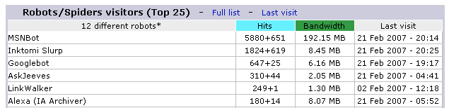

    i was checking stats and....huh? msnbot is making big transfer for a bot. so i guessed that windows live must have image search? yup it does

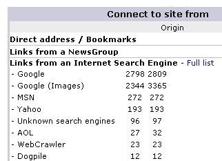

    How much bigger is google than msn on bringing traffic. er....like 10 times. yahoo is pretty crap also.
    ....and Google images brings in my case like an equal amount of traffic as google search...therefore its equally important to me.

    My web server is attached to a 384/kb uplink speed, and the bots were clogging my bandwidth.
    I had to modify my robots.txt file to exclude my library from bot searches. It doesn't get into the search engines, but I got my bandwidth back.

      What's up with that MSN crap, can't we just force the MSN bot to not search the site?
      That's way way more traffic than acceptable!
      (we of course want the google bot to continue indexing)
